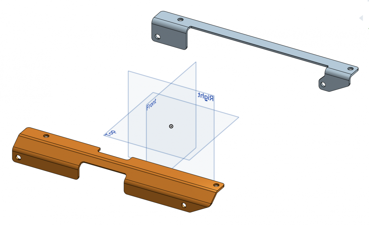

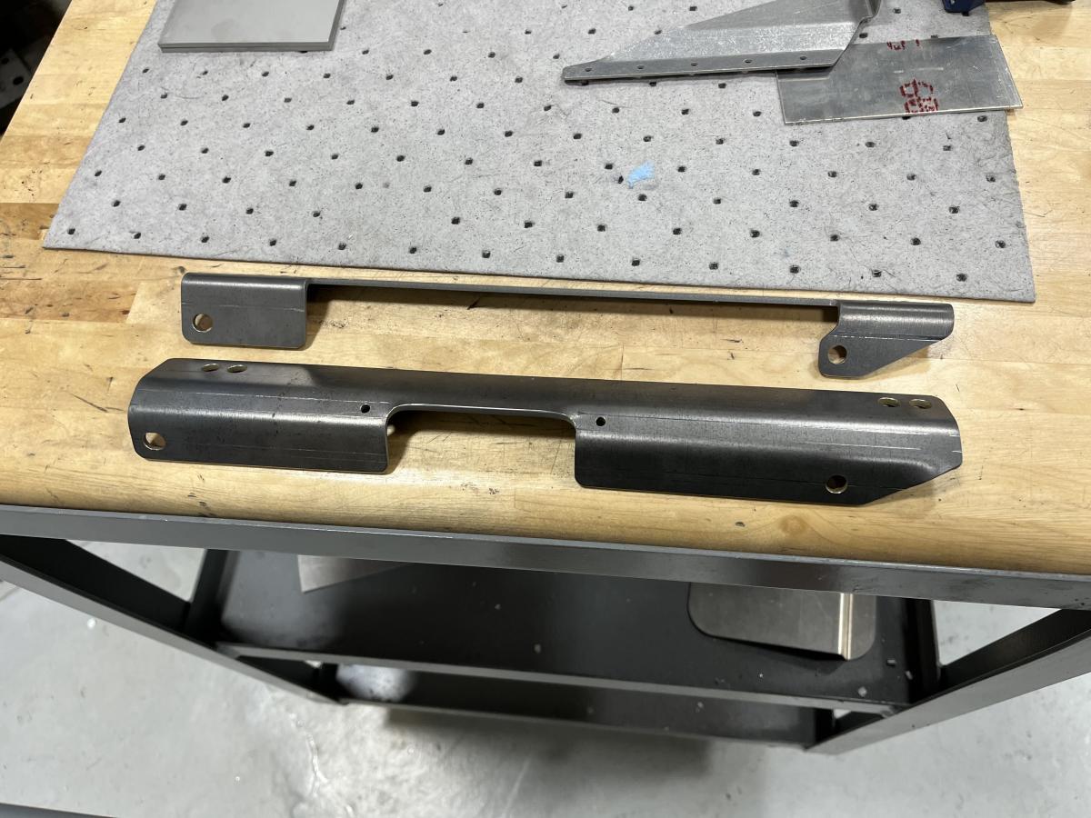

    Custom brackets are coming together, currently the final version is out for powder coat. Updates here: https://nam3forum.com/forums/forum/m...lack-tan-332it
    v1:

    v2:

    Fantastic Bry5on. Since you're the same exact size as me and I plan on moving towards the CS shortly, I'll be utilizing this custom bracket if/when you make it available! Great work man.
