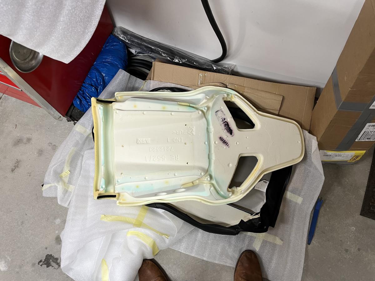

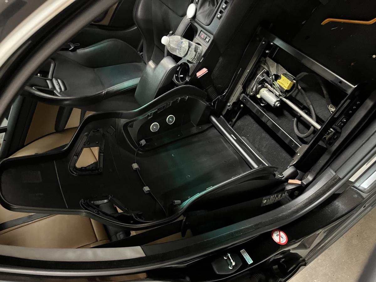

                            Does anyone know of a good guide to disassemble these seats? I've got a clients car here with Sportsters and the tilt feature is not working, looks like a cable came unclipped somewhere. I'm reluctant to start prying on plastic without knowing the repercussions on a clients car, lol.
                            Thanks, George
                            Email to [email protected]
                              Thanks, George
                              Basically you pull the covers off and most is revealed. I’m not sure about the seat retract, but here’s a photo with the foam removed where you can see the cable routing (foam just sits in place after the covers come off).
                              1) unbolt 4 Allen fasteners to remove seat bottom
                              2) remove trims and pry away seat back cover (see video https://youtu.be/DNThViXutg4)
                              3) lift off foam
                              ​ Click image for larger version  Name:	FC6F2F29-9430-480C-93D2-3170BBB013C1.jpg Views:	0 Size:	122.2 KB ID:	198867 Click image for larger version  Name:	8C6B72B9-9328-4442-A661-294649890AE3.jpg Views:	0 Size:	134.8 KB ID:	198868
