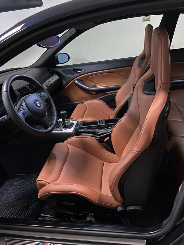

            Originally posted by zaharias View Post
            Wow! Perfect interior…maybe i missed it earlier in the thread but did you order them in that colour or have them recovered?? If they’re recovered, where’d you source the leather from?
              #81
              thanks
              Retrimed here in Greece.
              Found same leather as oem.
                #82
                thanks
                Hard to tell from a photo but looks like they got it pretty good. Rarely does a full retrimmed seat look right, but yours do.

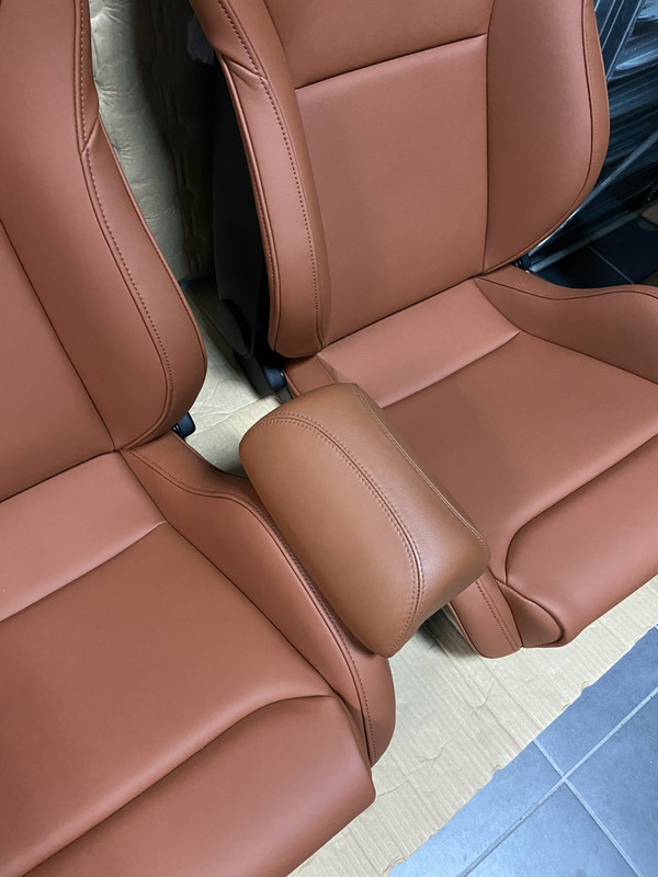

                    I send him the rear middle headrest and found the same leather in a shop in Athens.
                    see here the color match
                      #85
