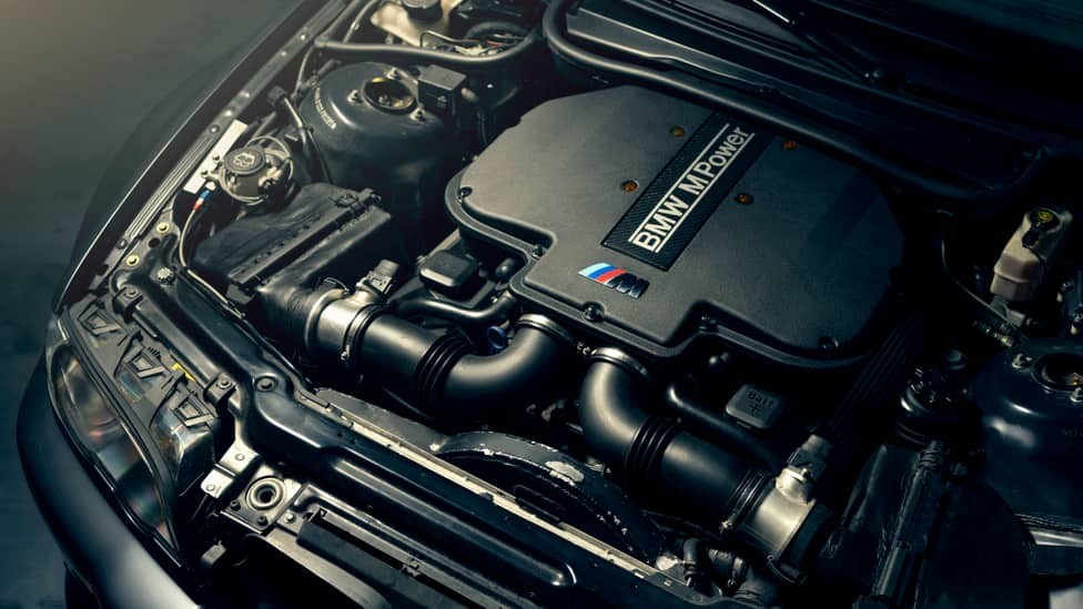

                        I'm building an E39 S62 touring right now. The biggest problem with S62 swaps in an E46 is they don't clear the brake booster. I haven't seen anyone do them without a pedal box... so that in my mind is a non starter for a street car conversion.
                        *Edit, besides S62s aren't cheap either. Other than the potential for electronics integration being easier I'm not sure its a better option than an S65/85 especially considering cost.
                        BMW did it somehow.

                          The upside over LS is cluster, cruise control, idiot lights, HVAC, etc functioning.
                          I believe CANTrolls has all of that working with their interface box.
                          BMW did it somehow.
                          Looks like a MK20 car.
                          Do you have anymore info on this setup, would love to see it.
