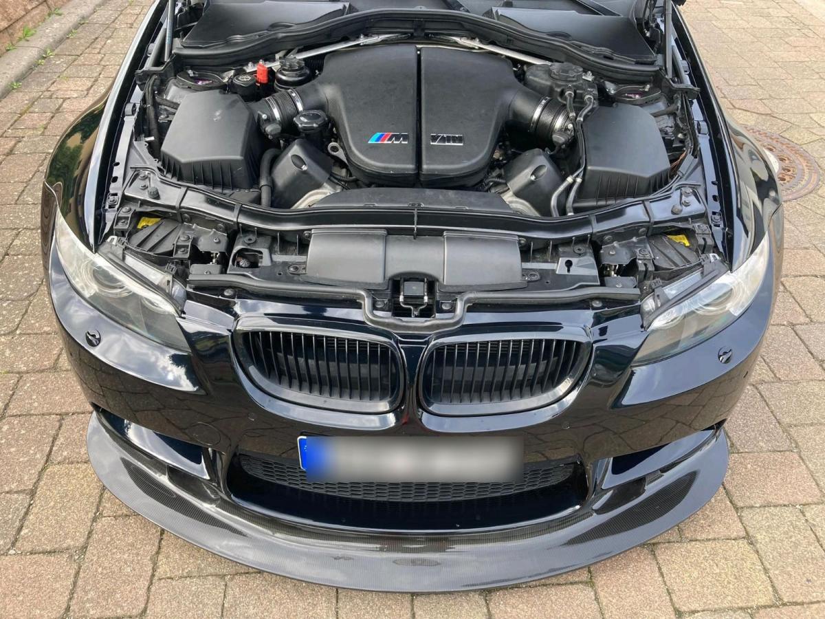

          Now back to the main topic, people are quick to say swap s65/s85 in an e46. Goodbye to chassis/vehicle dynamics as you will always have to comprimise fo
          Tires,Brakes,suspension etc. The s54 is perfect for the E46. it just need less weight.
          If money wasn't an issue and i have to stick to an e46 chassis, full carbon chassis with a stock CSL Power level 360PS.
          Perfect chassis for an S85 will be any of the E8x/E9x chassis not an e46.

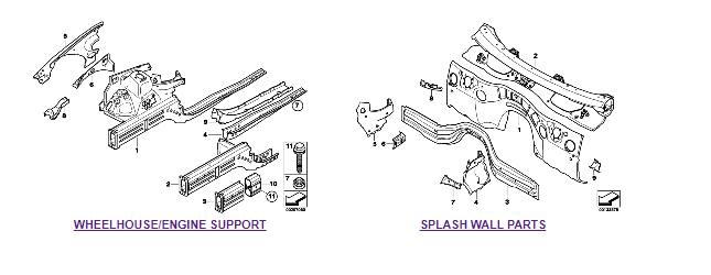

                    Originally posted by 01SG View Post
                    I stand corrected. That's pretty awesome. How do these swaps complicate routine maintenance though? Jay Leno had a 1-series with a s65 swap on. The guy said he had to drop the front sub-frame just to change the plugs.
                    e82 is so similar to e92, that even front turrets, front frame rails etc, has the same part numbers (its a one car with 2 length options and different exterior design). two chassis differs in the rear passenger floor - e82 shorter on 10cm.
                    we have swapped 2 cars and this swap goes like oem.
                    more interesting facts:
                    e92 m3 front subframe has 8 mounting points over any usual non M subframe with 6 mounting points. so zero e82 cars with 8 point subframe from factory. and you can take m3 subframe and simply install it on e82 chassis, cause it has those 2 additional threads already, on all chassis.
                    you can even take stainless steel fuel line from e92 m3 and fit it to e82 chassis - you only need to cut and weld it under the rear passenger floor.
                    so nice story about plugs change .
