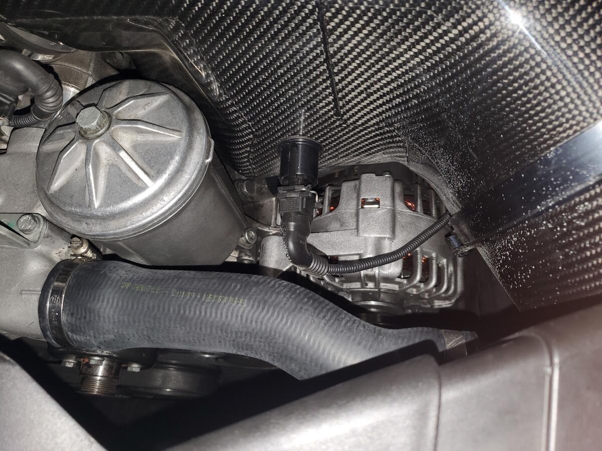

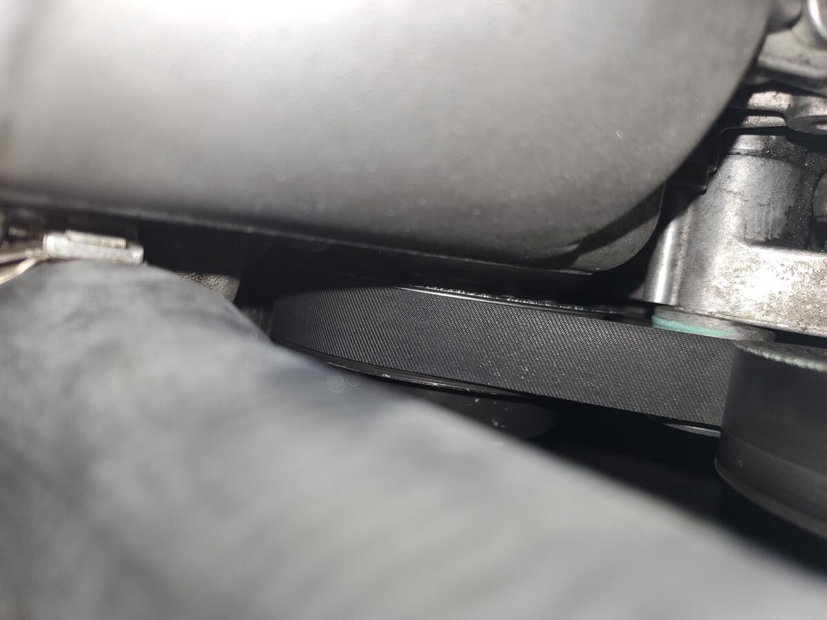

                  Nevermind, looks like my Geba pump is failing. Shitty pics, but it was dark.
                  Note the blue spray on the airbox, idler pulley, and IAT sensor.
                  Click image for larger version  Name:	20200717_234437.jpg Views:	0 Size:	178.6 KB ID:	43651
                  Click image for larger version  Name:	20200717_234512.jpg Views:	0 Size:	77.5 KB ID:	43652
                  Opened up my engine bay to find a spray of what appears to be coolant on the things around the water pump pulley (and on the inside of the pulley too, which is what I was trying to capture in the second pic). Coolant level hasn't dropped appreciably, but it definitely looks like a leak from the pump bearing.
                  I did take off the belt to check the pump for play and it was minimal. If I had to guess I would say it had about 1-2 mm of play. I cleaned everything up and will monitor over the next few days to see if the leak continues.
                        Sorry to hear that man, but thanks for the heads up. It sounds like OE is worth the extra money.
                            Yeah definitely.
                            Drove my car around like that for a couple months and the leak didn't get any worse though (although I was only driving about 40 mi a week). So at least it wasn't a catastrophic failure.
                            New OE pump is doing great, but it's only been on the car for a few weeks.
