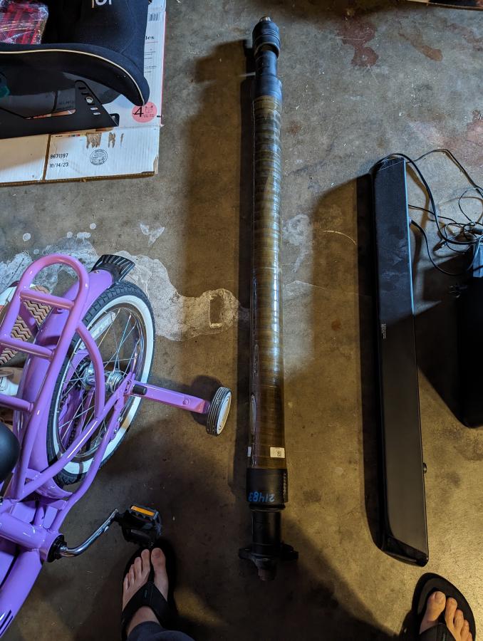

      Just picked up a drive shaft too to see how this is done. Have a local shop that wants to see it recommended by my shop that I trust. Worst case scenario I'll just sell the shaft to one of you to do this if I can't find a shop willing to. Got it for $200.
ID:	255799hhere we go!

            Which shop? I’m in NorCal too and about to submit the parts sheet and measurements from the picture here to JRL Machine & Driveline in Petaluma. Would love to hear some results as well.
                You mean the sheet that said 53.875 total length and 3.250 from one flange point to the other?
                Oh I just realized it has the part numbers for the parts used too. Shoot I'll just bring it there on Monday and see what they say.
                I'll let you know the shop if they said they can do it.
