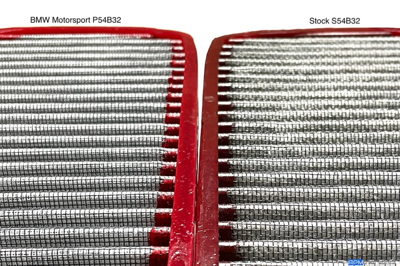

                      Additional info on filters. There are P54 version of CSL filter with less filter material, part number 11618299563Click image for larger version  Name:	image.png Views:	0 Size:	914.1 KB ID:	255392​

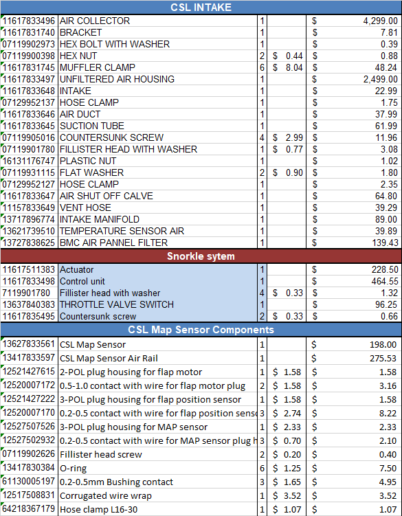

                            There is more to the intake than just the box if going for a "OE" setup. Also not sure if this was ever figure out but if not running cams, there was some odd idle drop issues with stock cams. Sorry not following forms like in the old days.
                            Parts are what is needed for the "full change" but prices are NOT right as that is when I ordered.
                            Click image for larger version  Name:	image.png Views:	0 Size:	73.9 KB ID:	256037​
