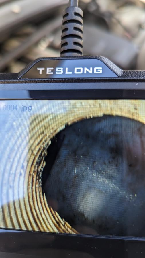

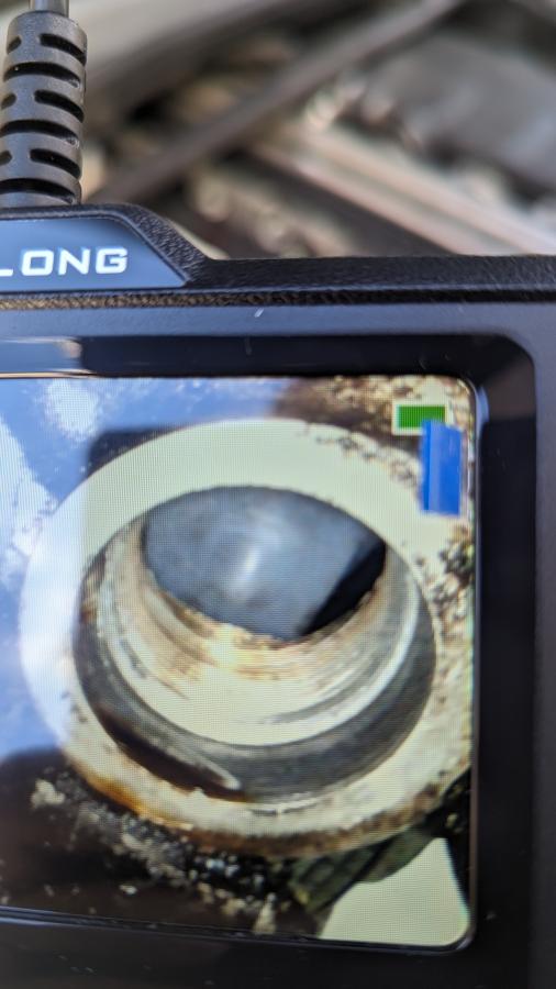

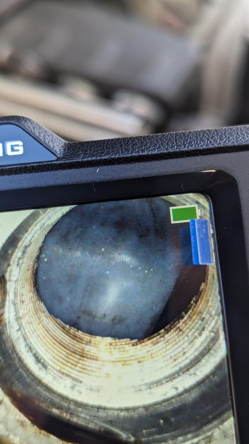

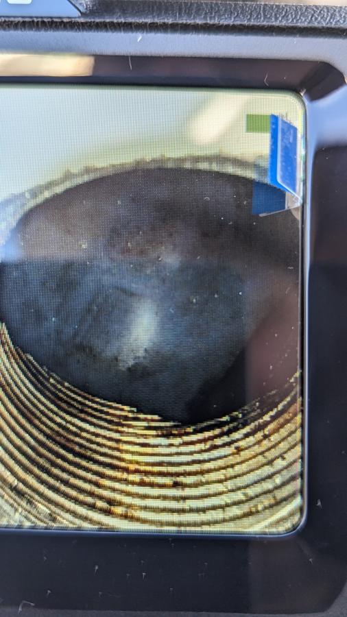

    Thanks, here is a pic of the chain tensioner hole.
      #32
      The threaded hole still has plenty good threads.
      It's safer to chase the threads from inside to outside, but you also can do this from outside by using a guide -- something with the inner diameter same as the tap OD and place the guide flat against the hole lip -- this will huide the tap straight. The tap should turn free after a few turns. If not then stop and check, or run from inside.
