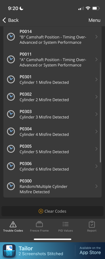

Went for a drive, lost power and now car exhaust sounds like it has cams
    Hmm, drove the car today and was fine until towards the end of my drive. Wanted to have my friend hear my new CSL intake roar and made a couple of short sprint runs and was fine. Then all of a sudden car felt like it lost all power and the idle felt really rough. No lights on the dash. Ran it through my diagnostic software and I got the faults in the screenshots attached. Felt like a vacuum leak, but now that it says Camshaft timing over advanced or system performance and misfires on all cylinders, not sure what it is. ugh.
    Doesn't sound like a blown motor or anythign too, just a rough idle.
    Only thing that I did recently was get the CSL intake with Alpha N tune. Thoughts?
    Hmm after a little research, it sounds like it may be vanos related? Maybe a solenoid pack? I just had my vanos done a couple of months ago. I'll need to contact them, maybe get the car towed there. ugh.
      This forum thread actually is exactly what my symptoms are: https://www.e46fanatics.com/threads/...e-pics.358494/
      i hope it’s just the two CPS.
        I bet it's the VANOS solenoid pack. The rebuilt ones seem to fail more often than the CPSs.
        Run the VANOS test if you have DIS.
        If not, unplug the solenoid pack to see if the sound changes.
          Unlikely that both cam sensors fail. I would guess 9/10 this is not your problem. Check if vanos solenoid plug is still attached (connector clips break very often, secure it with a zip tie). Also possible that solenoid pack has broken soldering joints inside or both broken vanos tabs can also cause same faults.
          if you have dis, make vanos test. If only inpa, check at least target and actual cam position.

                          Thanks guys. Question. Should I clear the codes and try driving around in order to get my car up to temp? It was running pretty rough last night and I haven’t started it back up again.
                            Originally posted by jpy1980 View Post
                            Thanks guys. Question. Should I clear the codes and try driving around in order to get my car up to temp? It was running pretty rough last night and I haven't started it back up again.
                            Only you can decide based on what you're hearing and what you think the risk is. If it was me in your position I'd try to rule out serious causes first, and also check things like the connectors others have mentioned first.
                              I'll get working on the test a little later today. I pulled theses codes via INPA and now I will try and clear it so I can go for a quick drive to get the car up to temp.
                              its crazy how much more detailed this is compared to the codes I pulled off of my iphone. only if i understood it all haha.
                              E R R O R M E M O R Y R E P O R T ------------------------------------- Date: 04/29/24 18:48:33 ECU: MSS54DS0 JobStatus: OKAY Variant: MSS54DS0 ------------------------------------------------------------- RESULT: 10 errors in error memory ! -------------------------------------------------------------
                              139 Tempomatsystem Error frequency : 6 Logistic counter: 38 Error occured 1. times at: Motordrehzahl 1920.00 1/min relative Fuellung 32.80 % Umgebungstemp. CAN 18.00 Grad C Versorgungsspannung HR 13.90 V aufgetreten vor (rel. BZ) 1.20 h Error occured 2. times at: Motordrehzahl 1880.00 1/min relative Fuellung 33.60 % Umgebungstemp. CAN 18.00 Grad C Versorgungsspannung HR 13.30 V aufgetreten vor (rel. BZ) 1.10 h Error occured 3. times at: Motordrehzahl 1920.00 1/min relative Fuellung 25.60 % Umgebungstemp. CAN 19.00 Grad C Versorgungsspannung HR 13.80 V aufgetreten vor (rel. BZ) 1.10 h v-Signal unplausibel Fehler momentan nicht vorhanden sporadischer Fehler -------------------------------------------------------------
                              185 AVANOS1-Regelung Error frequency : 1 Logistic counter: 40 Motordrehzahl 880.00 1/min Oeltemperatur TOG 102.00 Grad C Kuehlwassertemp. 85.00 Grad C Versorgungsspannung HR 13.80 V aufgetreten vor (rel. BZ) 0.10 h Istwert zu gross Fehler momentan vorhanden statischer Fehler -------------------------------------------------------------
                              184 EVANOS1-Regelung Error frequency : 2 Logistic counter: 40 Error occured 1. times at: Motordrehzahl 3880.00 1/min Oeltemperatur TOG 101.00 Grad C Kuehlwassertemp. 87.00 Grad C Versorgungsspannung HR 13.70 V aufgetreten vor (rel. BZ) 0.10 h Error occured 2. times at: Motordrehzahl 2040.00 1/min Oeltemperatur TOG 100.00 Grad C Kuehlwassertemp. 83.00 Grad C Versorgungsspannung HR 13.80 V aufgetreten vor (rel. BZ) 0.00 h Istwert zu gross Fehler momentan nicht vorhanden sporadischer Fehler -------------------------------------------------------------
                              205 Aussetzer Zyl.1 Abgas Error frequency : 1 Logistic counter: 80 Motordrehzahl 880.00 1/min relative Fuellung 27.20 % Kuehlwassertemp. 82.00 Grad C Versorgungsspannung HR 13.90 V aufgetreten vor (rel. BZ) 0.00 h im Betriebsintervall Fehler momentan vorhanden statischer Fehler -------------------------------------------------------------
                              206 Aussetzer Zyl.2 Abgas Error frequency : 1 Logistic counter: 80 Motordrehzahl 880.00 1/min relative Fuellung 27.20 % Kuehlwassertemp. 82.00 Grad C Versorgungsspannung HR 13.90 V aufgetreten vor (rel. BZ) 0.00 h im Betriebsintervall Fehler momentan vorhanden statischer Fehler -------------------------------------------------------------
                              207 Aussetzer Zyl.3 Abgas Error frequency : 1 Logistic counter: 80 Motordrehzahl 880.00 1/min relative Fuellung 27.20 % Kuehlwassertemp. 82.00 Grad C Versorgungsspannung HR 13.90 V aufgetreten vor (rel. BZ) 0.00 h im Betriebsintervall Fehler momentan vorhanden statischer Fehler -------------------------------------------------------------
                              208 Aussetzer Zyl.4 Abgas Error frequency : 1 Logistic counter: 80 Motordrehzahl 880.00 1/min relative Fuellung 27.20 % Kuehlwassertemp. 82.00 Grad C Versorgungsspannung HR 13.90 V aufgetreten vor (rel. BZ) 0.00 h im Betriebsintervall Fehler momentan vorhanden statischer Fehler -------------------------------------------------------------
                              209 Aussetzer Zyl.5 Abgas Error frequency : 1 Logistic counter: 80 Motordrehzahl 880.00 1/min relative Fuellung 27.20 % Kuehlwassertemp. 82.00 Grad C Versorgungsspannung HR 13.90 V aufgetreten vor (rel. BZ) 0.00 h im Betriebsintervall Fehler momentan vorhanden statischer Fehler -------------------------------------------------------------
                              210 Aussetzer Zyl.6 Abgas Error frequency : 1 Logistic counter: 80 Motordrehzahl 880.00 1/min relative Fuellung 27.20 % Kuehlwassertemp. 82.00 Grad C Versorgungsspannung HR 13.90 V aufgetreten vor (rel. BZ) 0.00 h im Betriebsintervall Fehler momentan vorhanden statischer Fehler -------------------------------------------------------------
                              213 Aussetzer mehr Zylinder Abgas Error frequency : 1 Logistic counter: 80 Motordrehzahl 880.00 1/min relative Fuellung 27.20 % Kuehlwassertemp. 82.00 Grad C Versorgungsspannung HR 13.90 V aufgetreten vor (rel. BZ) 0.00 h im Betriebsintervall Fehler momentan vorhanden statischer Fehler ================================================== ===========
                              I have no idea what these mean but it seems to have to do with the VANOS
