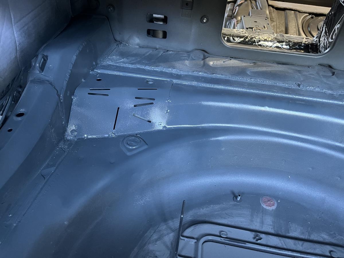

            Bumping this for the knowledge base after finishing my subframe job.
            I found a site in the USA that sells 4oz aerosols of RAL colors.
            Primed with a 2k epoxy aerosol primer
            The bulkhead is the suggested RAL 7003.
            The trunk is RAL 7016. This was the closest color ChatGPT could find when I uploaded a picture. My car is Carbon Black.
            Neither are a perfect match but are acceptable IMO

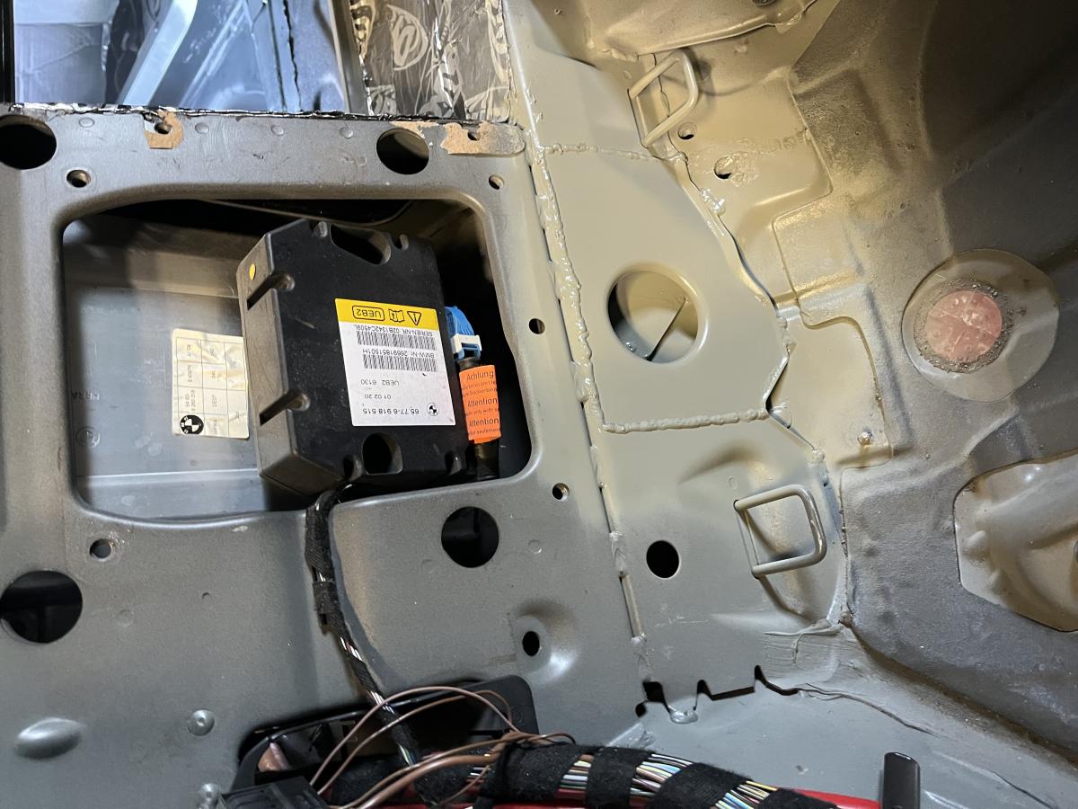

              More info for the knowledge base:
              A good option for the grayish green underside e-coat is SEM EzCOAT. # 62223 Olive Green is extremely close to the factory color.
              For the top side trunk area I bought a can of custom mixed Silber Grau from R&E (repaintsupply.com). The sheen does not quite match the dull finish in the trunk space, but I was not going for a concours level match.
              As Carbonvert said - Neither are a perfect match but are acceptable IMO.
