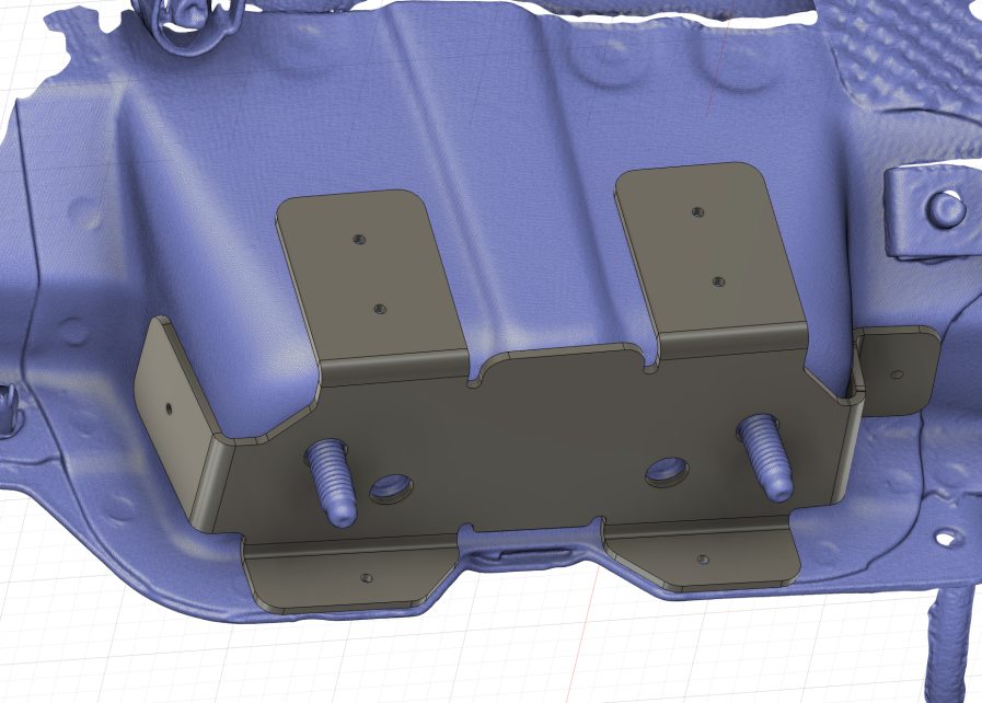

          Sway bar reinforcement brackets for use with bigger sway bars or if your mounts are deforming. These are designed to be bonded and riveted in place to prevent corrosion or stress cracking from welding.

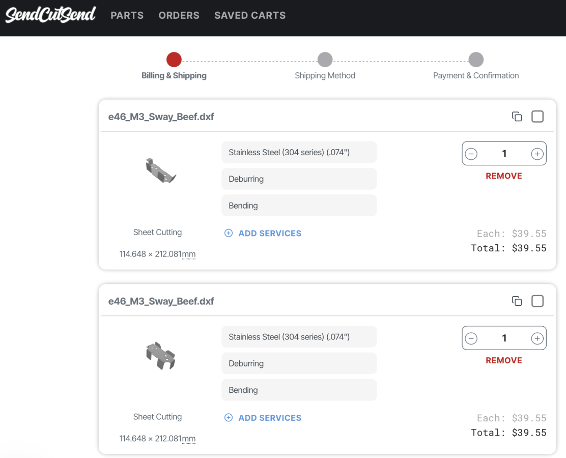

          Purchasable via this link at sendcutsend: https://cart.sendcutsend.com/li65gku0oex1 or by taking the DXF or STL attached to your favorite metal shop.

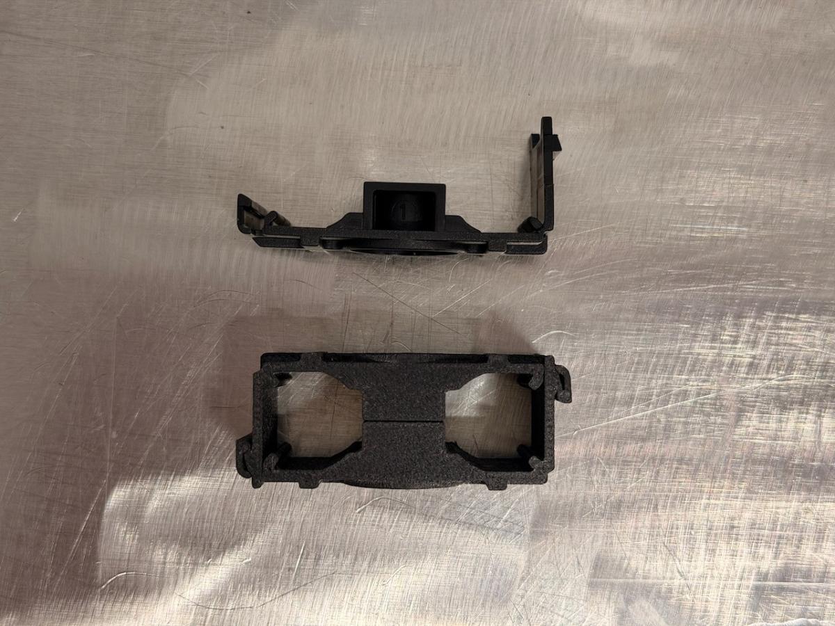

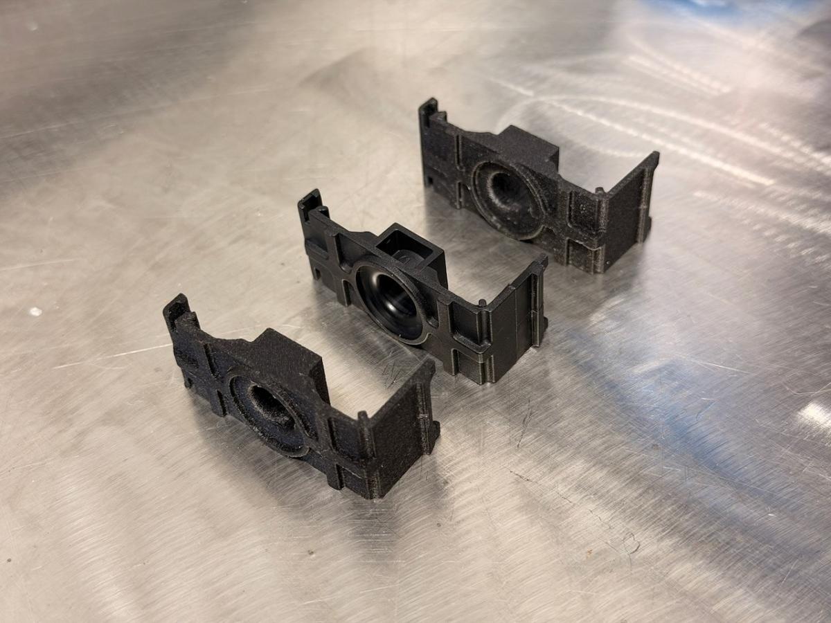

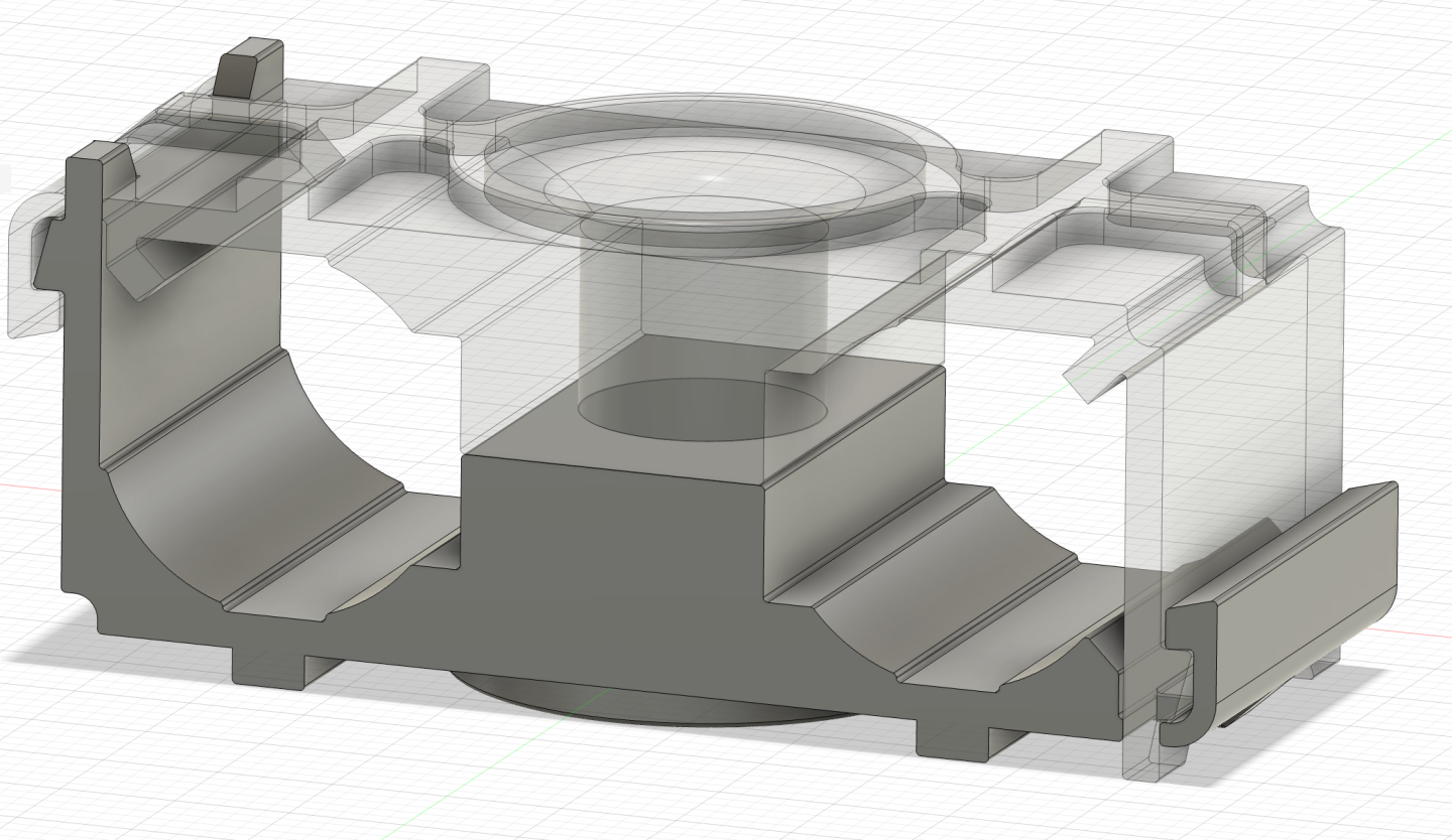

            This little oil cooler clip is broken on most e46s and is never replaced because *each side* is $30. Well, we weren't having any of that so I CADed and printed some FRP (ABS-GF in my case) ones. Here they are, mated to a factory plastic one and mated to themselves. I also included CAD for a beefier version, which I haven't printed yet but it may be less likely to fail, particularly if you're not using fiber reinforced plastic. This should cost you <$1 instead of $30.

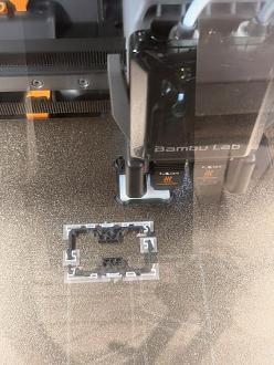

            3mf file I used is also included if you have a dual head printer
              Aaaand printing. Will be a very nice replacement for the current zip ties.
                Thanks, I printed these out of some PET-CF I had and they came out great.
