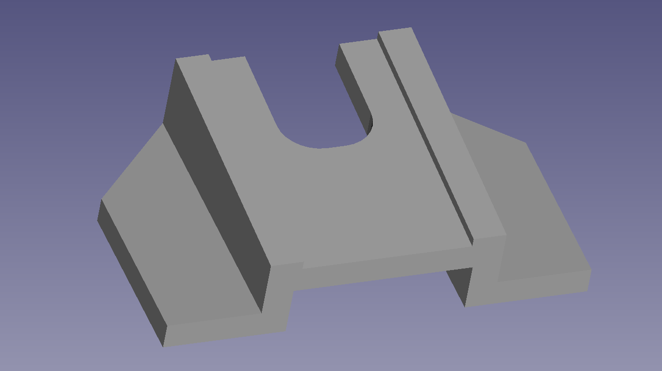

    Rear Fender Bracket
    Provided by: karter16
    Click image for larger version  Name:	Screenshot 2024-07-13 at 8.53.41 AM.png Views:	1 Size:	14.9 KB ID:	271709
    This bracket is a replacement for the original item. These mounting points are bonded to the fender support and are not available as an individual part.
    Recommended Material: The original part is made from PA12-GF30, so a fibre-reinforced Nylon would be ideal. In practice simple Nylon 12 is probably fine.
    Files:
    Rear Fender Bracket (STL)

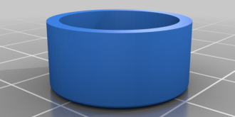

    Idle Air Hole Cap for Karbonius CSL-Style Air Intake
    Provided by:heinzboehmer
    Click image for larger version  Name:	Screenshot 2024-07-13 at 2.33.54 PM.png Views:	0 Size:	65.6 KB ID:	271815
    The cap for the idle air hole that Karbonius supply may not fit perfectly. This cap somewhat mimics the design of the flange on the CSL part that's supposed to attach there.
    See here for more context
    Recommended Material: Using a flexible material like TPU is advised as it will help dampen out any remaining rattle.​
    Files:
    Idle Air Hole Cap (STL *remove ".pdf" off the end of the file name*)

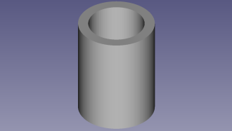

    Peg Bushing for Unfiltered Section of Karbonius CSL-Style Air Intake
    Provided by: heinzboehmer
    Click image for larger version  Name:	Screenshot 2024-07-13 at 2.39.43 PM.png Views:	0 Size:	10.4 KB ID:	271816
    The holes for the pins on for the unfiltered section of the intake are way too big and allow the unfiltered section to rattle around. This bushing is designed to make for a snug fit.
    See here for more context​
    Files:
    Peg Bushing (STL *remove ".pdf" off the end of the file name*)

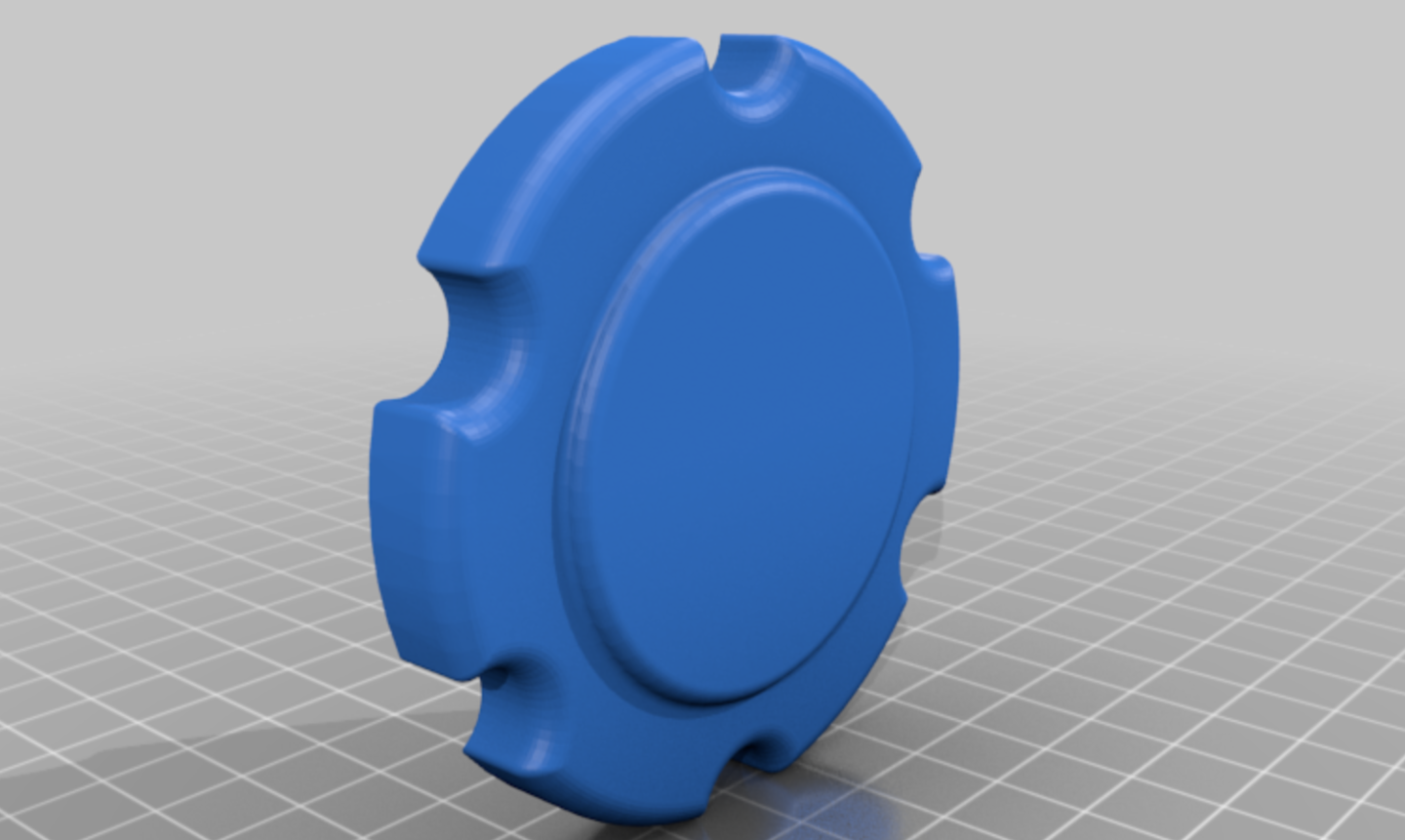

    OE-style Cap for Moroso Coolant Expansion Tank
    Provided by: Sid_E46
    Click image for larger version  Name:	Screenshot 2024-07-13 at 2.46.43 PM.png Views:	0 Size:	449.0 KB ID:	271817
    This cap is designed to give a more OE look than the cap that comes with the Moroso tank.
    Recommended Material: Chemically resistant material
    Files:
    OE-style Cap (thingiverse link)

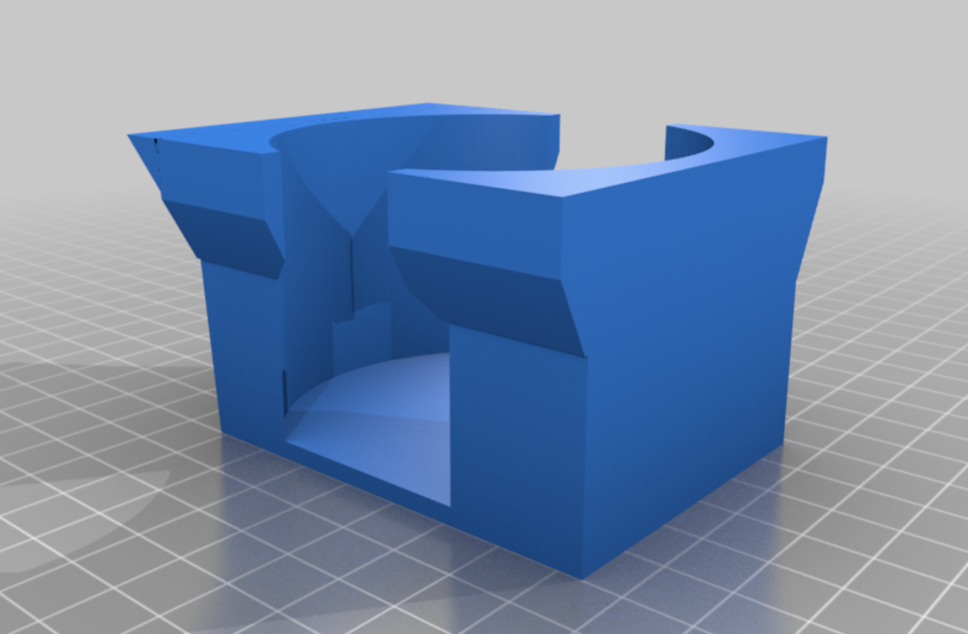

    Euro Console Cup Holder Insert
    Provided by:I M Legend
    Click image for larger version  Name:	Screenshot 2024-07-20 at 5.56.33 AM.png Views:	0 Size:	631.9 KB ID:	272493
    For those folks with the Euro Center Console Tray but still want a cup holder in your E46, this insert will fit nicely inside and will be hidden with the sliding door closed. Friction fit but you can also use double sided tape for a more secure fit.
    Recommended Material: ABS or PETG
    Files:
    Euro Console Cup Holder Insert (thingiverse link)

        Oh good idea! Attached are a couple bits I designed for my karb airbox (remove .pdf from filename). Both are made to be printed out of TPU (or some other similar flexible material).
        More info about both parts: https://nam3forum.com/forums/forum/m...433#post261433

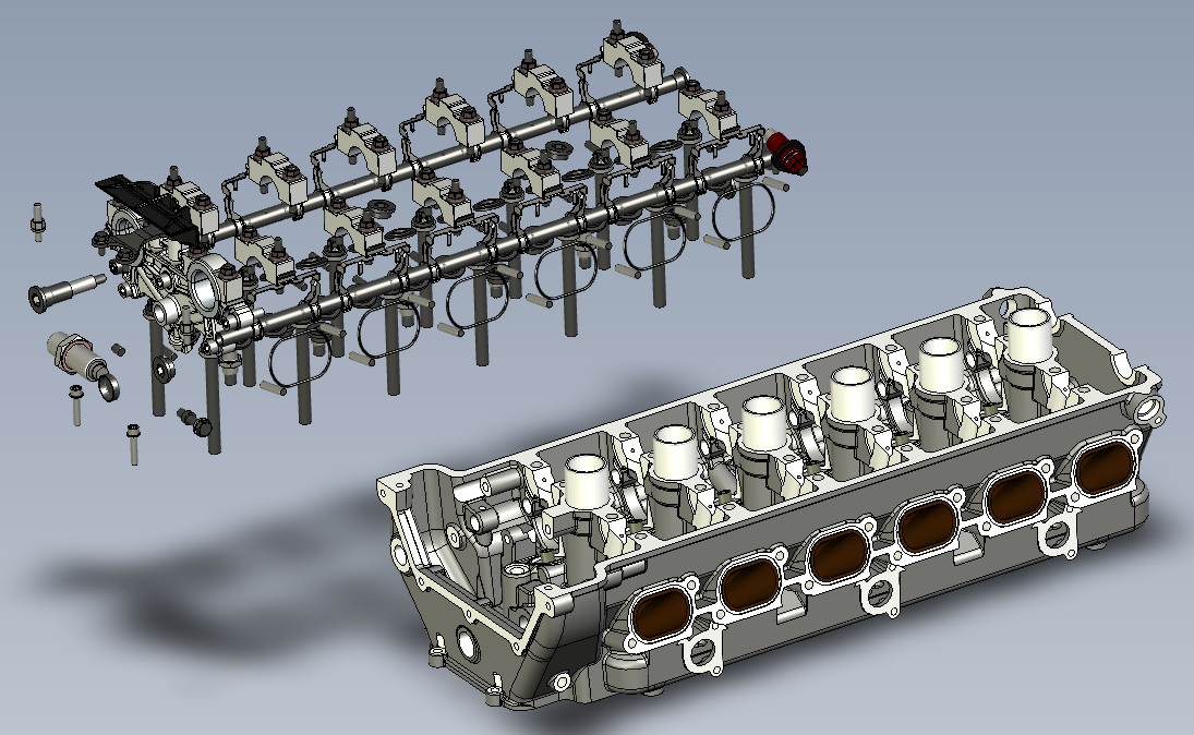

          Any interest in this lol
ID:	271732Click image for larger version
            Here is my Thingiverse account where I'll be uploading more parts as I design more. All I have up there so far for the E46 M3 is a cover for the Moroso cap.

                haha wow! - what's the provenance of this? And what is it exactly? The oil pan is different at least I note...
                  As I recall, it was a student project-- not a file that leaked out of BMW.
                  So fun, but don't design any tight tolerance parts around it :P
                    Yeah, I was thinking of printing random parts out on a Bambu, to see how close the model is to actual parts. But I have 0 expectations.

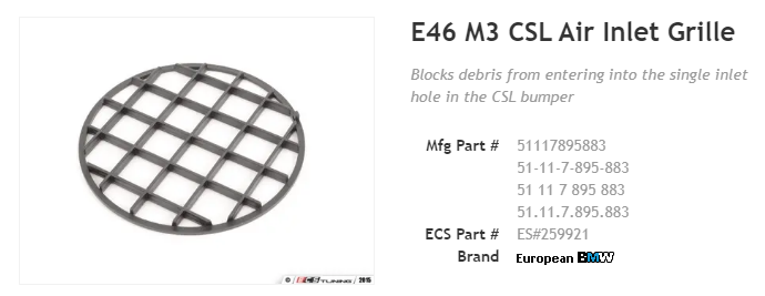

                      Has someone made one of these yet? These are dumb overpriced for what it is lol
                        It's modeled well but the few things that I've used it for required dimensional changes.
                        Inlet grill is easy but you need an OEM one to copy or a bumper to design from.

                          Here's cup holder insert for the Euro console: https://www.thingiverse.com/thing:5420255
