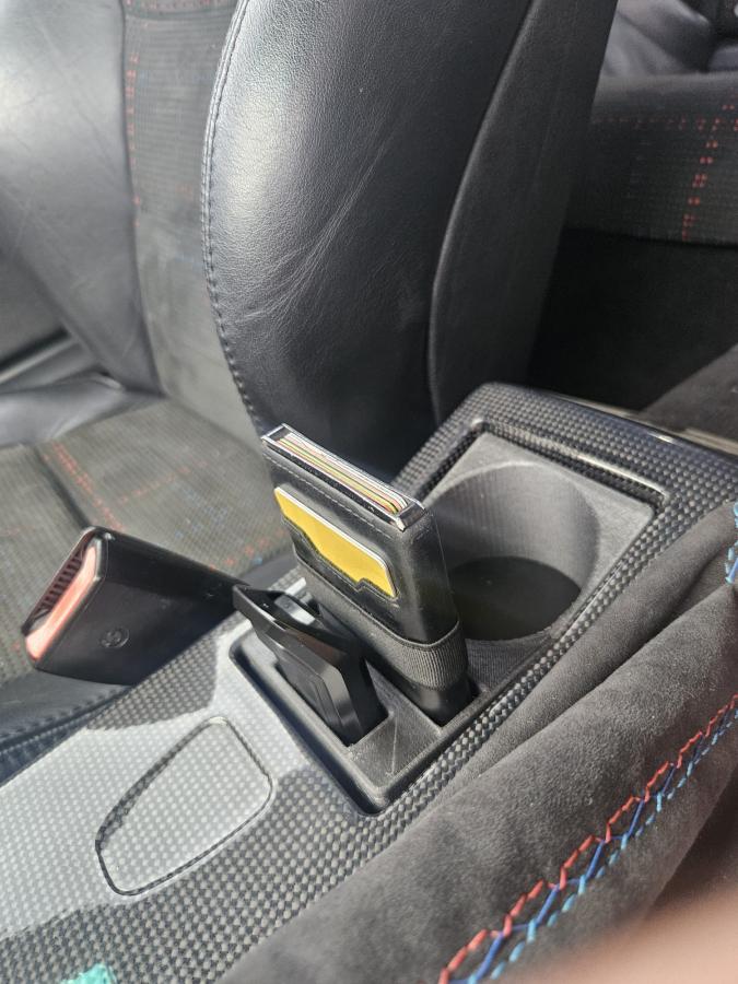

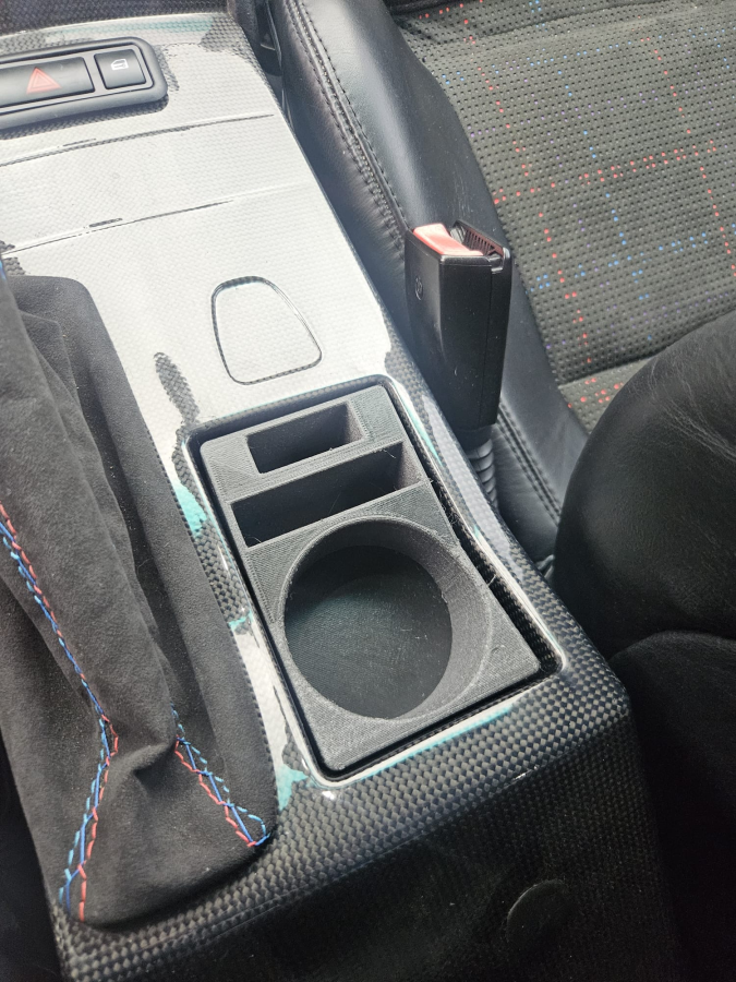

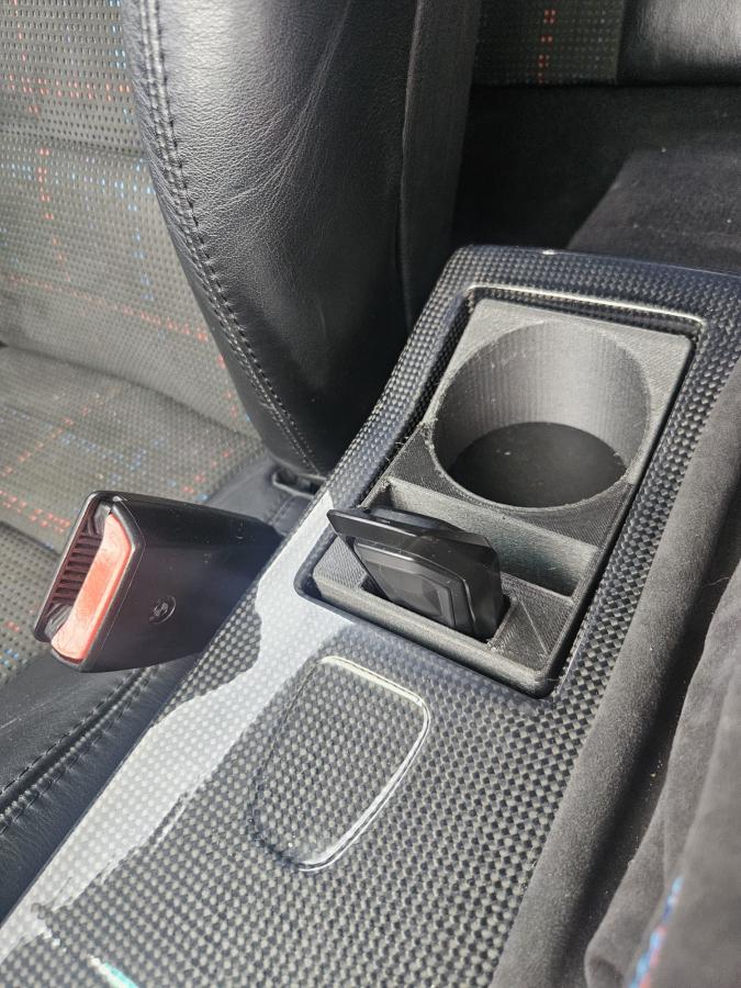

                            Made a little file for a cup holder, wallet holder, and fob holder (valvetronic) for the vorsteiner CSL console storage tray. Just have it double sided taped down

                                updated this with some minor changes. Made the wallet and fob holder 'pill' shaped, with chamfer/fillets on the interior edges, so things can slide in and out more easily. Also made the overall cup size bigger on the main print, but included an adapter piece which has clearance for a difference of 0.5mm in diameter, so it fits snugly with no need for key/lock mechanism. I'm probably done with this file for now as its pretty functional for it's purpose.
