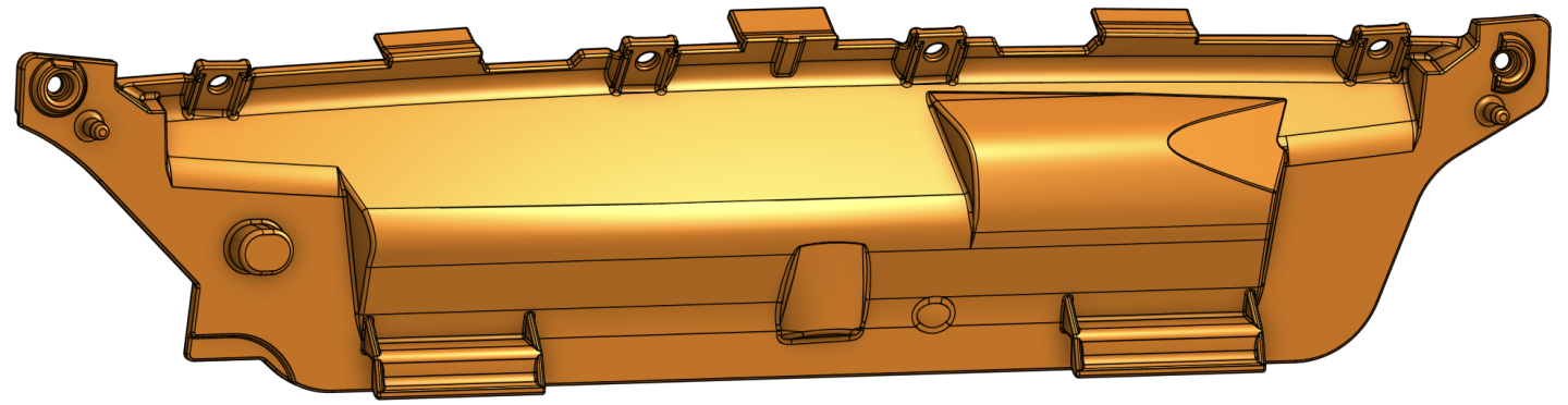

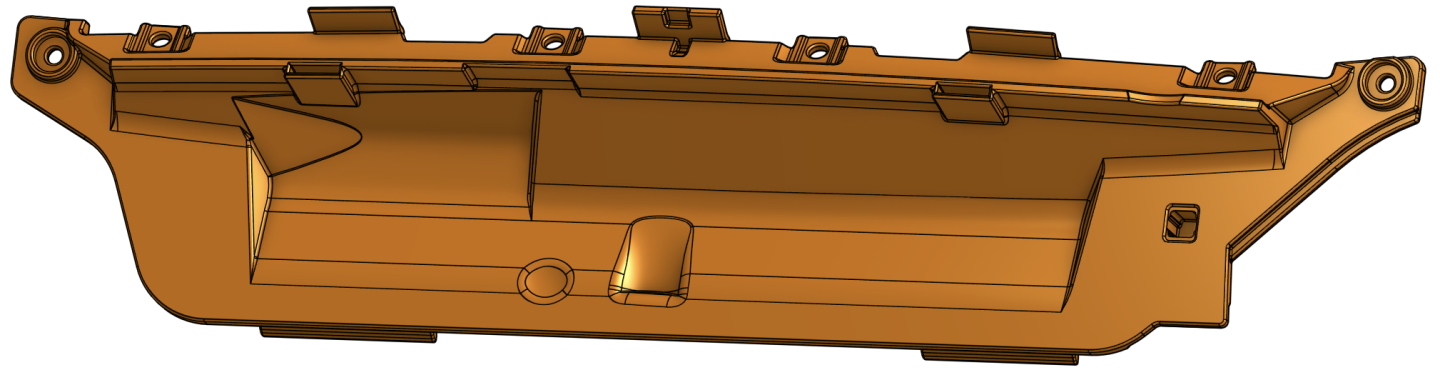

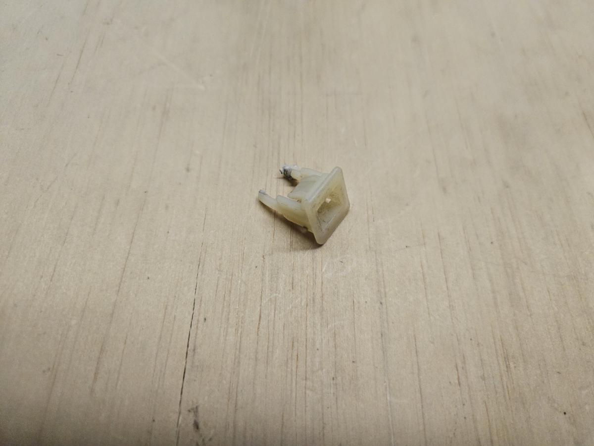

    Have some miles on this now, so feeling confident enough to share. Attached is a 1:1 recreation of the firewall plug (64318362894).
Name:	Screenshot 2025-09-05 at 5.04.02 PM.png
Name:	Screenshot 2025-09-05 at 5.04.22 PM.png
    You'll likely need to split it up into a couple pieces to print out on a standard-sized desktop printer. You will also have to cut out the white clip from your stock piece and glue it into the printed one, like so:
    I printed mine out of PET-CF with 10% cubic infill and 3 wall loops. Has been holding up fine so far. You want to make sure the infill does not have a continuous volume, for thermal isolation.
    Final weight will depend on material and print parameters, but it should land around 300-400g. Stock is 1618g, so ~1268g (2.8 lbs) weight savings with no downsides.
    Bonus with this part is that you'll get more intake noise inside the cabin!

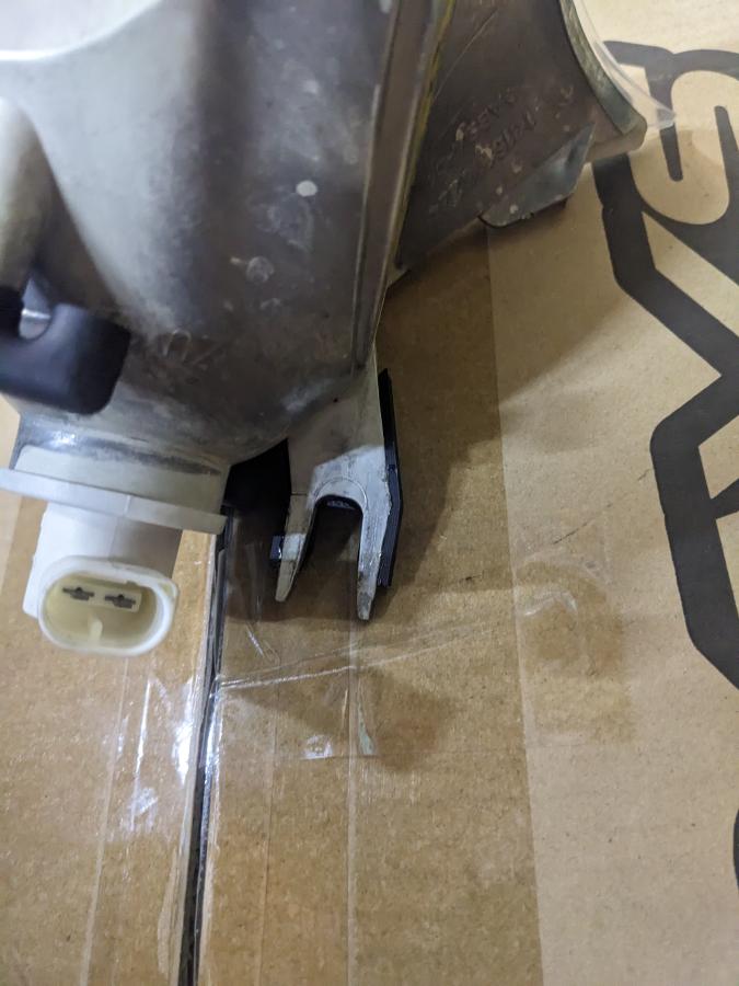

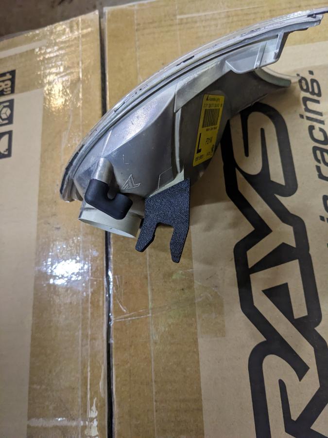

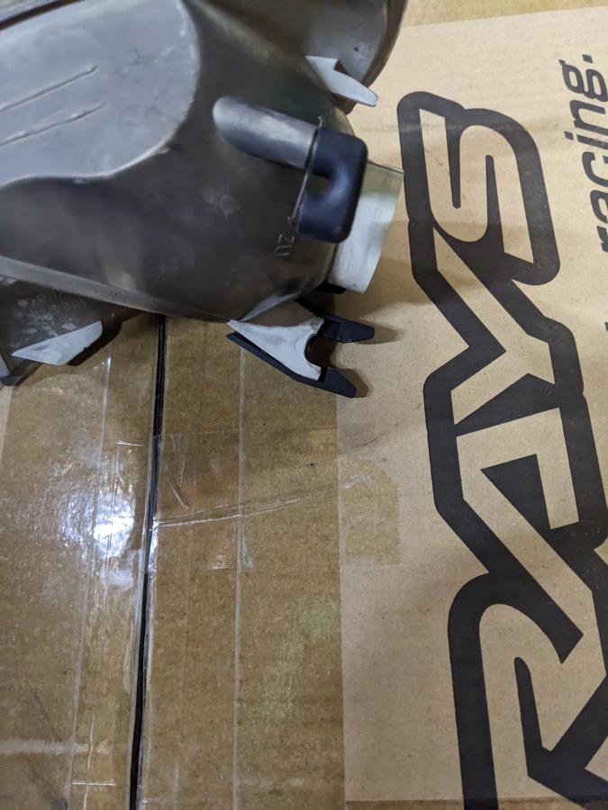

        Designed these repair tabs to fix the corner light attachment points. I was able to salvage my Bosch corners and ditch of the ebay/china cheapos that I had been using. The ""broken" version is for missing tabs and the "cracked" version is for...well...cracked tabs. The files contain both L/R parts. You will need ot epoxy these to the original remaining tabs. If you need a set but don't have a printer, let me know and I can hook you up for a reasonable price.
        2003.5 SG/Grey

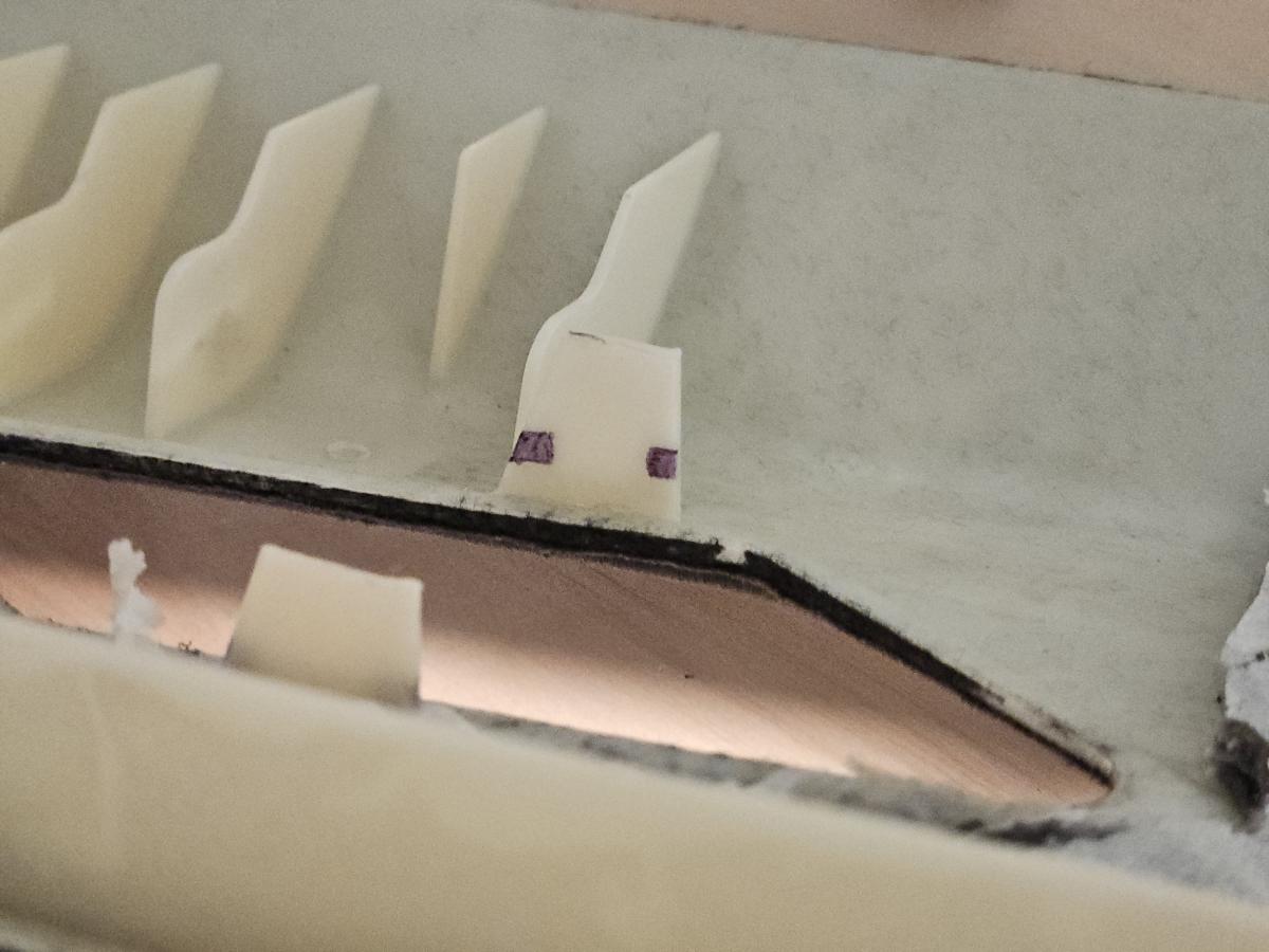

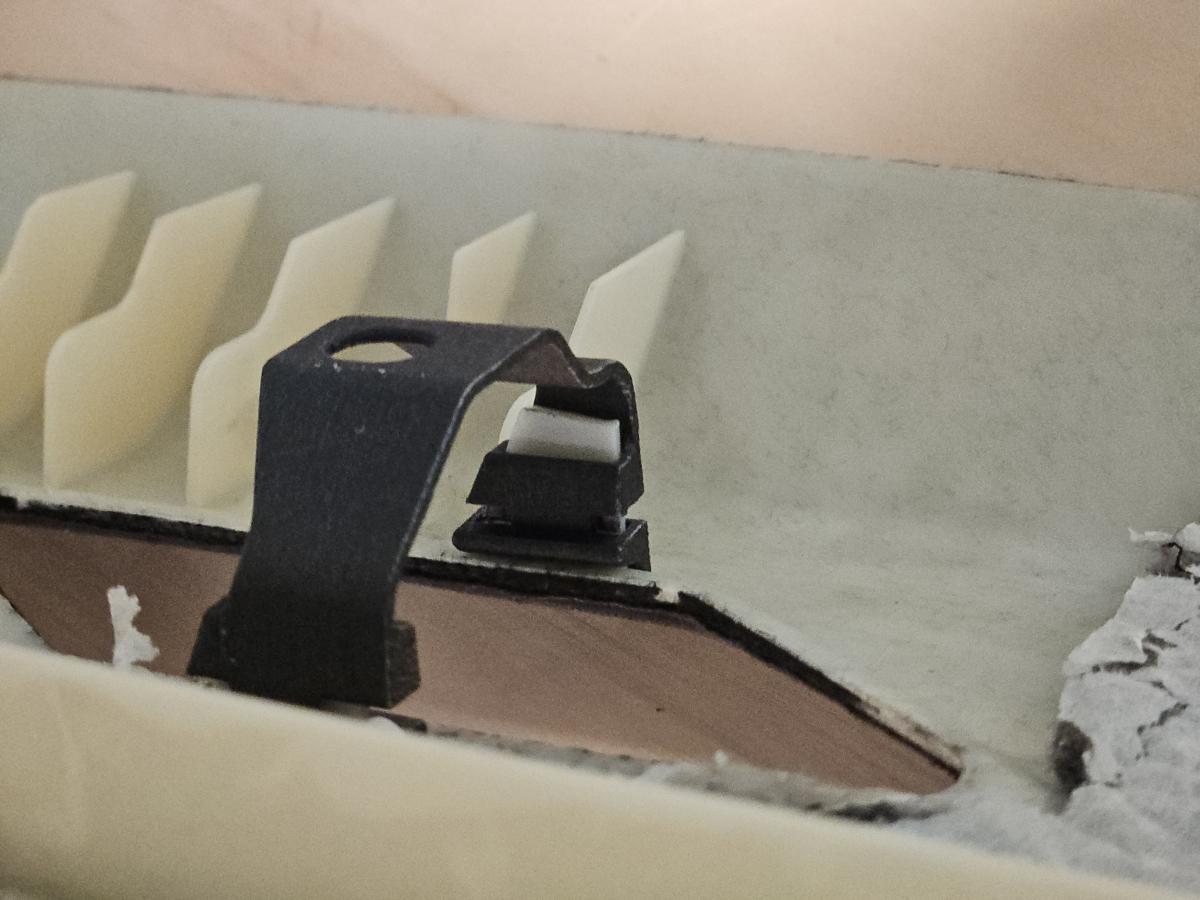

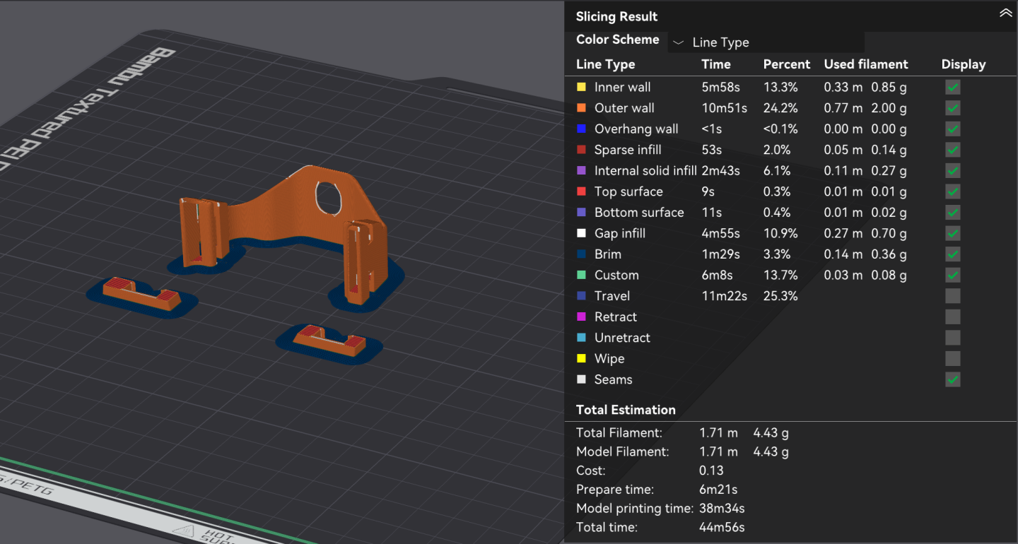

              Sharing my fix for C pillar tab that goes behind the light:
Name:	Screenshot 2025-12-25 at 4.37.28 PM.png
              Print in the following orientations and with 100% infill for max strength. Shouldn't need supports if you print with a small layer height (I used 0.08mm):
Name:	Screenshot 2025-12-25 at 4.31.16 PM.png
              I chose ABS-GF for this application, but pretty much any material should work. This part sees very small loads.

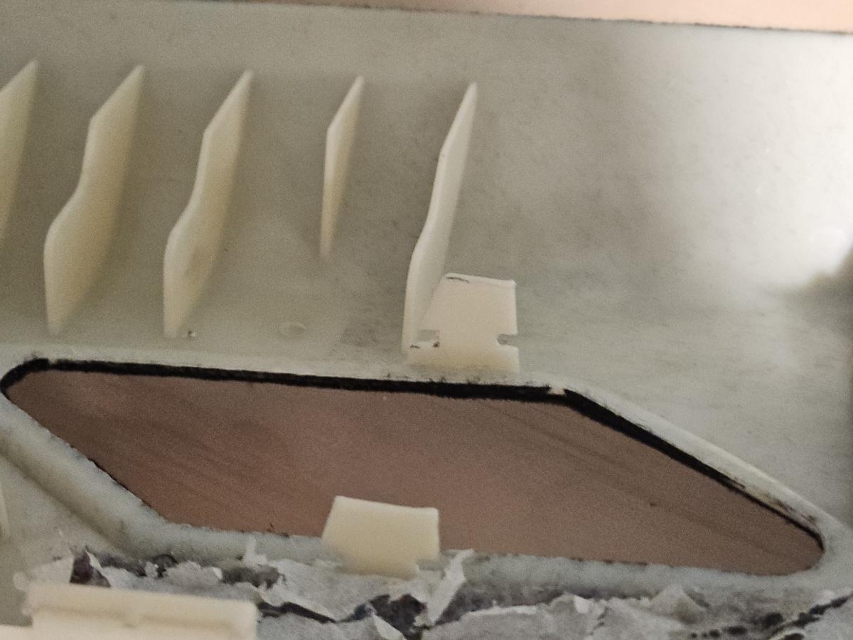

              To install, you need to trim the remaining plastic, mark out the location of the notches, then cut those bits away:
              Works perfectly fine assembled dry thanks to the locking clips, but I assembled with a bit of epoxy for some extra durability.

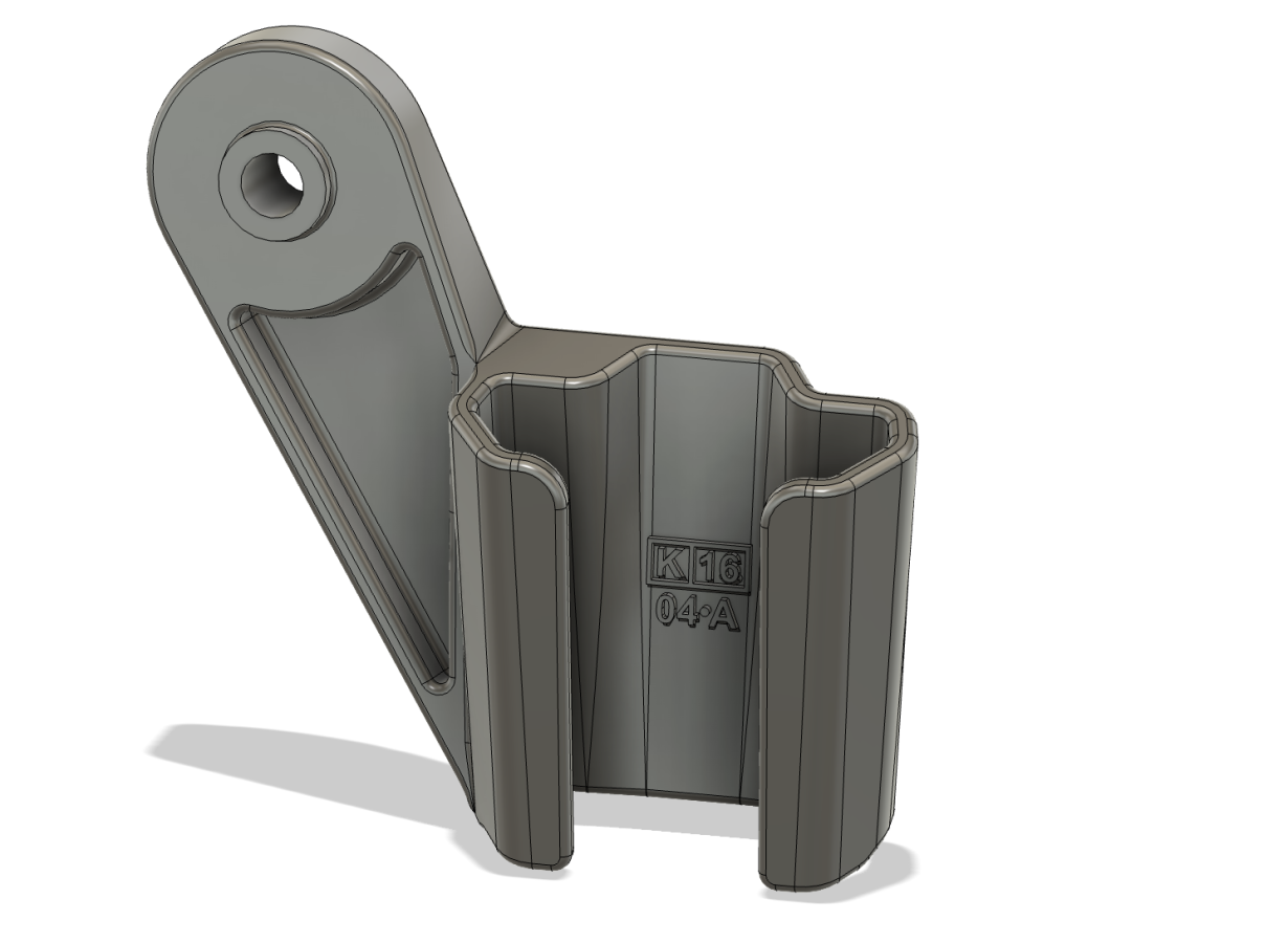

                            CSL SMG Reservoir Bracket
                            This bracket is designed to take advantage of the existing stud on the M3's front left shock tower. It saves having to drill and rivet the OE CSL bracket. This part replaces part 41147896136.
                            PLEASE NOTE: This piece has been designed on a car that has a Karbonius CSL airbox and Haimus snorkel. I cannot be 100% sure that it fits other combos. If you encounter any fitment issues with your particular combo please reach out to me!
                            I recommend printing this in PETG-CF or better. I also recommend using a thin foam washer between the bracket and the shock tower to protect the paint, plus an M6 washer and M6 lock nut.
                            K16 - 04A - CSL SMG Reservoir Bracket.stl.zip

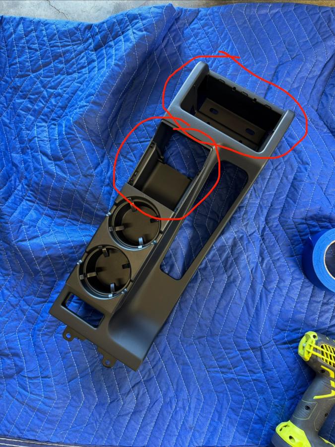

                                Also does anyone have some alternatives, like plugs or block off plate type of things for these?
                                '01 M3, Imola/black
