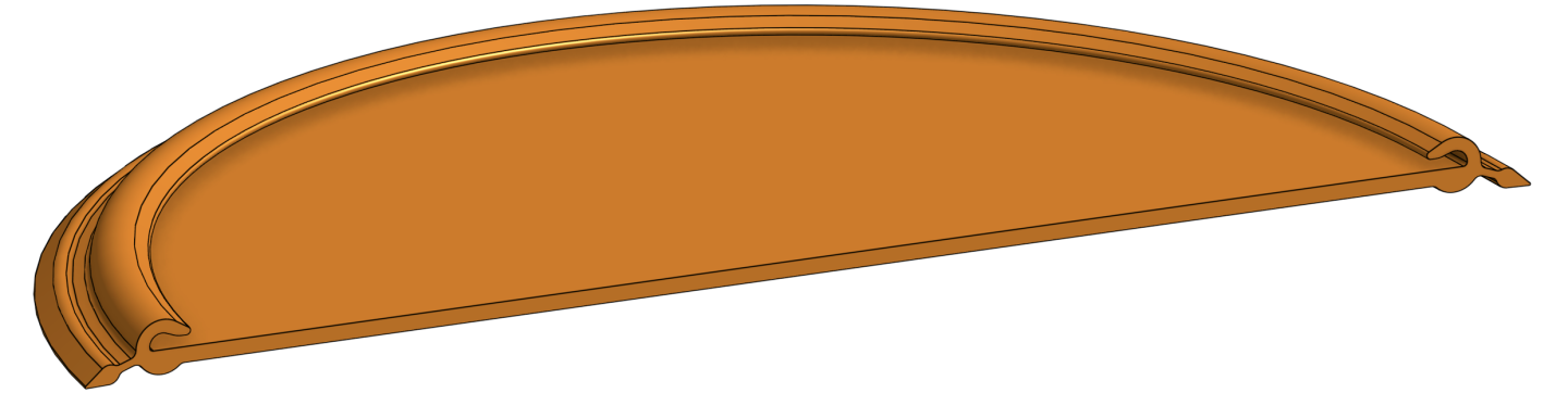

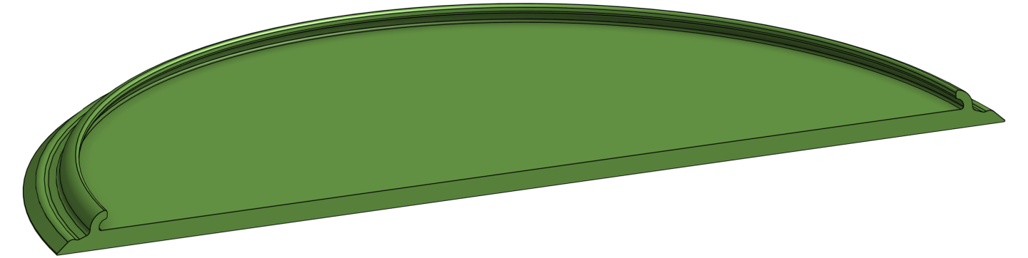

    Uploading a recreation of the CSL flap seal.
    There are two versions attached: the first is a 1:1 replica and the second is a slightly modified version so that it can print flat on the bed plate without supports. This should be printed out of some relatively stiff (95A or so) TPU.
    Note that you'll need to print two, one for each side of the flap.
    CAD here: https://cad.onshape.com/documents/cf...025a2e9c87b392
    1:1:
    Click image for larger version  Name:	Screenshot 2026-05-31 at 11.17.28 PM.png Views:	6 Size:	132.1 KB ID:	357088
    Print optimized:
    Click image for larger version  Name:	Screenshot 2026-05-31 at 11.17.46 PM.png Views:	6 Size:	128.6 KB ID:	357089
    See this post to see the print optimized part installed on 0-60motorsports's car: https://nam3forum.com/forums/forum/m...014#post357014

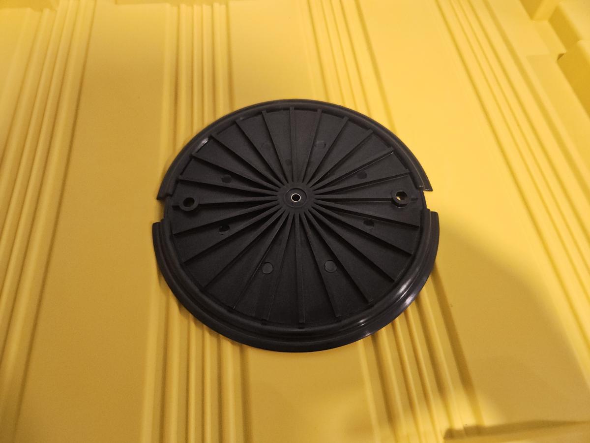

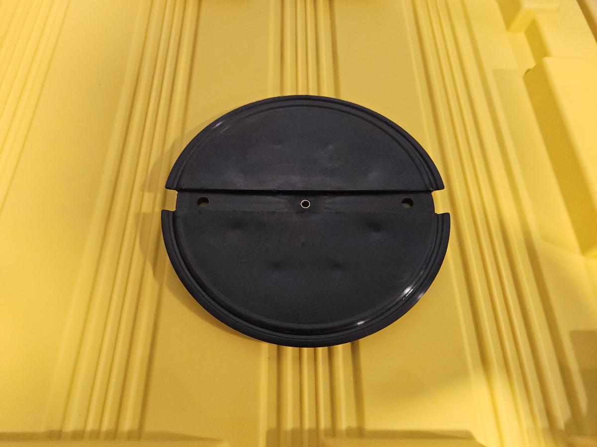

    Also, just for reference, here are some pictures of a basically new OE flap:
    Click image for larger version  Name:	20251222_212246.jpg Views:	6 Size:	73.5 KB ID:	357086
    Click image for larger version  Name:	20251222_212307.jpg Views:	6 Size:	75.2 KB ID:	357087

      I installed the 1:1 Version. Im sure it'll hold up just fine and i will give you feedback after the summer. the "real" test LOL. Cheers.

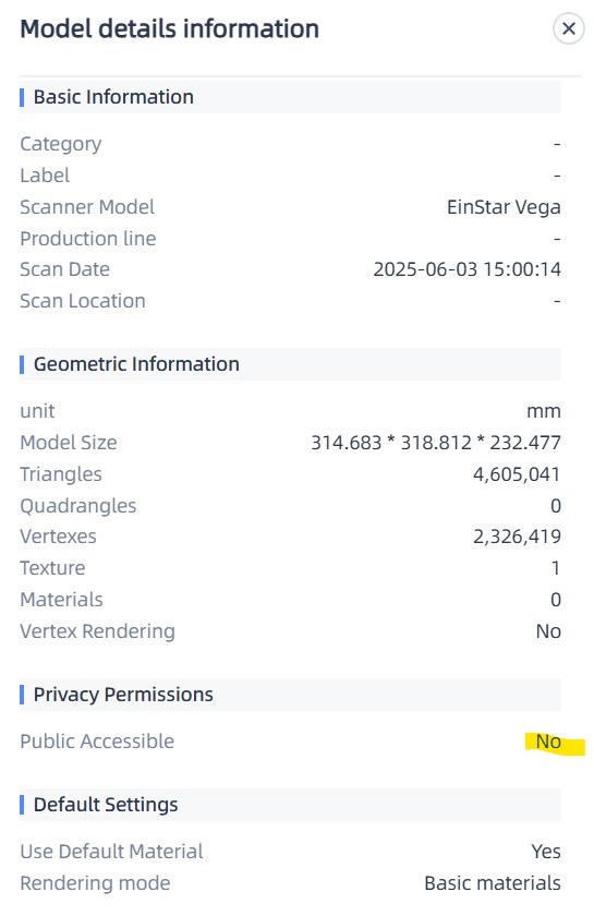

              Appreciate it Heinz! Forgive my ignorance as I've never used that site before, but I don't see a download button. Is it possible to download the file to import the mesh into my CAD application? If not, even just being able to measure in that web app will prove useful so thanks either way!

                Huh, weird. You're definitely supposed to be able to download them. I updated the links in my post, can you try again?
                If it still doesn't work, PM me your email and I can send you the mesh files directly (they're too big to upload here).

                        Perhaps this setting? I was curious to make something like NIco above out of PA6 but I ended up just getting a race box.

                          When sharing, there's an option to explicitly enable downloading. I turned that on, but site is being funny.
