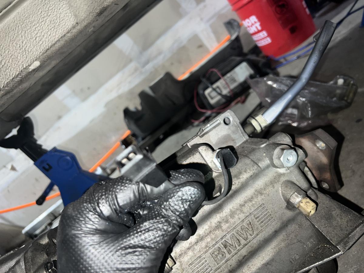

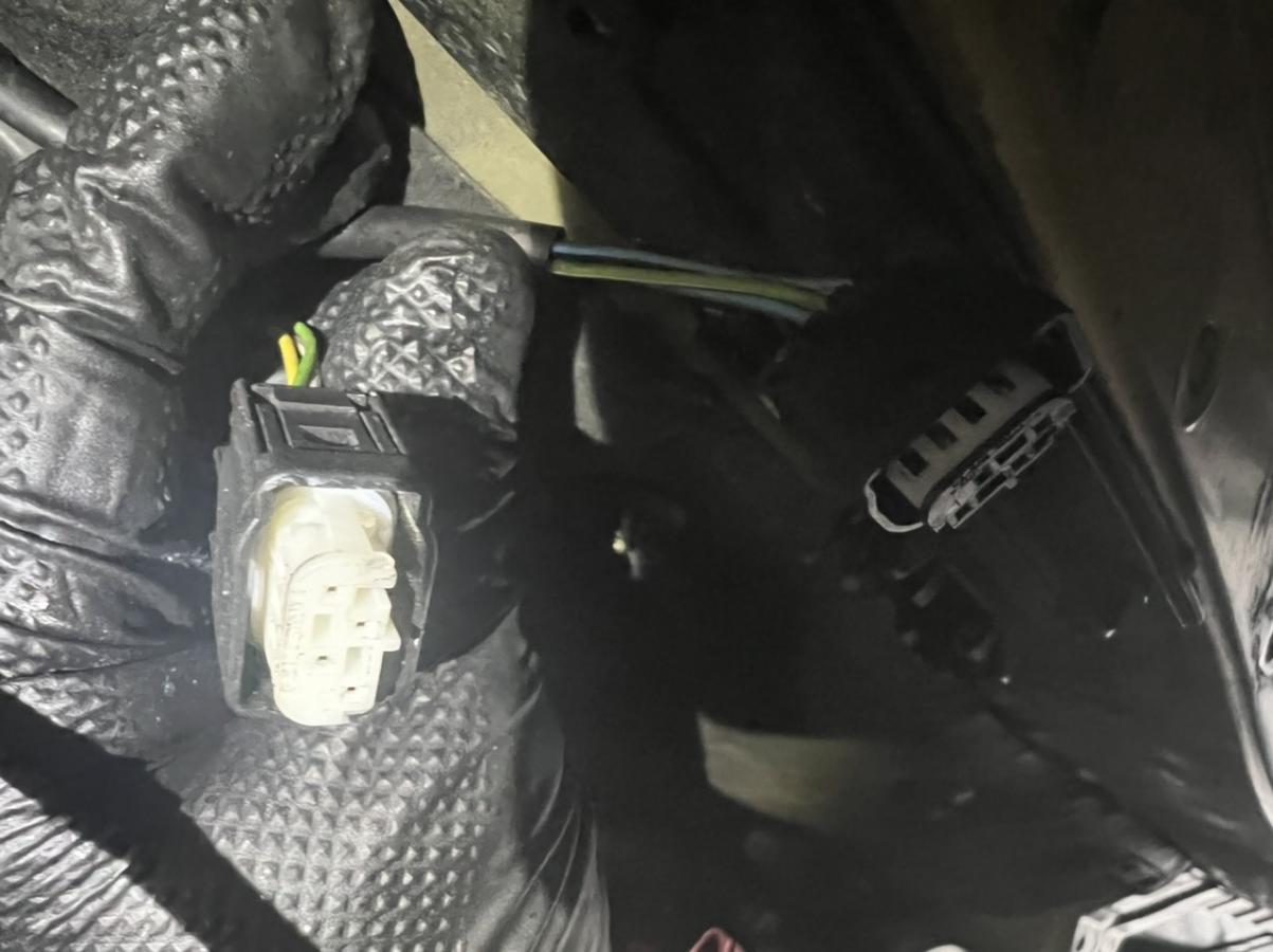

                            hey guys I still don’t have a clear answer on what to do with the Gear Position Sensor. I installed it and id like to make it work. The only plug back there that would fit is the one that goes to the reverse light sensor. The SMG GPS sensor connector is an oval 4 or 6 pin, and there are two of them. The only other plug that is close by is the one that would go to the temperature sensor. Everyone makes it sound like this part is easy but I still don’t have a clear idea of what to do with this GPS. Please help before I give up and let it dangle!
                            this is the 6MT gear position sensor:
                            Gear position sensor
                            these are the old GPS plugs from the SMG:

                              You either have to buy a manual transmission wiring harness or get creative modifying your SMG harness which is well documented online.
                                When doing the smg to 6mt, how did you wire up the clutch switch signal? The clutch switch signal should be connected to the said GPS wire (one of the 2 wires) in series, and then have the other wire connected to DME X6002 (24pin connector) pin20. You could cut the 2pin connector off and solder the wires together, or find the correct connector and wire the wires up.
