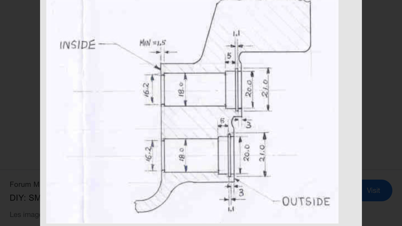

                    Are those the correct measurements for the SMG bellhousing machining? If not, can someone put the right one here.
                    I am located in Montreal, Canada and I have 3 SMG transmissions to do and it makes no sense to ship those bellhousings to USA right now as there are huge delays in delivery with most shippers.
