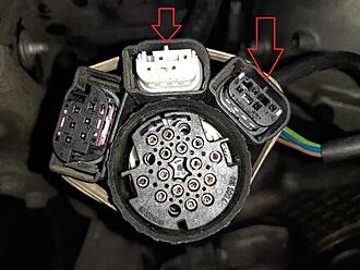

    I'm in the middle of my conversion and have installed the "Gear Identification Switch". I've seen people ask "how do we connect it" but have yet to see an answer.
    The OP wrote "Once the transmission is installed in the car, a now unused SMG connector will hook up to this sensor. In order to mate these connectors, the center plastic tab on the outside of the gear recognition sensor will need to be sliced off with a razor. Again, looking at the connectors side by side, it will be very obvious what needs to be cut off in order for them to work together.", but the available connectors are obviously incompatible. Do we need to pull out a couple wires for the connection and which are they?
    Help would be appreciated, else I might have to start thinking...

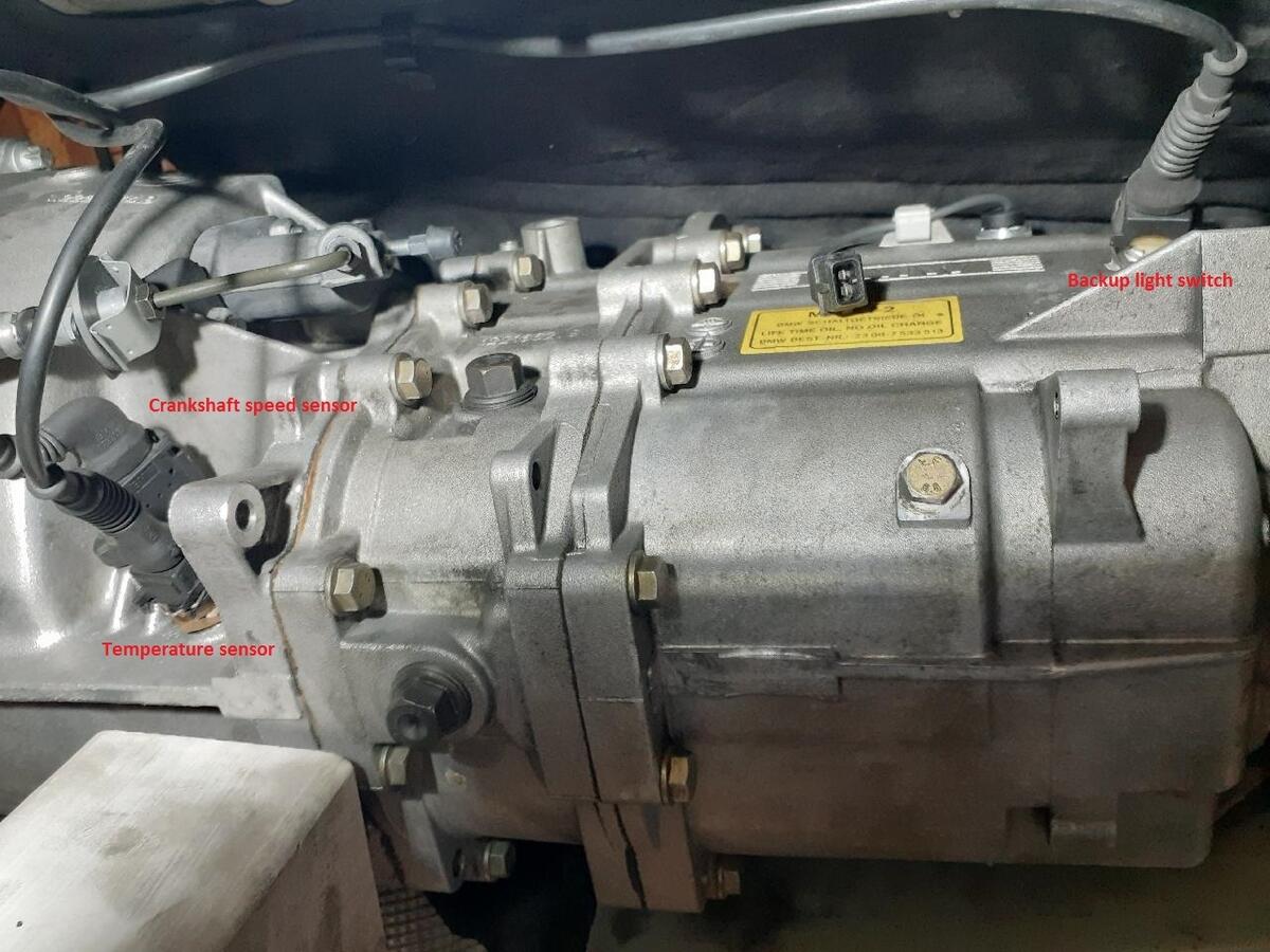

    It's been pointed out that the "manual" transmission doesn't have any of the following labeled sensors, so I assume the backup light switch connector gets moved to the gear identification switch.
    What do most people do with all the irrelevant wiring (bundle it up out of the way, or pull it out)?
    Thanks...

      Irrelevant wiring was bundled up for a while, eventually to be removed entirely. I can't recall exactly what the GPS is connected to. I will be under there again in the near future, I will have to look again.
