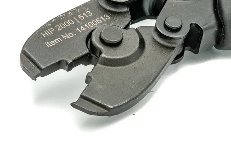

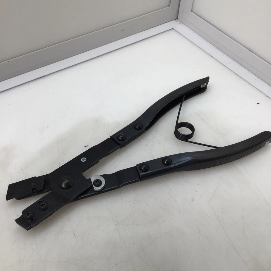

                  Better hose clamp?
                  The CSL clamps are only 7mm low-profile clamps. Which is probably why they were chosen by BMW - 6x 11617831745 CSL Airbox pipe clamps.
                  They can be placed so as not to fowl and mechanical linkage. Although in the six or seven times i have removed and refitted the airbox, they have never fouled anything mechanically. Mine are set to a more 10 or 11 O'Clock position. Mostly because i have been leaning over the car on a sloping driveway when installing them.
                  To gain proper access to the clamps for installation, remove the auxiliary air pipe beforehand, rather than straining like i did, when i first refitted my airbox.
                  The non-compound action Oetiker pliers are good enough and are the actual BMW supplied tool for the job, cheaper than the HIP2000 which i also have
