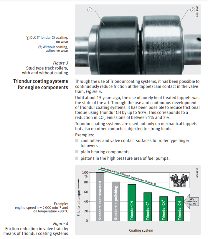

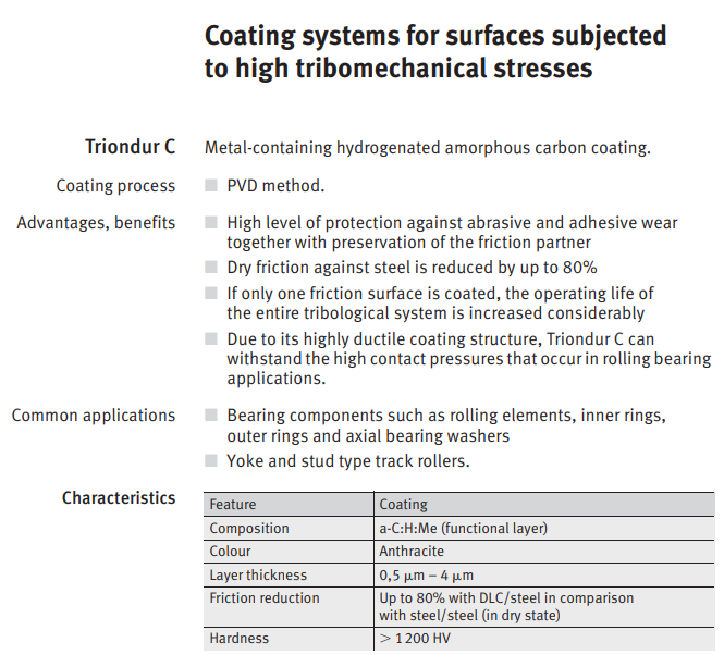

                    Interesting infographic I found while looking.
                    Click image for larger version  Name:	image.png Views:	0 Size:	271.3 KB ID:	274541
