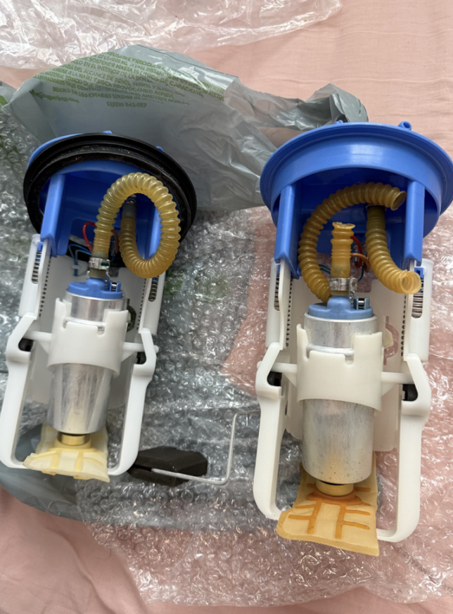

    Context: I bought a new fuel pump from a dealer in 2019. About 15k miles later, the hose on the assembly gave out and cracked. In the interest of time and longevity, I bought a new unit from FCP Euro at the end of 2023. 18 months later, and with only a few hundred miles of driving, the new pump has also decided to stop working. Ok, no problem I figured; I'll just use this lifetime guarantee for the first time (I've ordered thousands of $$ worth of parts from FCP in recent years). But, two problems:
    1. At the end of 2023, the new pump assembly was $500 + tax. Today, its $700 + tax. Ok fine, I'll pay another $200 + tax. That's still decent value I suppose.
    2. But now I learn that in order to use FCP's lifetime replacement guarantee, I have to first re-purchase the fuel pump assembly as a new/separate transaction and then send back the old one after. Kind of annoying but still doable. However, I also learn that I don't even get a refund for the original purchase, I get store credit instead. I have admittedly never taken a close look at the terms & conditions or recent policy changes, but I find this appalling and borderline fraudulent. To me, FCP's wording and marketing of the "lifetime replacement" implies an equivalent exchange of a defective part, which is materially misleading and does not align with the remedy they actually provide. The policy functions as a repurchase cycle, not a replacement guarantee, and locks customers into higher prices and store credit with effectively no practical way out.
    With that said, I'm not sure if I want to continue doing business with these guys. I'm also not sure what to do at this point. I could swap the functional pump from my 2019 assembly into the 2023 assembly, but I don't know how long it will last. And from what I remember, aftermarket alternatives have always been hit or miss. I've been out of the game for a few years; are there any new/reputable alternatives that I don't know about? What would you do in my shoes? Thank you in advance, gents.

      dumb question as its been a decade since I've looked at the FP in person, but is it not possible to somehow cannibalize the FCP pump hose to the dealership pump?
          I'm sure it's possible, whether swapping the hose or pump. But that pump is 6 years old, and though it worked when I removed it, I'd have to give it some power and test it. And then I don't know how long it would last.

              I wonder if there isn't a fuel hose you could order and cut to length, I don't know if rubber fuel hose would be able to run that loop without kinking.
              You might have to either make that loop a larger diameter or eliminate it, but something tells me the loop is there for a reason.

                        I hooked up my older pump (from 2019 with the broken hose) to a battery and it fired right up. Was able to remove the pump from the assembly also. Now I can either:
                        1. Swap the old working pump into the new assembly, or,
                        2. Put the old working pump back into the old assembly, buy the replacement hose that heinzboehmer linked, purchase a lifetime replacement from FCP ($700+), return the defective 2023 pump assembly for $500 in store credit, and immediately re-sell the new one for whatever I can get for it on here ($400?). Don't think the hassle is worth my time..
