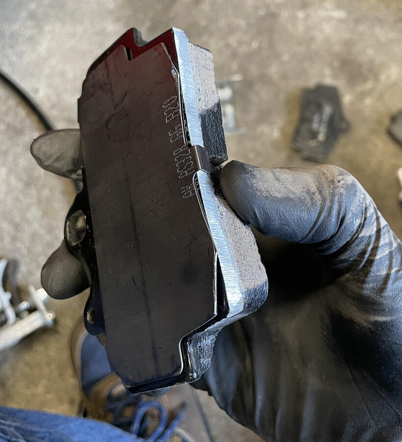

    Recently completed this conversion on my street car. Wanted to share that I used the ECSTuning rear brackets (CreationsMotorsports) and was able to pretty easily get the Shape "D737" larger pad to fit on the back of the rotor with some light trimming on a bench grinder. Also trimmed the backing plate to maintain that. Specifically using the Akebono EUR737 from FCP Euro.
