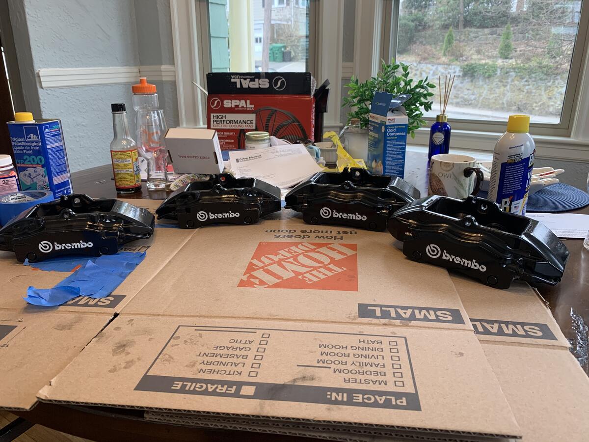

      Just finished with these. I sanded off the Porsche logos with 1000 grit, put decals on, VHT clear over it. Not perfect but it passes the two foot test and they’ll be covered in brake dust soon enough anyway. The calipers came disassembled so rebuilt with the Girodisc seal and boot kits. I used brake fluid as lube and pistons went in nicely for the most part. Couple were more difficult but they seem smooth now.
      Boring black but IB is enough color for me

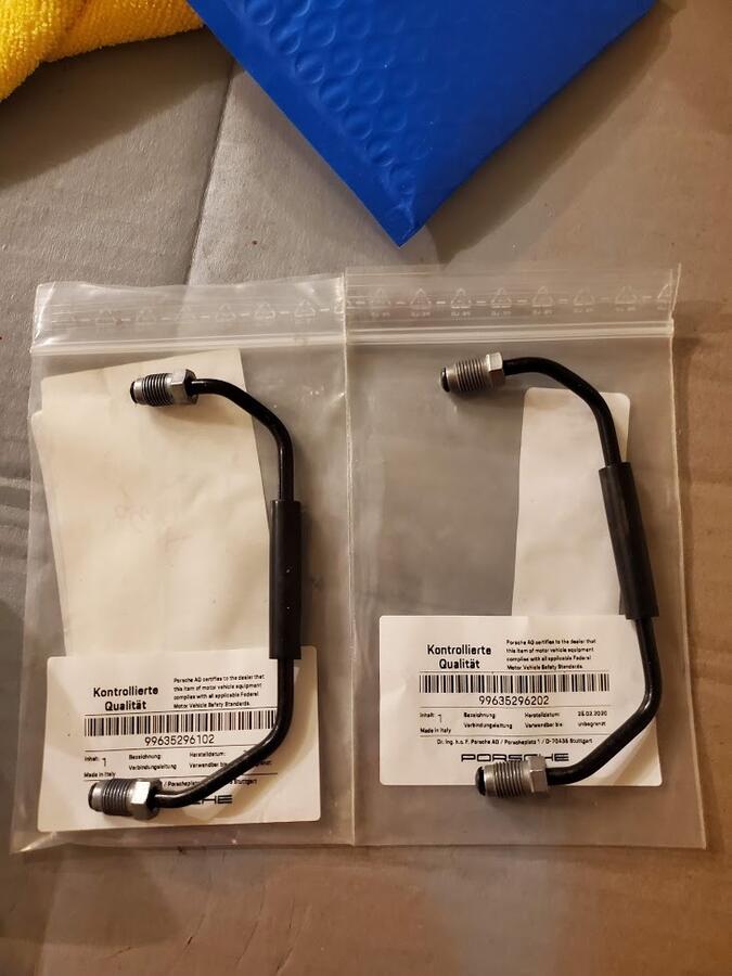

                          Doing this conversion as my quarantine project, and I ordered two rear crossover pipes. However, despite ordering two different part numbers, I received two identical pipes. Can anyone confirm which one of these is wrong?

                          Titaniu//MI just had the same issue as you. Ordered the same part numbers which i thought would be a left and a right but I got two of the same side. Were yours mispackaged or did we both order the wrong part numbers?
                            Give me your caliper part numbers and the vehicle they're from. I absolutely need to know the vehicle because the parts catalogue can be a nightmare. I can attempt to check with my parts department on Monday. Not sure how much help they'll be because generally lines like that aren't sold through dealers. It's worth a shot.

                              Nice exactly what I did.
                                Mispackaged. Only way around this issue I have found is to physically go down to the dealer that has the parts in stock and inspecting the lines in-person.
