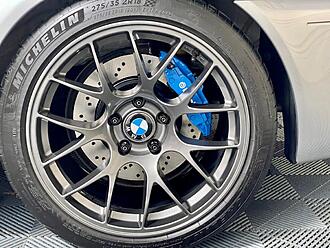

                  My install feels the same way. I went back and re bled the brakes using a power bleeder and actually went around the car twice. My best guess is it has something to do with the master cylinder. I do think the around town performance is very similar but they do better in hard/track use than stock and they look a lot better!!
                  Click image for larger version  Name:	brembo upgrade.jpg Views:	0 Size:	187.1 KB ID:	106199
