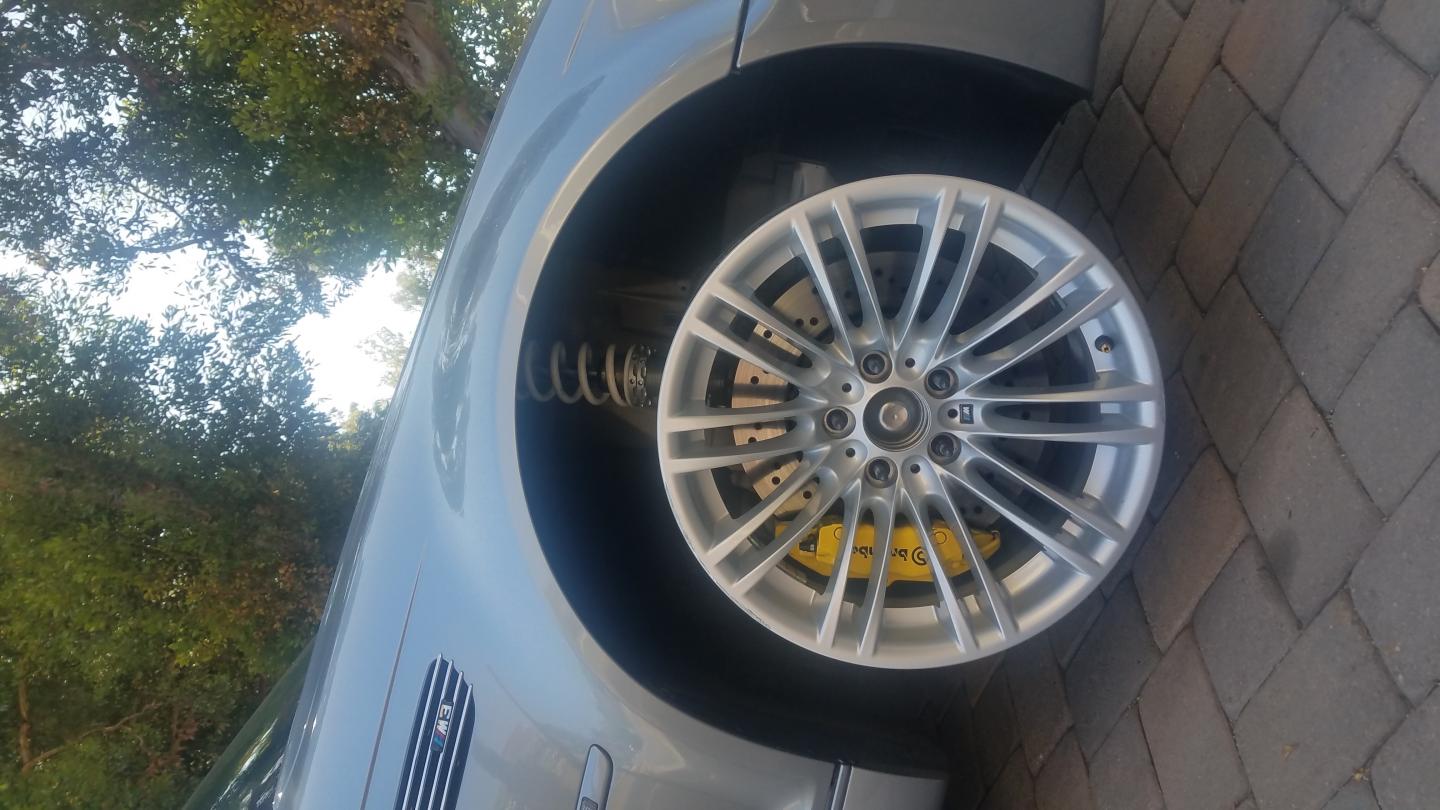

    Just an FYI, E9x 18" et29 260/219 wheels just fit over 996 BBK with maybe 3mm of space. I'd probably still use a 3mm spacer, but it will fit for sure:
    Click image for larger version  Name:	20220724_101902.jpg Views:	26 Size:	140.7 KB ID:	177956
    2mm is generally considered minimum clearance for calipers, so at 3mm I wouldn’t risk a spacer.
      Like I said, you don't need the spacer.
      Adding a 3mm spacer is not a risk. 7-8mm of hub lip is more than enough.
        All spacers are bad spacers :P
          BBS RG-R 18x8.5 et22 — not even close, probably needs at least a 12mm spacer, maybe 15 — and that would put the wheel pretty far outside the fender.
          (Wheels are for my e39 m5 but gave them a quick test fit)

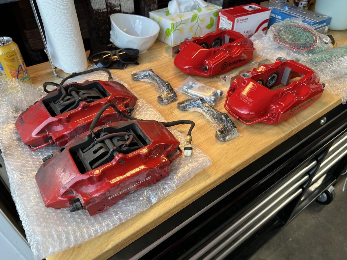

            What was the final consensus on the 500 degree engine block paint vs the 900 degree caliper paint? Getting my ducks in a row to paint these sometime over the next few weeks. I’m begrudgingly doing the brand new Freaky Parts front calipers too because honestly, the bright red Brembo color clashes with my car’s darker Imola red, and I just can’t handle that lol
            '01 M3, Imola/black
              There hasn't been any discernable diff between the 2 paints, for a few years now, as long as you do the final clear coat with the 900 degree caliper clear.

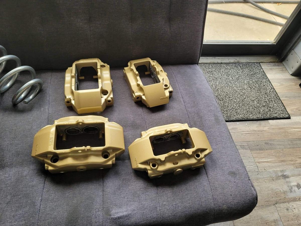

                          Anyone have pictures of calipers done with the VHT gold paint?
                          Also, anyone have photos of the OEM front rotors vs Zimmerman? Curious to see a side by side visual of the different coatings
                          '01 M3, Imola/black

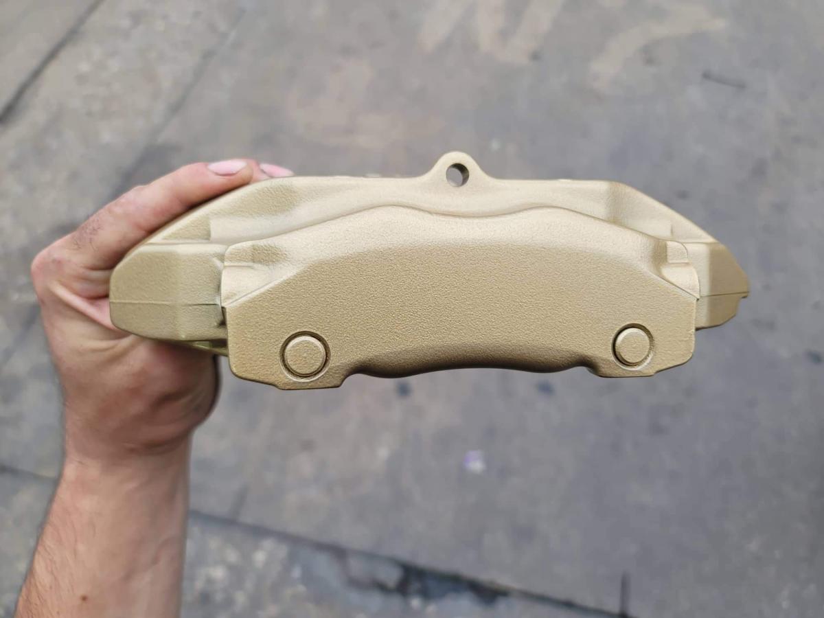

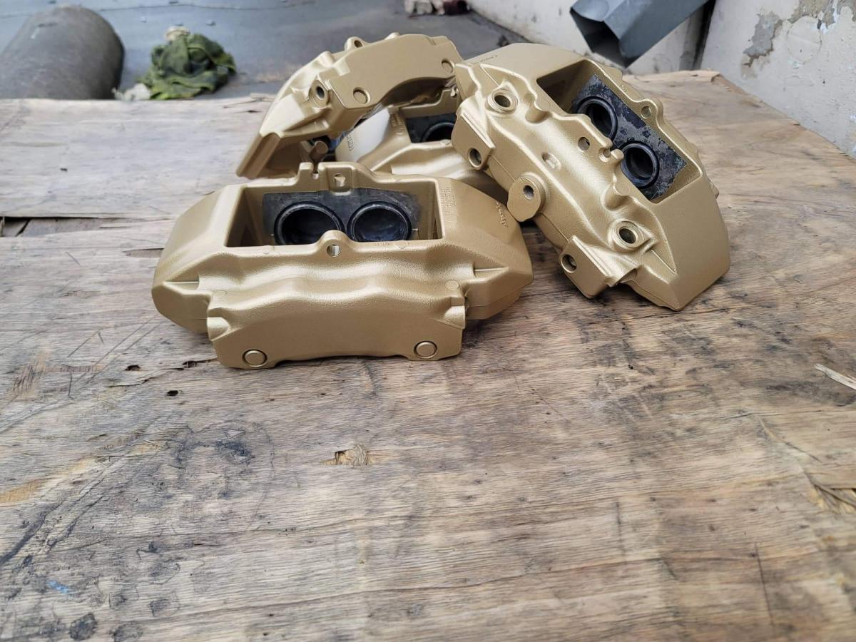

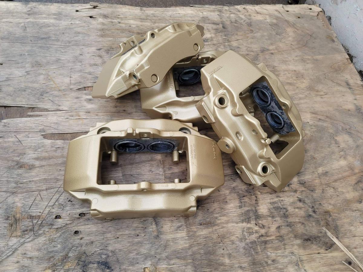

                            No, but did do one set in Waltz Gold (powdercoat)
                            hope that helps
