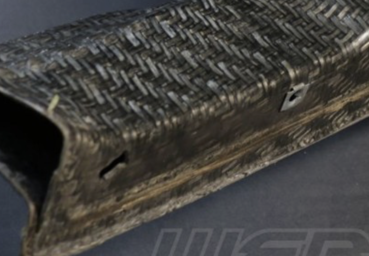

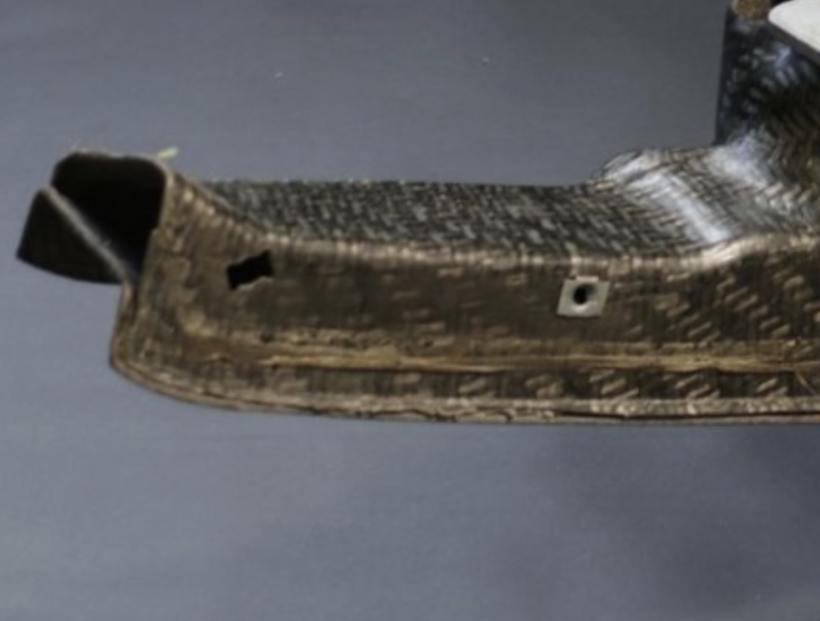

    Real OEM refers to this part here to screw the windshield washer bolts into. But I can’t see how this would clip onto the crash bar. Is real OEM wrong?
    It should be part 07129901748 and plug in to those rectangular cutouts.

          Any spots come to mind? Pretty sure regular e46 reservoir doesn't mount there. Doubt regular e46 kevlar has them.

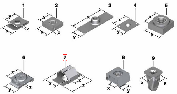

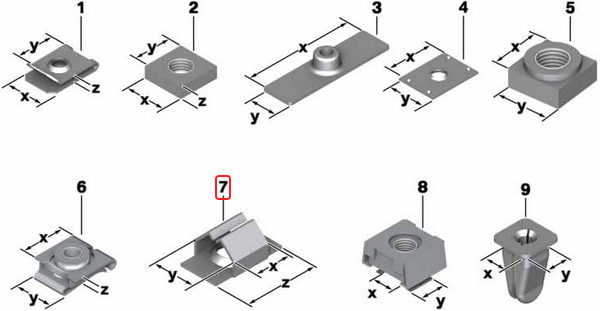

                      Just stumbled on the dimensions for this. On Real OEM 07129901748 (#7) is as follows:
                      X=7.6
                      Y=9.3
                      Z=15

                      For 07129904323, there are no dimensions listed (again for #7)
                        Just based on pictures I think 07129904323​ will be too small to work as a replacement.

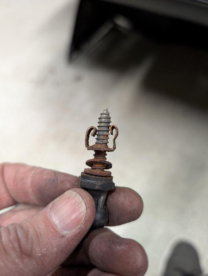

                          The prestol-cage that's spec'ed for the kevlar bumpers (07129901748) is for that sheet metal screw bumper plug: https://www.fcpeuro.com/products/bmw...ce-51117894986

                              Grabbed these from an eBay listing. Lots of them seem to be missing, probably the weight of the fluid eventually fatigues it as your kevlar looks a bit damaged.
                              I would fab a new solution. Use some anchor nuts, or get a small strip of aluminum scrap to slide in the side opening and line up the original holes, either tap it or put rivnuts. You could even epoxy the strip in place. Will definitely hold better by bracing from behind than just hanging off those clips anyways.
