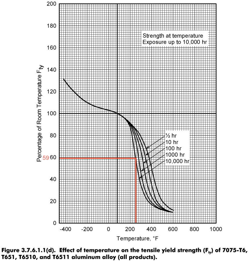

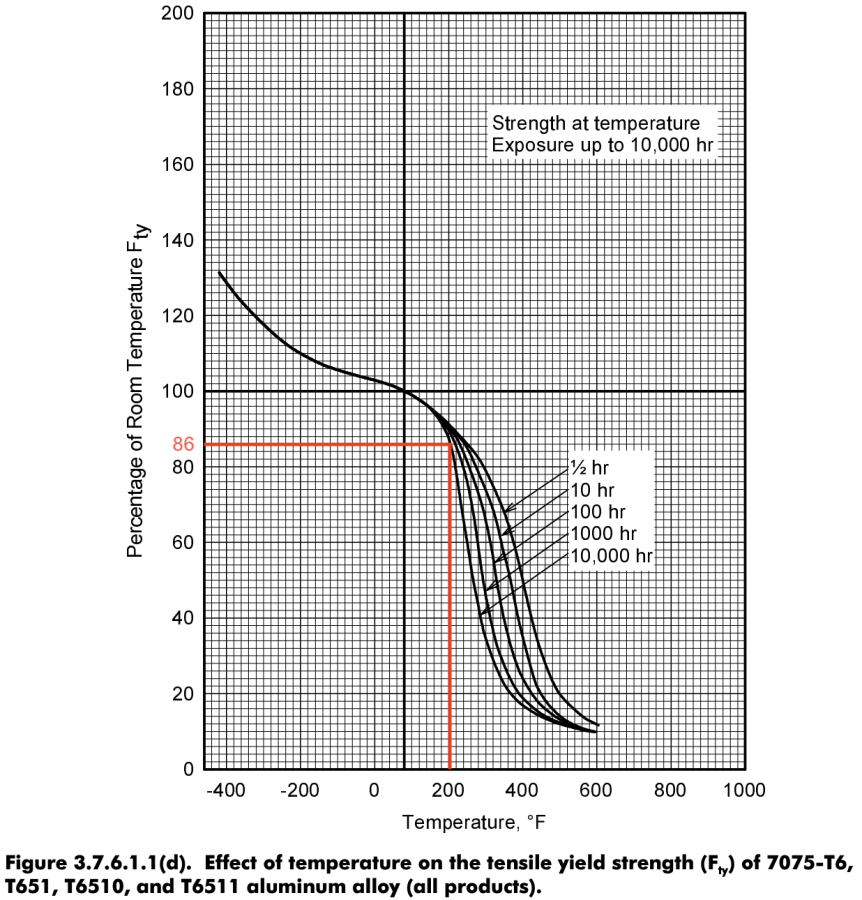

                    karter16, you really got this in my head, so did a little bit of analysis with the help of MIL-HDBK-5.
                    Let's use the 10,000 hr line as the worst cast scenario, even though most of our cars will never see that much extra runtime at temp. Am assuming 503 MPa for tensile yield strength at room temp of 7075-T6.
                    If the part sees 300 F (149 C) for 10,000 hrs, then yield strength drops to 171 MPa or 34% of its original strength.

                    If the part sees 250 F (121 C) for 10,000 hrs, then yield strength drops to 297 MPa or 59% of its original strength.

                    If the part sees 200 F (93 C) for 10,000 hrs, then yield strength drops to 433 MPa or 86% of its original strength.

                    So, at 120 C for 10,000 hours, we're still above the tensile yield strength of 6061-T6 (276 MPa). I really doubt the part will see more than 120 C, but we'll see what the thermocouples say.
                    Even if it does, that's what safety factors are for!
                    According to the analysis, the windshield mount should never see more than 109 MPa (source), which means that even in the worst case scenario of 150 C for 10,000 hrs, that part should still be strong enough. The brace attachment point could fail after extensive high temp exposure, but not too concerned about that one, as it's easily replaceable.
                    But no sense in jumping to conclusions without data. Will keep you all in the loop with the results of my little experiment.

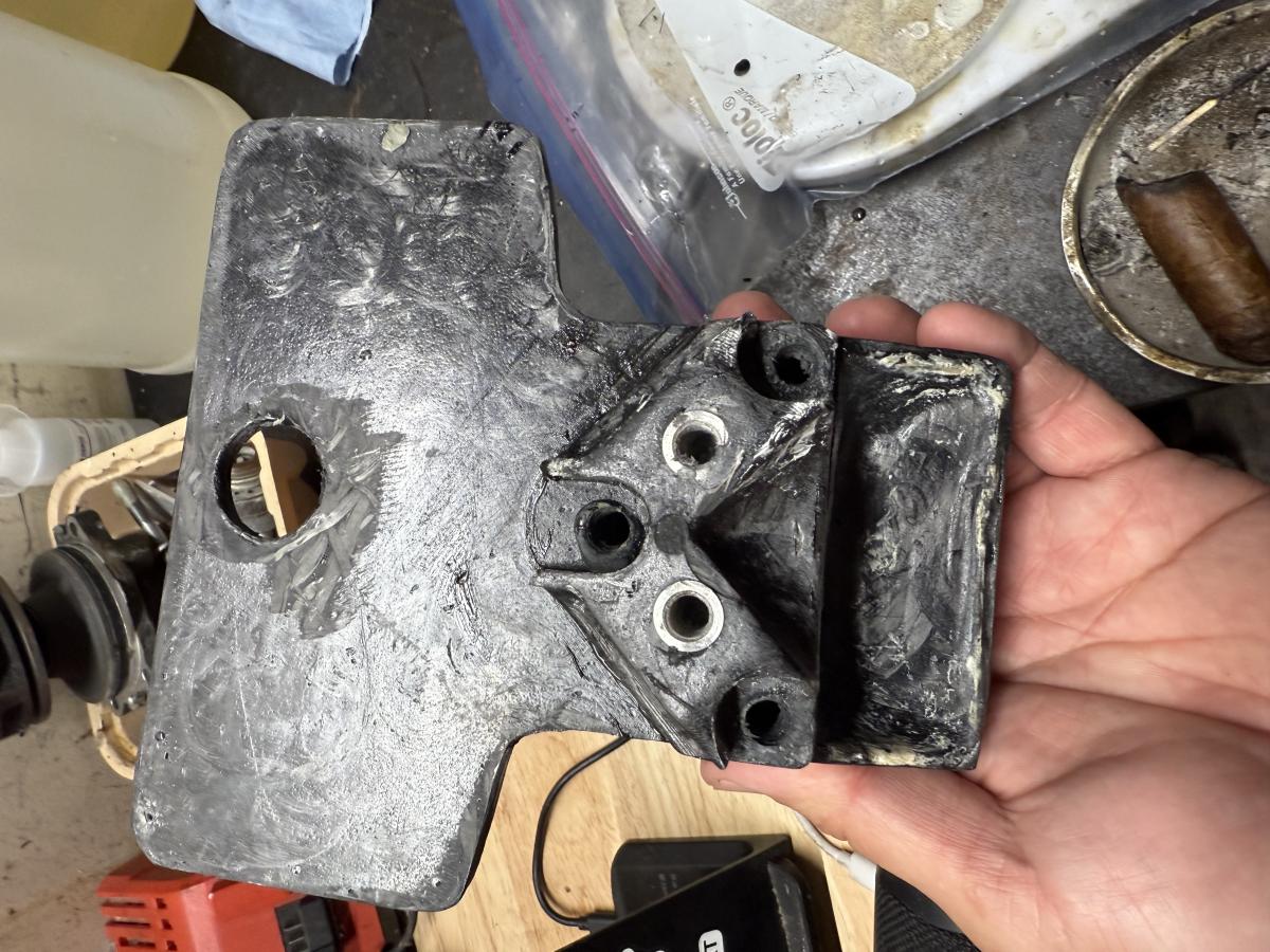

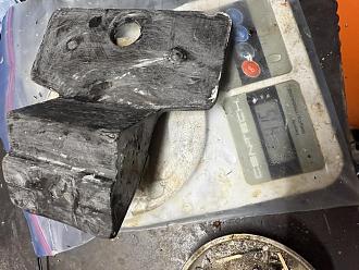

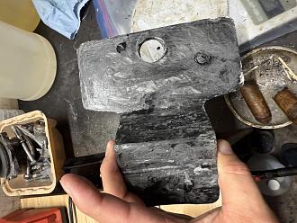

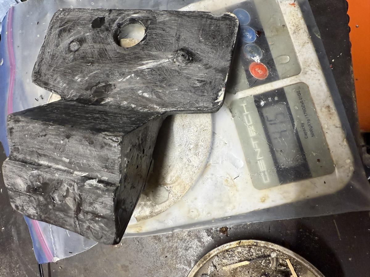

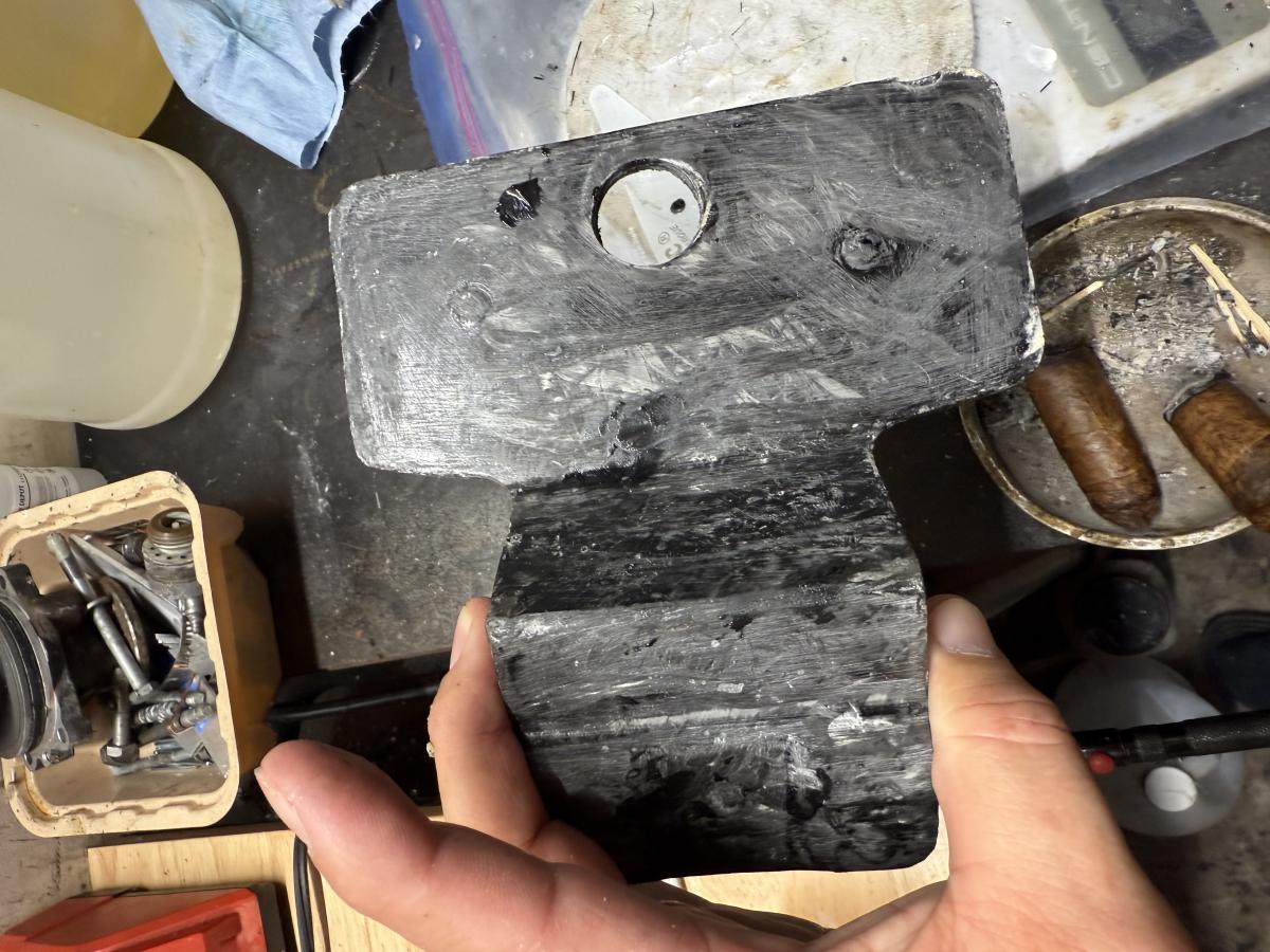

                              My forged carbon part came out to 415 grams - not much lighter than the aluminum part. Guessing it probably could optimize it to shave off 50 grams or so. I think the advantage here is it might be cheaper to produce.
                              I don’t have. blower motor or wipers so this should be much simpler for me. I bonded the parts using panel bond.

                              Still have some finishing work to do. Now on to figuring out the strut mounts and mounting the bars. The challenge here is serviceability. I would like the two new braces to mount under the OEM bar so it is less to remove if I need to remove the intake manifold.
                              I am also going to do the strut tower mounts in long strand forged carbon. I am leaning towards making them thinner like Heinz’s process to fit the 3rd lug so I can make a plate which goes between the cross bar and the strut plates. Then bolt the triangle braces to the plate…like Heinz’s design.
                              Or maybe I mount the two braces under the strut tower plate and run a bolt through…
