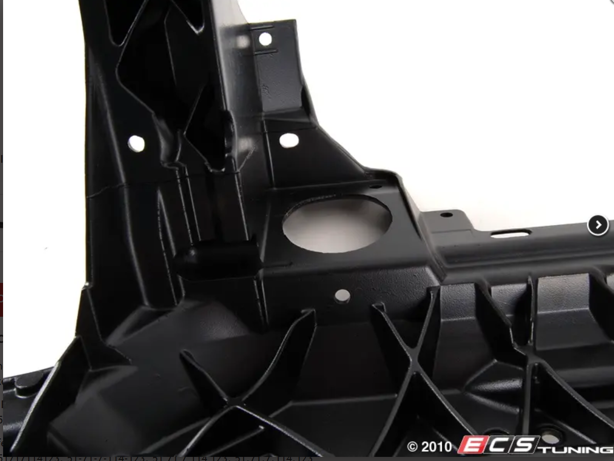

      I've seen a core support from a convertible e46 and it didn't look like the flimsy stamped metal piece like the coupe / sedan, it was much more rigid. Maybe that's an option?
        #93
        Weird..same part part for M3 convertibles and the M3 sedan and non-M except for convertibles...
        RealOEM.com - Part Search
        Here is the convertible part #. Looks like it is plastic with some stiffening ribs on the underside which the metal part does not have. And it only costs $900!
        Click image for larger version  Name:	Screenshot 2026-01-13 104027.png Views:	0 Size:	497.5 KB ID:	339439 ​​

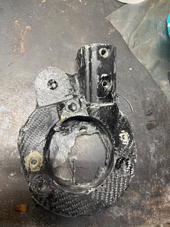

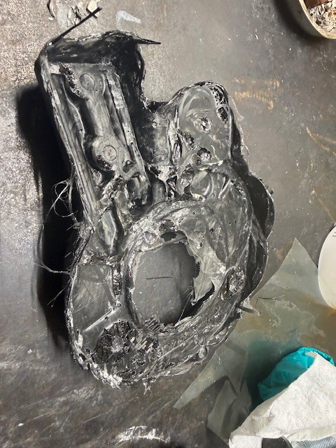

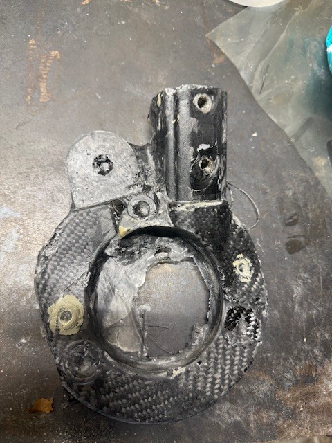

                First CF strut tower plate attempt. Went better than expected!
                To my credit it looks like a strut tower brace. The spot where the triangle brace bolts to...I wasn't thinking and the threaded insert was too deep so that prevented complete closure of the mold. Then I use unchopped carbon tows and it was totally monstrous to work with. There were some details to the part that made it hard to get the carbon into place. The underside of the part is missing some details.
                This part seems to be plenty strong and sturdy enough. I'm thinking I need to build up with regular cloth and then top it off with some chopped carbon.
                Hope to get the firewall mount bonded in this weekend.

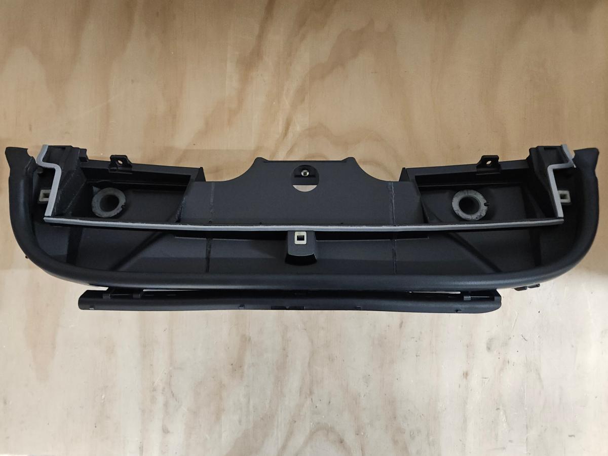

                  Alright I'm calling this project (including documentation!) 99.9% done. Just have two small TODOs to get through before I can call it 100%:
                  1. Weigh the modified cabin air filter housing/firewall plug + a stock cabin air filter housing and add to documentation.
                  2. Sand and paint the strut tower brackets.
                  Documentation and files in the drive are up to date. Most changes revolve around the cabin air filter housing/firewall plug, as those weren't fully finished last time around.
                  Feel free to read through and provide feedback!
                  Couple pics of the newly finished parts:

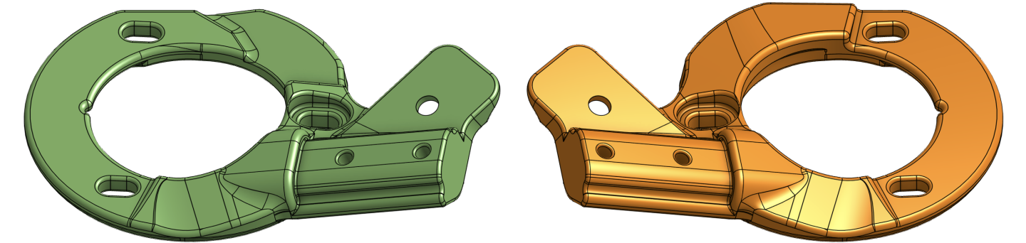

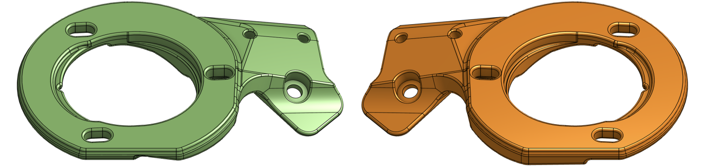

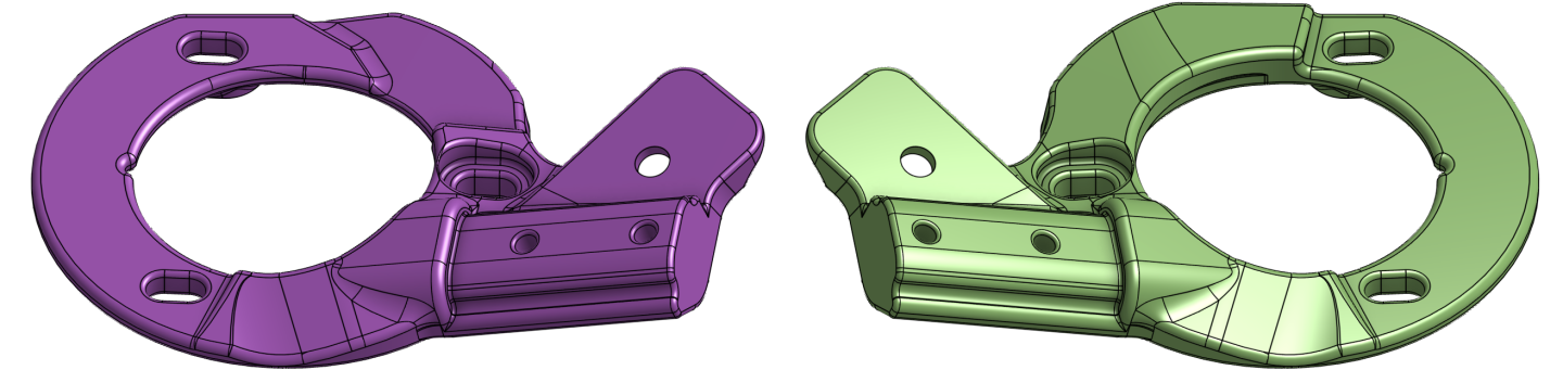

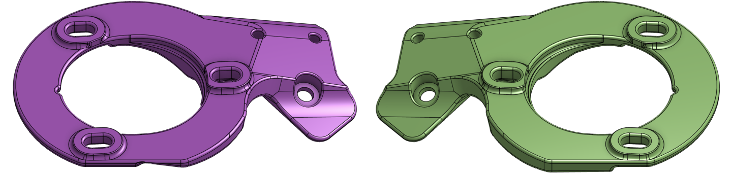

                        More discussion in my build thread, but basically, I remembered I really hate painting. So instead of trying to make the existing sheet metal strut tower brackets pretty, I scanned the stock brackets, recreated them in CAD and then modified them to work with the E86 braces.
                        Here's the (almost) final design:
                        Click image for larger version  Name:	Screenshot 2026-02-27 at 2.05.34 PM.png Views:	0 Size:	310.7 KB ID:	344804
                        Click image for larger version  Name:	Screenshot 2026-02-27 at 2.06.15 PM.png Views:	0 Size:	275.4 KB ID:	344805
                        I also modeled a version with stock-like bosses on the underside, for compatibility with early cars. Still need to test fit these on a real car, but confident they'll work:
                        Click image for larger version  Name:	Screenshot 2026-02-27 at 2.19.33 PM.png Views:	0 Size:	309.9 KB ID:	344807
                        Click image for larger version  Name:	Screenshot 2026-02-27 at 2.20.06 PM.png Views:	0 Size:	271.0 KB ID:	344808
                        (bavarian3, you've got no more excuses! )

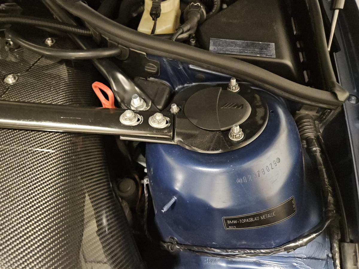

                        And here's an earlier plastic prototype installed on the car:
                        Click image for larger version  Name:	20260225_211858.jpg Views:	0 Size:	166.5 KB ID:	344806
                        Looks sooo much better than the sheet metal version!
                        Plan is to get these 3D printed out of aluminum and powder coated/painted to match the stock parts. Am very excited for how these are gonna turn out.
                        Originally posted by YoitsTmac View Post
                        Where's the “buy now” button?
                        I think the new strut tower brackets will make this as close to a real product as possible!
                        Basically just CNC the windshield mount, print the strut tower brackets, print the cabin air filter housing plastics, trim the E86 braces and install.
                        I'll report back with how the Aluminum prints turn out.

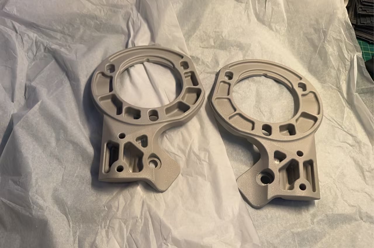

                          Sneak peek from the manufacturer of the 3D printed strut tower brackets:
                          Should have them in my hands within a week or so.
                            They look gorgeous
                              They look gorgeous
                              Yeah I'm super excited about these - loving that I'm going to be able to keep the original M caps as well!
