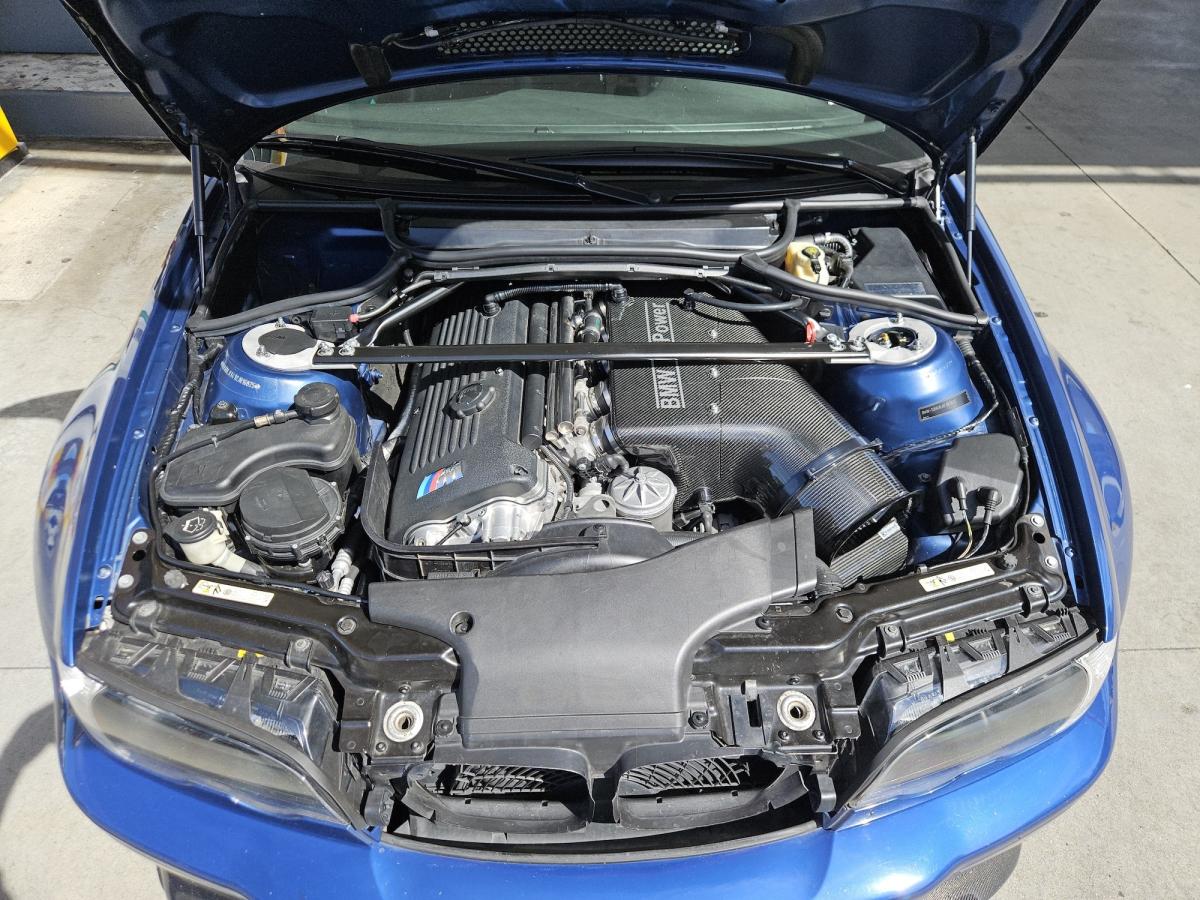

                    Also, brackets are on the car for some validation:
                    They survived a 100mi drive today and the car feels exactly the same as it did with the sheet metal prototypes. Today's drive wasn't all that dynamic, lots of highway stuff, but I'll do some more interesting driving soon. Doing a track day at Laguna Seca (with the infamous bumpy kerbs) next weekend, so that should really torture these parts
