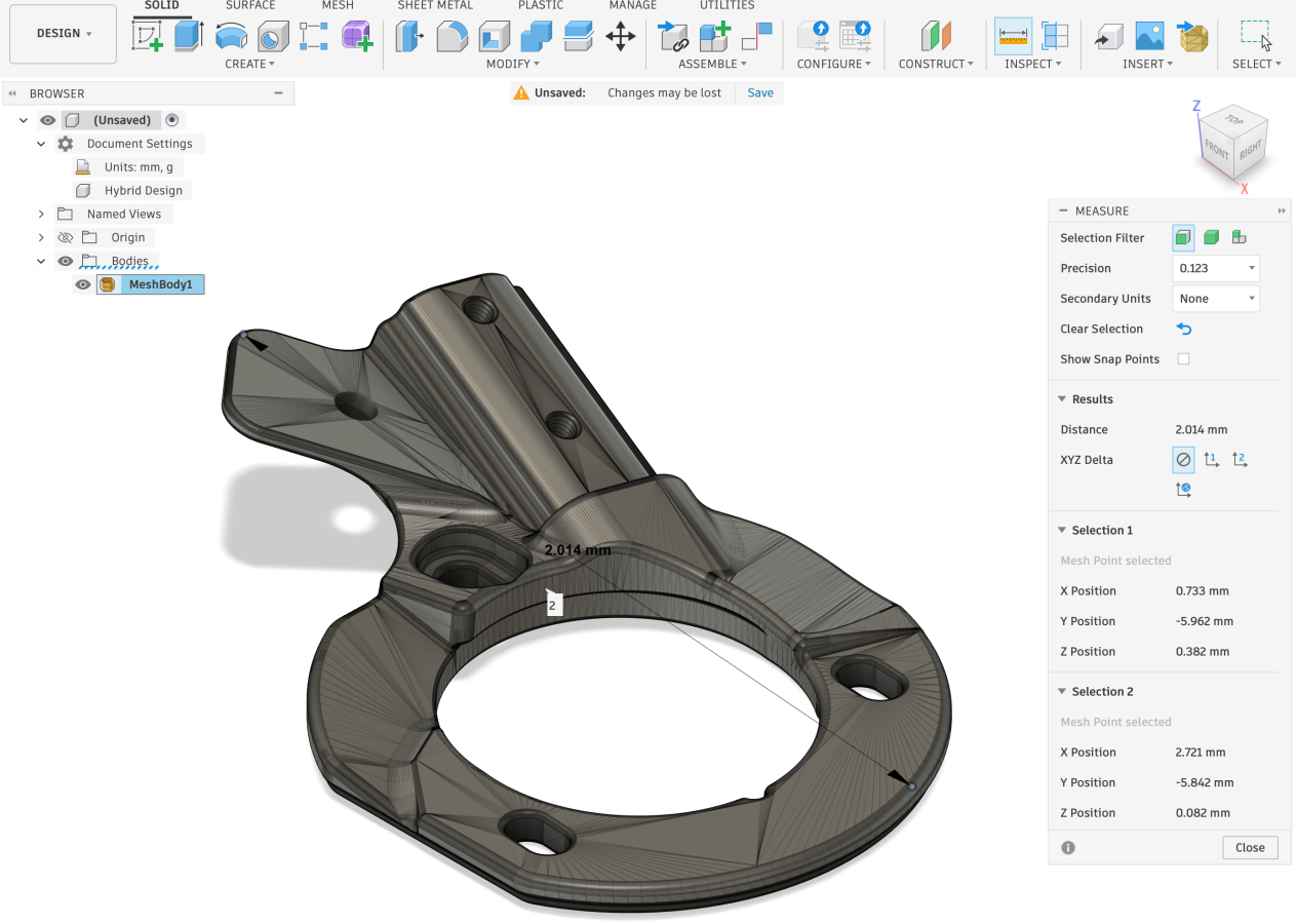

              Apologies in advance if I'm being super dumb, but everything is telling me the STL files you uploaded for the strut brackets have the model as being super-tiny. Do I need to apply a scaling factor to these (I'm guessing it should be about 100x bigger? (dm instead of mm?))

                Hmmm, maybe I messed up the scaling when exporting. Project units are mm.
                Can you try the .step files? They're what I gave to the manufacturer, as most seem to prefer that format.
                The preference feels justified since .step is parametric(ish), as opposed to the jumble of triangles you get in an .stl (decent analogy is .svg vs .jpg).

                  Now I'm doubly glad I asked! would not have thought to use the step file for additive printing! Can confirm the step files come out at the right dimensions :-) Thanks!

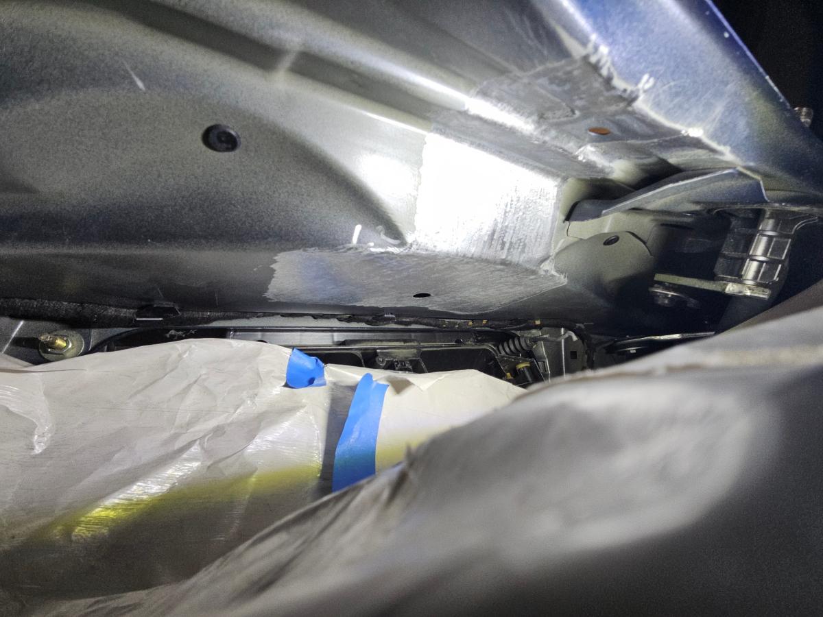

                        Looking back through pictures, I think you can fit a right angle drill from the front with the blower motor out of the way:

                          Actually, George Hill, do you have a cowl handy? Would be interesting to put some silicone mold putty down in between the chassis and the cowl and let it cure. Just to see how much clearance there actually is in between the two parts.
                          Cowl goes above the windshield and chassis dips down below. It's possible there's just barely enough space for a couple hex head bolts.

                            im not exactly sure I follow your idea of bolting. So you mean drill through the cowl and insert bolts from the top down? The head of the bolt would sit under the cowl trim?
                            I do have a cowl here. Actually I think I have an old one too I could probably section so we can see what the clearance is.
                              Yep! Exactly.
                              If you go the opposite direction, you'd end up with a rivnut (or the end of a rivet) in between the cowl and the chassis. I don't think there's gonna be enough space for that.

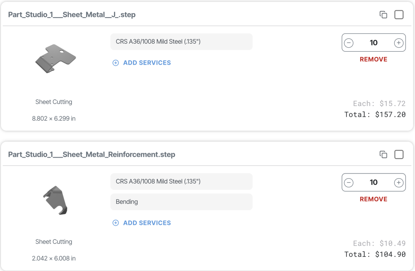

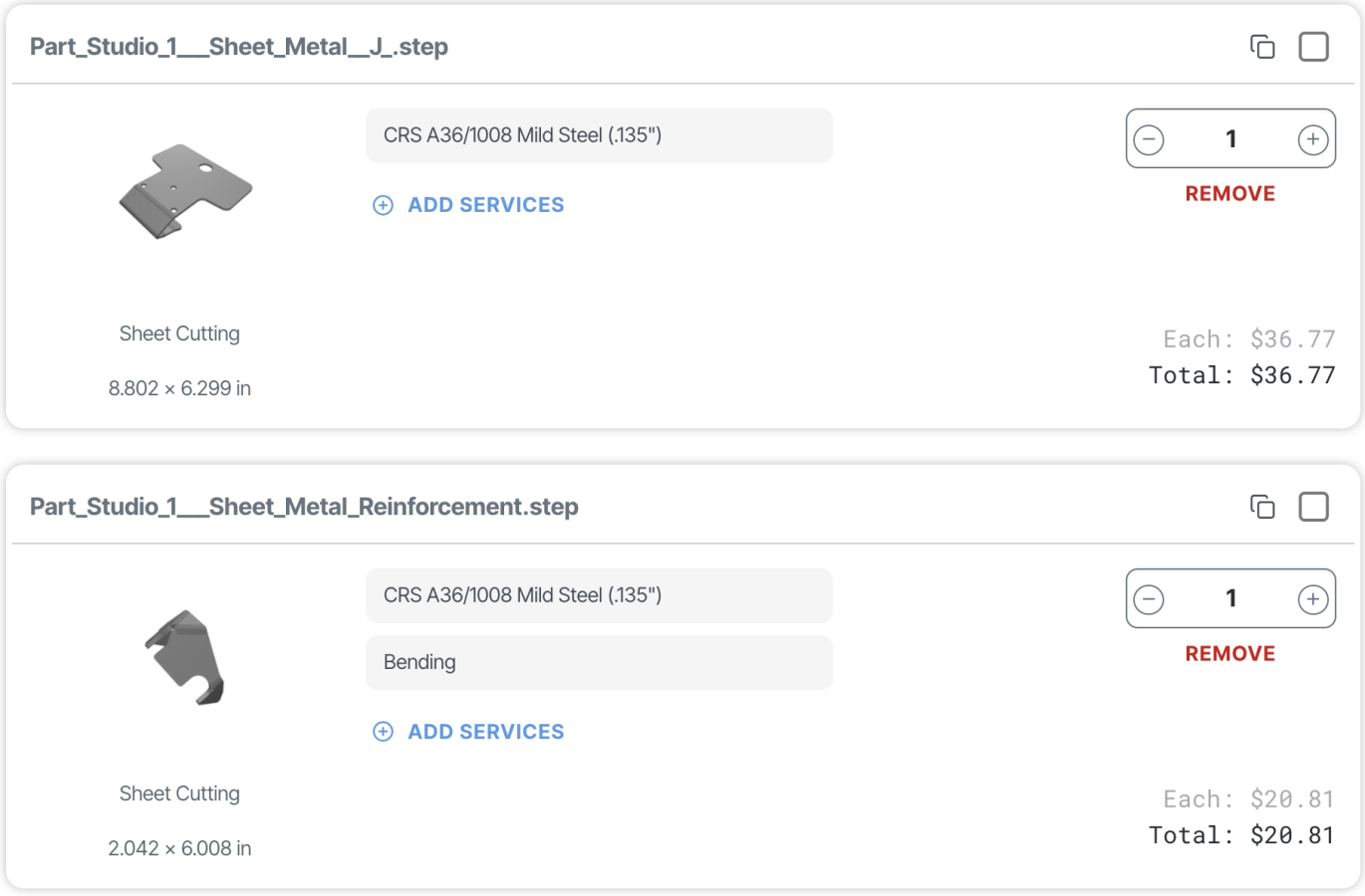

                                Also, I was curious, so I quoted the parts on sendcutsend. 7075 isn't really bendable, so I quoted in mild steel:

                                Price for one set is $57.58. Here's the same parts, but in higher quantities:
                                Drops down to $26.21 per set if you get 10 made. Downside is that post welding, rivnuts and powder coating, you're looking at almost twice the weight of the 7075 machined version.
