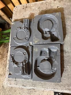

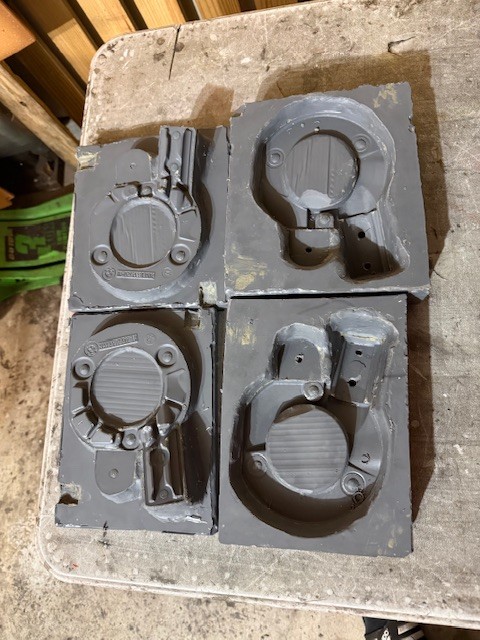

        Mold is almost done. Have to do some minor repairs and clean up.

            Absolutely. Or someone can make a mold of a modified plate. The question is how to produce a part even if it is 3D scanned. Heinz's process of modifying and adding to an OEM plate I'd guess is less costly than making a whole new part.
            I think Heinz's part looks 95% OEM. I'd give it a 99% if everything was painted black.
            Just to be clear, I deleted the cabin air filter housing a long time ago. So the tab I molded in for the extra bars probably won't line up with the modified cabin air filter housing parts.

                    I didn't take it as a knock on the design. I'd like to see someone analyze a carbon part and engineer the layup to improve the strength. Especially how to secure the bars to the part.
                    I am using some knurled threaded inserts. The carbon/epoxy is compressed against the inserts so I think it should hold up to being torqued, twisted, and stressed. Would be nice to have some idea on whether this will actually work before live testing it.

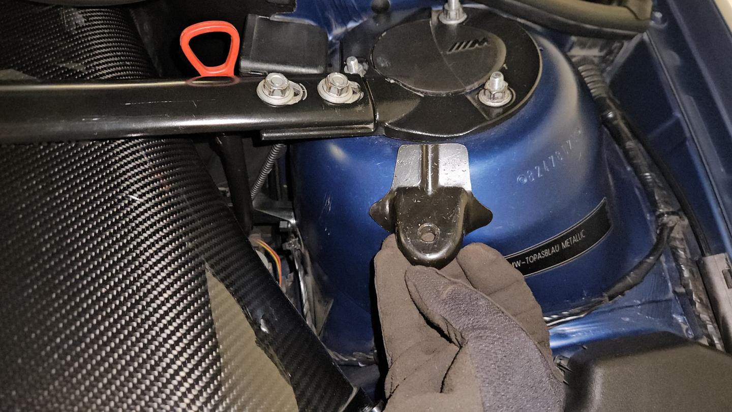

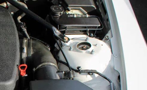

                            Is there space in the E46 engine bay to weld an additional bracket onto the strut tower like the Z4 had originally?Click image for larger version

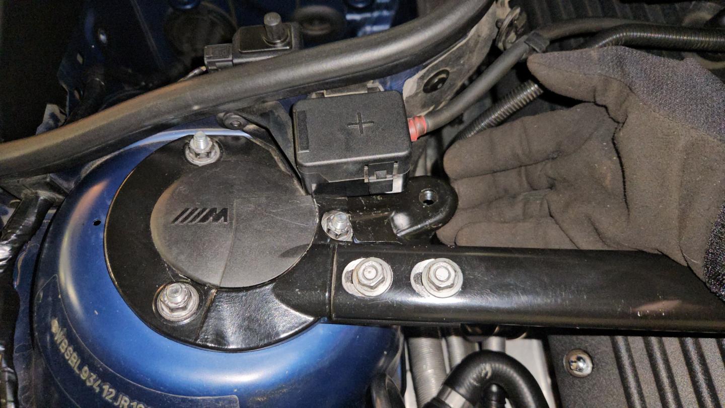

                              Originally posted by ___LUNK View Post
                              Is there space in the E46 engine bay to weld an additional bracket onto the strut tower like the Z4 had originally?Click image for larger version  Name:	Capture.jpg Views:	0 Size:	35.1 KB ID:	333045
                              That was my initial idea and unfortunately it requires even more work. The corner bin firewall divider things, the strut tower brackets, the engine harness box and the jump start point all get in the way:
                              Click image for larger version  Name:	20250329_185929.jpg Views:	0 Size:	207.8 KB ID:	333058
                              Click image for larger version  Name:	20250329_185921.jpg Views:	0 Size:	171.4 KB ID:	333059
                              I did, however, notice that they fit pretty great if you put them pointing forward:
                              Click image for larger version  Name:	20250329_190149.jpg Views:	0 Size:	184.5 KB ID:	333060
                              Next up: triangulation to the core support? Food for thought...
