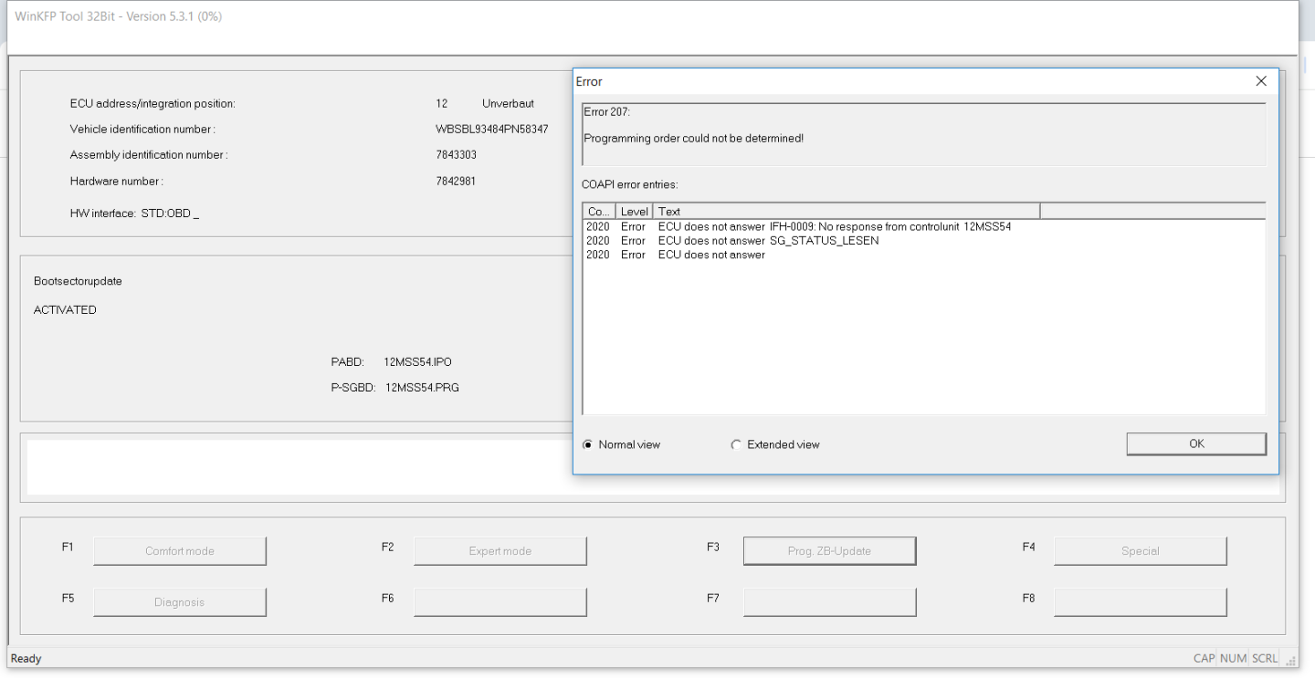

            Finally have some time to work on this again, I tried re-programming via winkfp, the DME is able to identify itself and report the old VIN of the car it was taken off of (I BDM the stock image back on) but then when WINKFP goes to actually start updating it it gives the following error. Comfort mode -> Update ZUSB -> MSS54 -> No vin entered -> Done -> Program ZUSB update. I know its been a while but any insight anyone could give would be great! Been running the stock Alpha N tune and its getting to me a bit lol.
            One note, the ECU seems to be more functional than it was before, it now properly reports the temperature and RPM of the engine to the gauge cluster but doesn't show the check engine light when turning the ignition to the second position (which I believe it does do on my normal ECU).

              Not a winKFP expert but I'm pretty sure that bootsectorupdate should not be active.
                I don't think it makes a difference for ECUs that don't have 0ba files anyway
