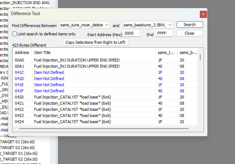

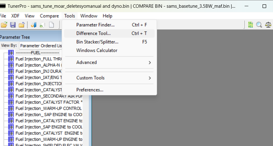

      Also maybe this will help people validate or compare. I didn't know this until recently, but there is a tool that will tell you all bytes edited in Tunerpro. Make sure you have a bin and a compare bin selected.
      Can do Control + T, or go to Tools and it's called "Difference Tool".​
      Click image for larger version  Name:	image.png Views:	0 Size:	128.1 KB ID:	340974
      Click image for larger version  Name:	image.png Views:	0 Size:	167.3 KB ID:	340975
      It will allow you to go through and tell you what has been changed without going through things one by one. Must be the same software version for the files you are comparing.
