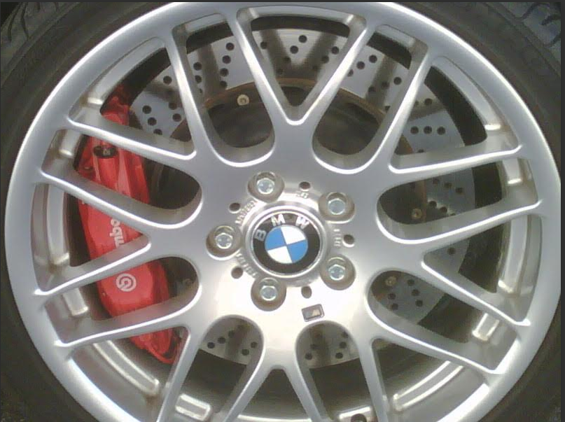

          Here's my 380mm / 4pot Brembo GT on OEM ZCP fronts. Had to utilize 20mm spacers.As you can see it's a tight fit, but does clear.

            I was this close to ordering a set of EBC 6 piston BBK fronts. Was going to just pull the trigger, bc “no way should I need more than a 12mm spacer.” Good thing I decided to print out the template, bc nope… need 20mm spacers at minimum. So disappointing, I think I am just going to rebuild my comp brakes instead.
              #36
              Get an 18MM spacer in the front. Rears will have ample space and will only need a spacer if you want a more filled out look.
              20MM is the absolute max up front. I ran a 20MM with my 8" ZCP's. It was at the limit, and I could feel the feedback in my steering wheel.
              25MM would be nice if it did not come at the expense of scrub radius and the wheel bearings.
