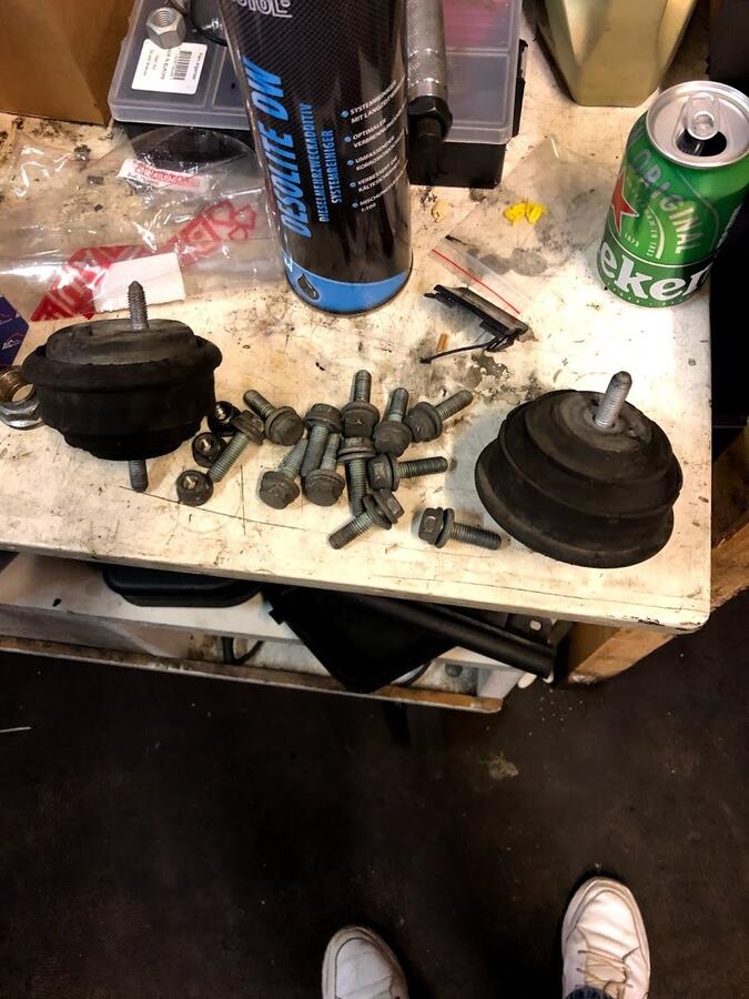

      Just replaced mine with some Cortecos today. They old ones appear to be original at 159k. I certainly feel the improvement and it is as smooth as I have ever experienced.

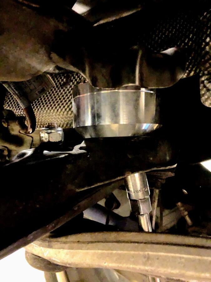

                            I installed the Vibratec Street. But I think that the idle is a bit rougher.
                            What idle speeds have you set? I have 900 RPM ...
