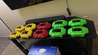

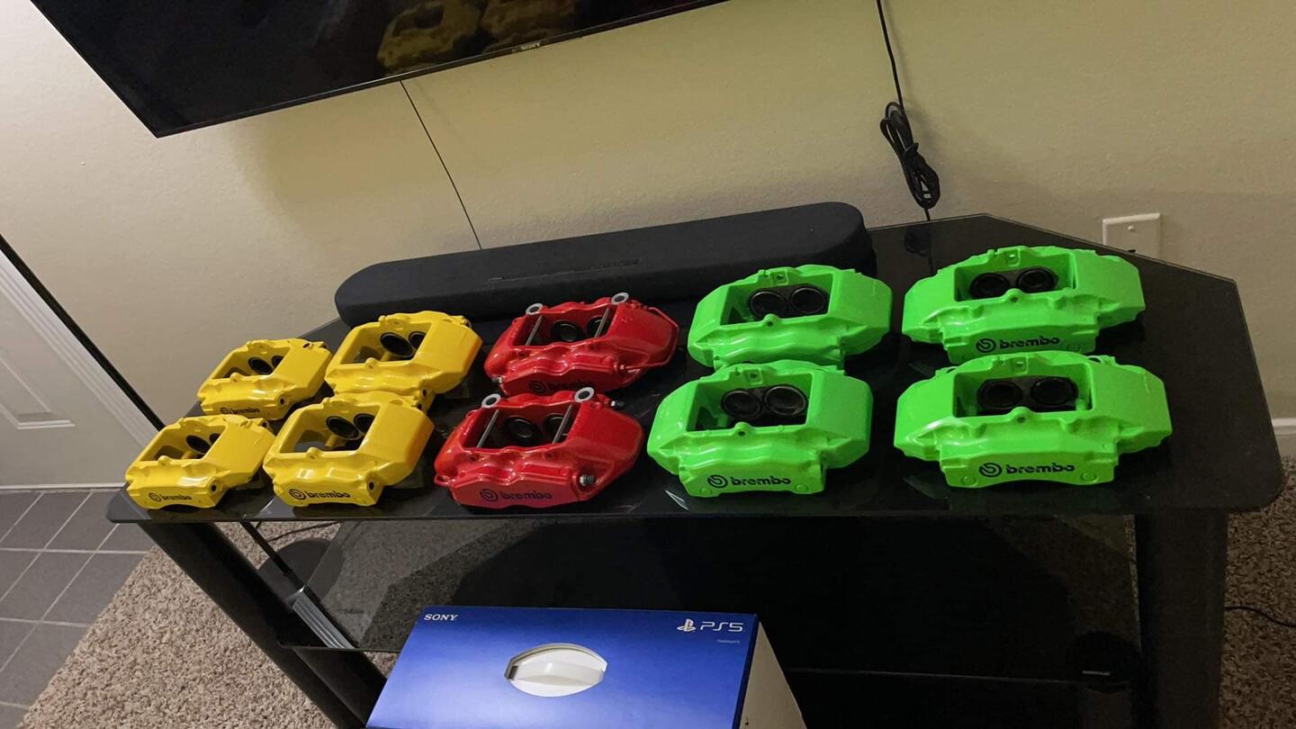

                I’m going 996’s, until I got buildjournals Renault/996 setup (the red in image)
                couldn’t pick a color so I did multiple options lol, selling the others now
