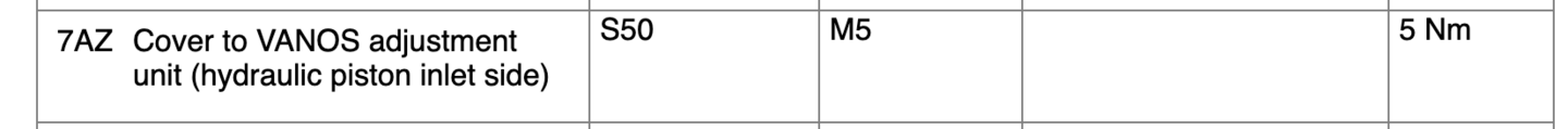

        I'm not sure if someone wants to verify this before adding to the PDF, but I think I found the torque values for the oil pump send and pickup tubes. I remember bimmerfan08 broke one of the M5 bolts trying to torque it to an approx. value. After cross-referencing the two bolts, I saw that these bolts are also used on the E36 and other E46 models.
        According to the TIS for the E36 and E46, the M5x16 (number 6, pn 07129903041) is 5NM and the M6x16 (number 11, pn 07119904524) is 10NM.
        S54 oil pump is on page 49.
        The TIS seems to also state to wash and oil the replacement M10 rod bolts before installing.

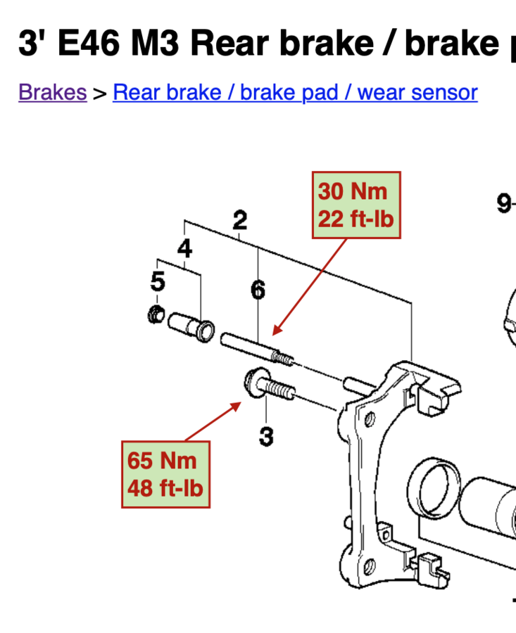

                        Is the torque value for number 3 in this picture correct? I don't remember have any struggles removing these bolts and 74 ft/lbs is high. I tightened them to 59 so if I was wrong I need to retorque.
                            Thread dig but I thought I'd confirm this as I was checking up a few. TIS agrees with the diagram. Should be 100Nm / 74 ft-lb
                                Just for clarity, 64Nm and 52Nm is the standard E46 M8 bolts torque rather than M3's M10 bolts, so the diagram is correct.
