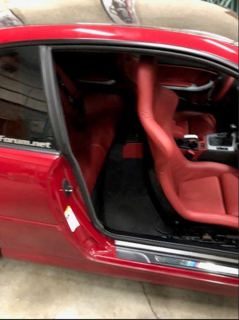

              That'd be nice. I think Ian needs to be more honest/realistic about the lack of back seat access (yes, I know it's a fixed back bucket). It's a joke. Esp for a bigger guy. I'm tall-ish, but slender, and I still have to contort my body to slide in. I cringe as I rub against the b pillar fabric or door panel leather or headliner. I don't do it often at least. I can't image the less reclined bolting position makes a huge difference.

                  #68
                  Thanks for that pic.
                  Did you modify the rails by any chance?
                  I know for fact the Sedan/touring rails allows more leg room at the opposite direction.
                    #69
                    I did not modify my sliders, but they are (manual, though I don't think it makes any difference) sedan sliders, with the seat in the less relined of the two positions.

                        The recline is based on the bolt hole on the side mount that you use, not the slider. The "correct" (per cobra) seat mount orientation is the head rest portion of the buck to be vertical, which is the less reclined hole on the seat mount-- so this is actually the "correct" position for the seat. That said, it's also more upright than most people are used to

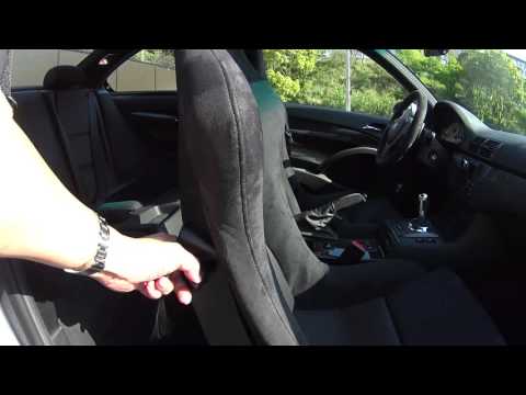

                          Gotcha. I'll have a set of manual coupe rails I'll look at on the weekend. I think more space can be achieved with a very simple modification.
                          Btw this how much room CSL seat have if anyone is interested.
                            #73
                            Ha, I needed that exact video in a thread the other day, but couldn't find it. Just added it to that one :P
                            I owned the CSL mounts and was originally planning to use them, or have BK copy them... but then they didn't add a useful amount of back seat access, and resulted in the seat being significantly higher. The problem is that, with a fixed back seat, the headrest and ceiling height of the car limit how useful the tilt forward functionality is.
                            I'm interested to see how your slider modification project goes-- please update after you try it!
