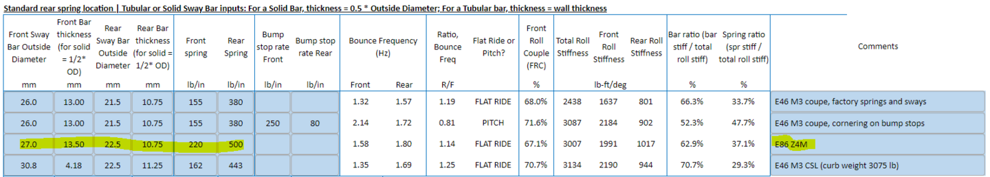

          Who knows, the benefit they have is the ability to be rebuilt, that is why I am looking at them. They seem to work out of the box according to the EU community, but the plan is to have them valved to my setup. Down below is what I have in mind for a fast road setup. Thoughts?
          The Z4M comes with the CSL rear bar and a 27mm front bar. I could upgrade the front but since I don't track the car I may be fine with the stock bars. the CSL front bar would leave me right at CSL numbers for FRC should I see the need to upgrade. Z4M and M3 bars are interchangeable.
          The below numbers consider:
          stock front springs
          linear TCK 500# rear springs
          Bilstein B6 (ideally re-valved by FCM)
          Fronts spring rates were measured by someone in a spring tester, so they should be accurate.
          Since I am fine with the stock ride height I see no detriment there, in fact, my current H&R coils are set almost at stock ride heigh values
          Current RH (606mm front, 600mm rear) - 14.85in front, 14.6in rear in US Speak
          Stock RH (607mm front, 594mm rear) -

            ^ that certainly looks like it'll ride and handle well-- if the shocks have enough bump travel to function.
            (to be clear, I'm not saying they don't-- I'm saying I don't know. The TCK Z4M setup I installed really didn't at anything lower than ~stock ride height)

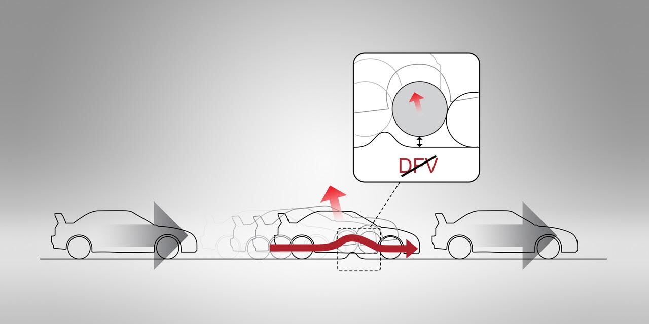

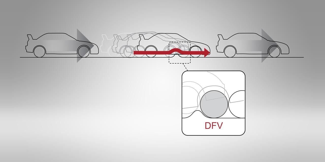

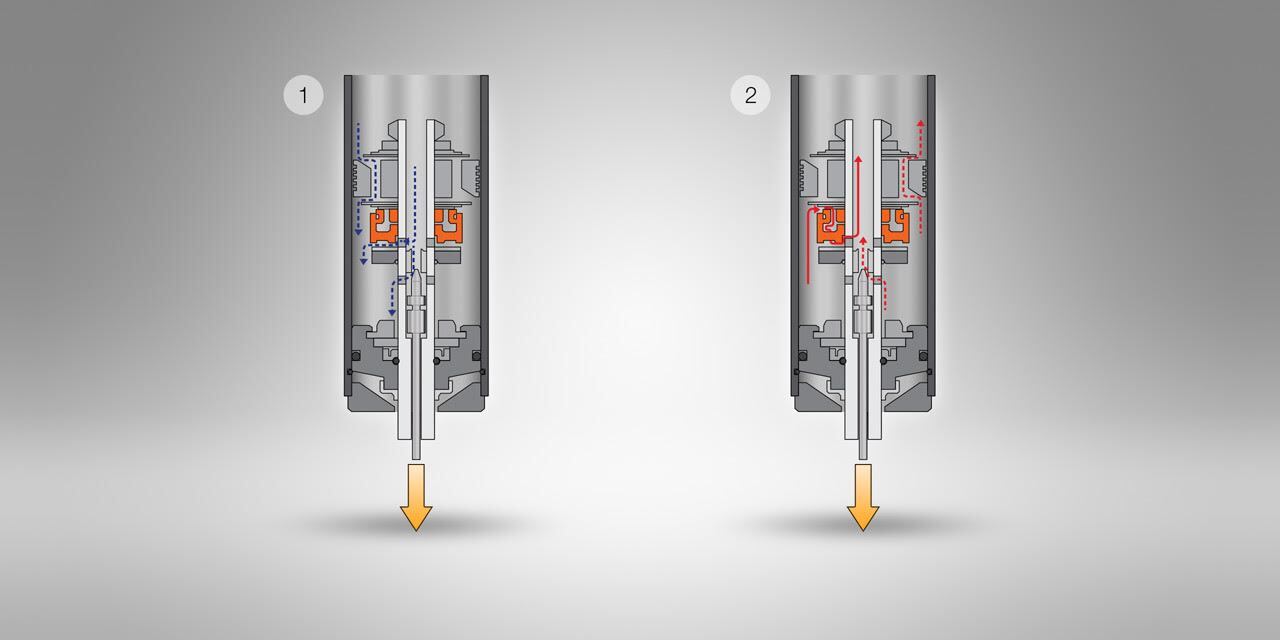

                It's a high velocity blow off valve-- so when you hit a bump the shock just opens up and lets the spring absorb it and rebound.
                Similar, but hopefully superior, to Ohlins
                Originally posted by Ohlins

                Figure 1: (Compression flow) At low shaft speeds, oil flows mostly through the shaft jet bleed (lower dotted arrow). At higher shaft speeds, oil flows mostly through the compression ports in the piston (upper dotted arrow). At very high shaft speeds, or during sudden shaft accelerations, oil can also escape through the compression ports in the DFV, increasing comfort.
                Figure 2: (Rebound flow) At low shaft speeds, oil flows mostly through the shaft jet bleed (lower dotted arrow). At higher shaft speeds, oil flows mostly through the rebound ports in the piston (upper dotted arrow). At very high shaft speeds, or during sudden shaft accelerations, oil can also escape through the rebound ports in the DFV, maintaining tyre contact with the road.

                Figure 3: (Vehicle – no DFV) Without DFV the oil can not flow through the piston quickly enough on the rebound stroke after hitting a bump, so the tyre is not able to stay in contact with the road.

                Figure 4: (Vehicle – DFV technique) The DFV valve opens, letting the oil flow quicker through the piston on the rebound stroke after hitting a bump, enabling the tyre to stay in contact with the road.
