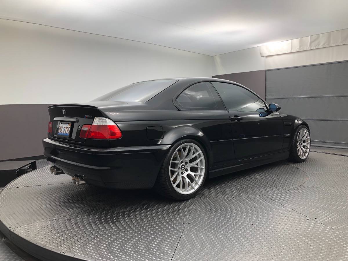

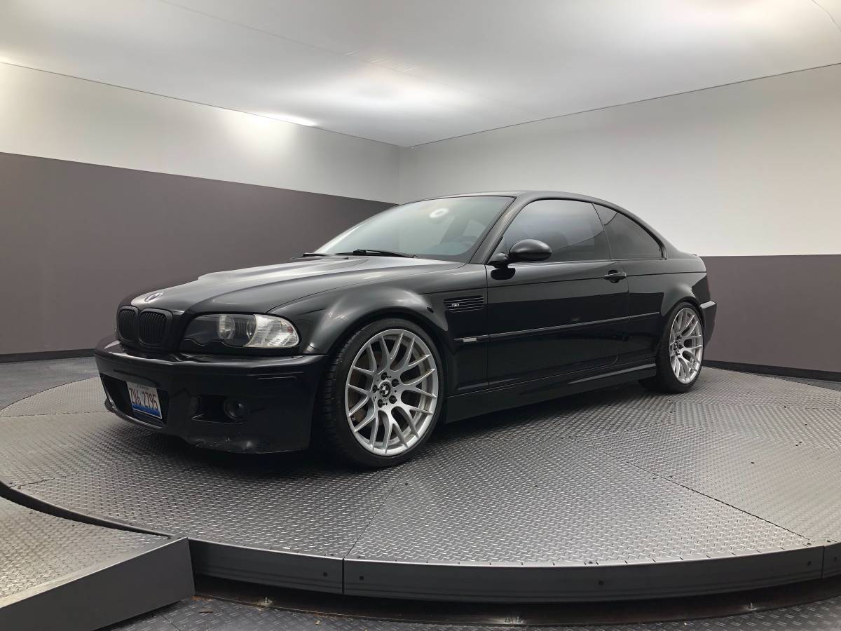

                            Here's my current setup:
                            Click image for larger version  Name:	01515_iC6nYUFhep9_1200x900.jpg Views:	0 Size:	123.3 KB ID:	5509
