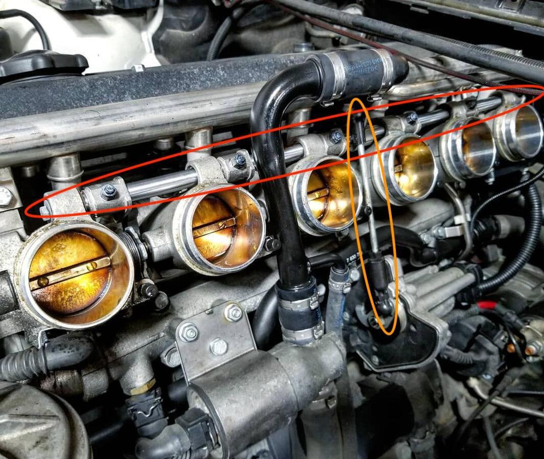

              You want to make sure these parts are unobstructed. They're visible from up top without removing anything on the engine.
                Check if any of the throttle linkages are obstructed. Then change the TPS next to the oil filter housing first, then the gas pedal, and finally the TPS under the intake manifold. Had the same issue on mine and it was the TPS under the intake manifold.
