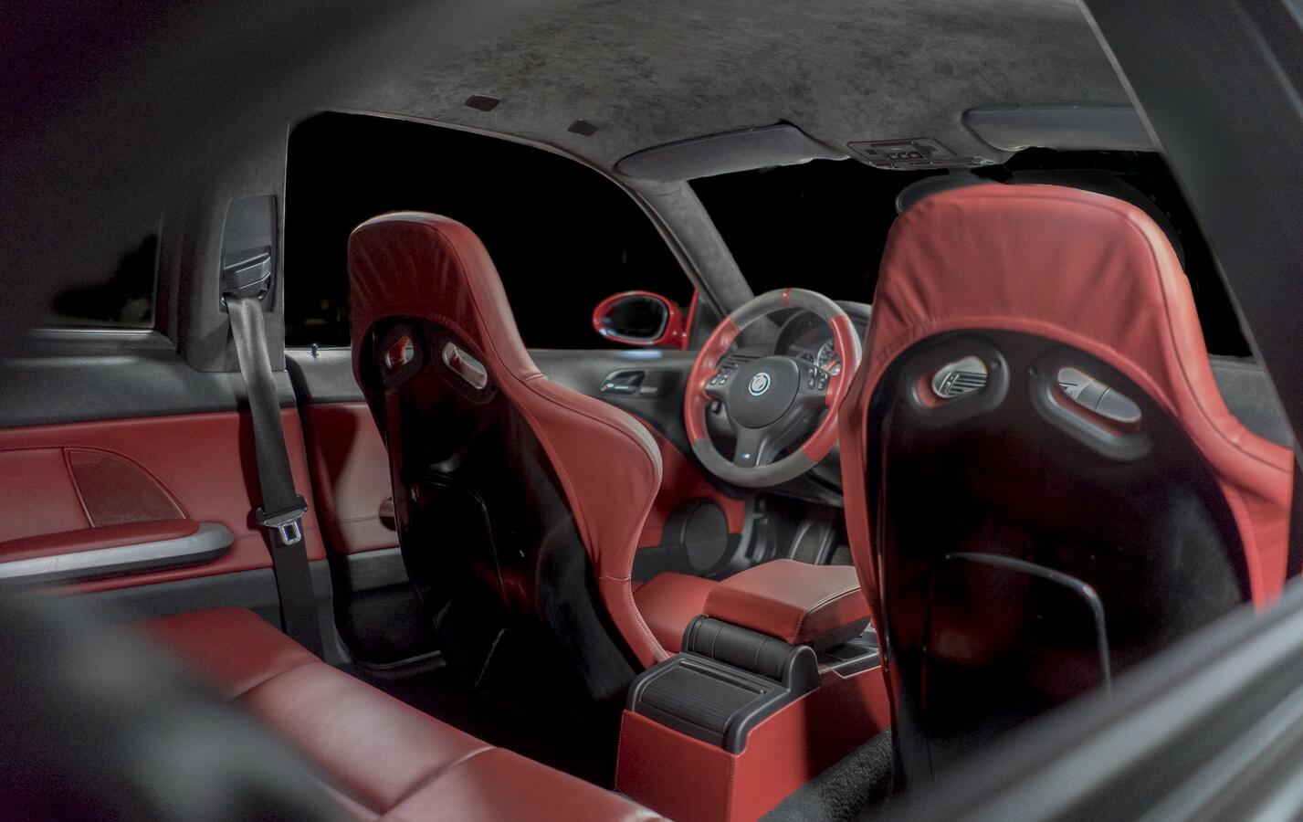

        Click image for larger version Name:	CobraN-14.jpg Views:	0 Size:	113.4 KB ID:	61896
        I still need to figure out something to do about the sun visors, but at least the airbag stickers are dealt with...
        Steering wheel has since been changed to full alcanatara.
        Did the 3 yard cover enough to also do your visors?
        Is 2 yards good enough to do just headliner?
