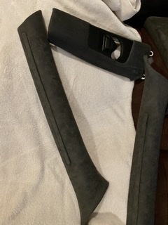

    How does the thin screws cover on the A pillar look wrapped?
      #47
      Pretty decent. In my photo they are not locked into pillar. If you end up using foam backed Alcantara on the pillars you'll need to remove the foam from around this area before or it'll probably be too thick.
      As you're probably aware the thin cover strip has very delicate tabs that lock into the A-pillar. These break taking it on/off over time. If yours are bad just buy new ones, grey ones are $20 each from ECS, or $25 each from FCP Euro w/Lifetime warranty. Since you're covering them anyways figured go for the cheaper grey interior ones as black ones are slightly more expensive.
