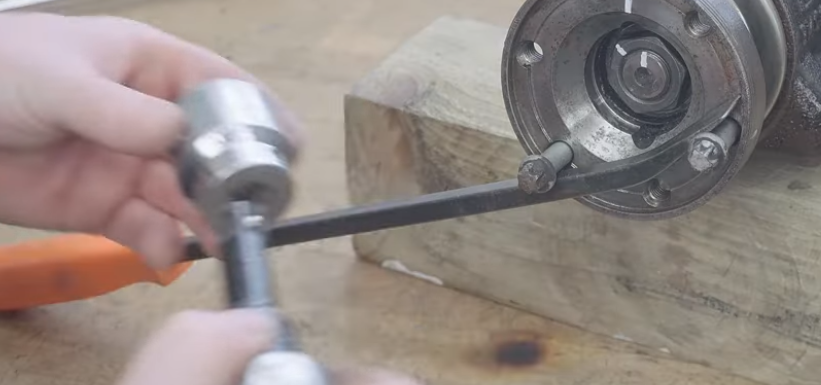

          Will I be able to replace the pinion shaft seal with the differential outside the car if I don't have a large bench vise?
          I am going to answer my own question. Yes, just did it on a bench without a vise, easy. Here is your brace to break it free.

                I did the exact same earlier to my pinion flange, was a pain trying to keep it steady on my workbench until I made more space. Similarly had a hell of a time trying to remove/re-install the driveshaft U-joint bolt, and had to have it on the floor with a pry bar through the U-joint.
