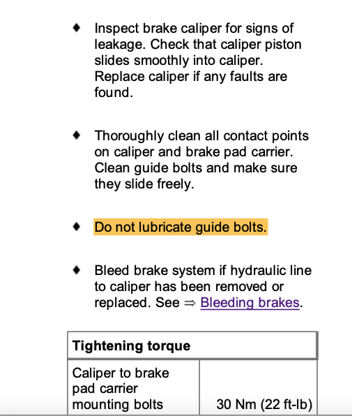

                            It's not 100% a "dumb question" but it's a simple one that doesn't deserve its own post.
                            Why is the Bentley advising not to lubricate calliper pins? Does anyone know the technical reason for it?

                              Ask Siri for a good answer ๐Ÿ˜‚

                                I think the community consensus was that the lube would cause the rubber guides to swell up a bit and actually increase friction. No idea if thatโ€™s BS or not.
