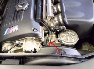

                    Does anyone know the part number of the wire retainer by the engine lift bracket on top of the coolant thermostat housing?

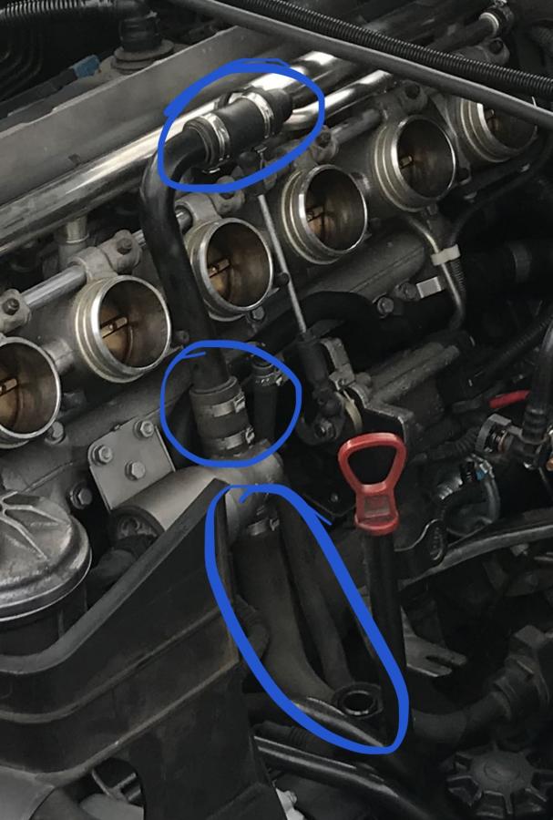

                              Two dumb questions…
                              1) Could I use a silicone or rubber hose from Amazon or a local auto parts store to replace the circled parts? If so, what kind of hose would y’all recommend? The OE replacements, especially the short hoses, are ridiculously expensive for what they are.
                              Click image for larger version  Name:	58B05572-F274-498E-9D27-8E6BB0703C87.jpg Views:	0 Size:	69.7 KB ID:	209647

                                Yes for the two top hoses - you just need to pull them off and get the inner diameter, but the bottom one that connects the ICV to the airbox steps down in size after the ICV and it might be harder to find something suitable.
