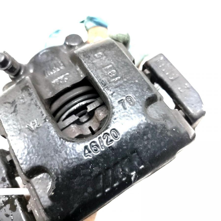

    Awesome stuff, yeah that was the one thing I was looking at in pics to compare the two caliper types, the thinner looking seal on the ZCP/Z4M's bigger diameter 46mm piston. The seal looks thinner and closer to the caliper housing bore compared to the double lip look of the standard 42mm pistons, so thanks for confirming that! I am actually looking to rebuild a spare reman front brake caliper with new ATE seals as a project, so I will def hit you up if I run into any issues with that.
    I'm convinced these eBay rear brakes I received are from a standard E46 M3 and a previous owner of them just did a good gloss black paint job. Dunno how the seller mixed them up as being E86 Z4M ones, but they seem to be a big junkyard business account so happens I guess. (pics attached from the ebay listing)

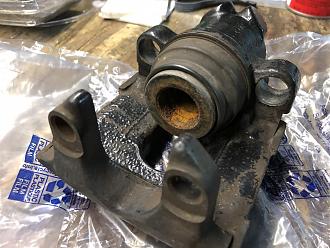

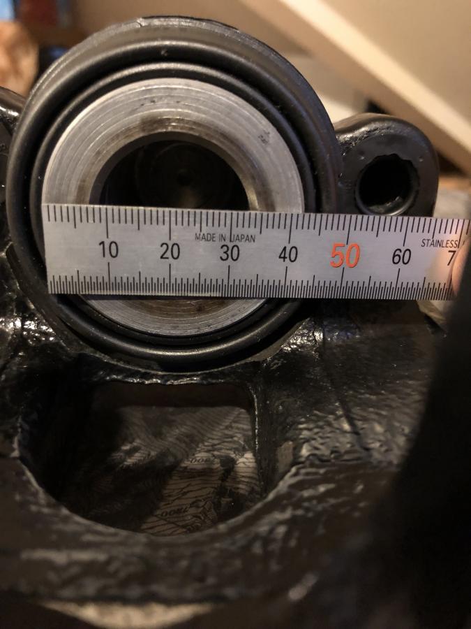

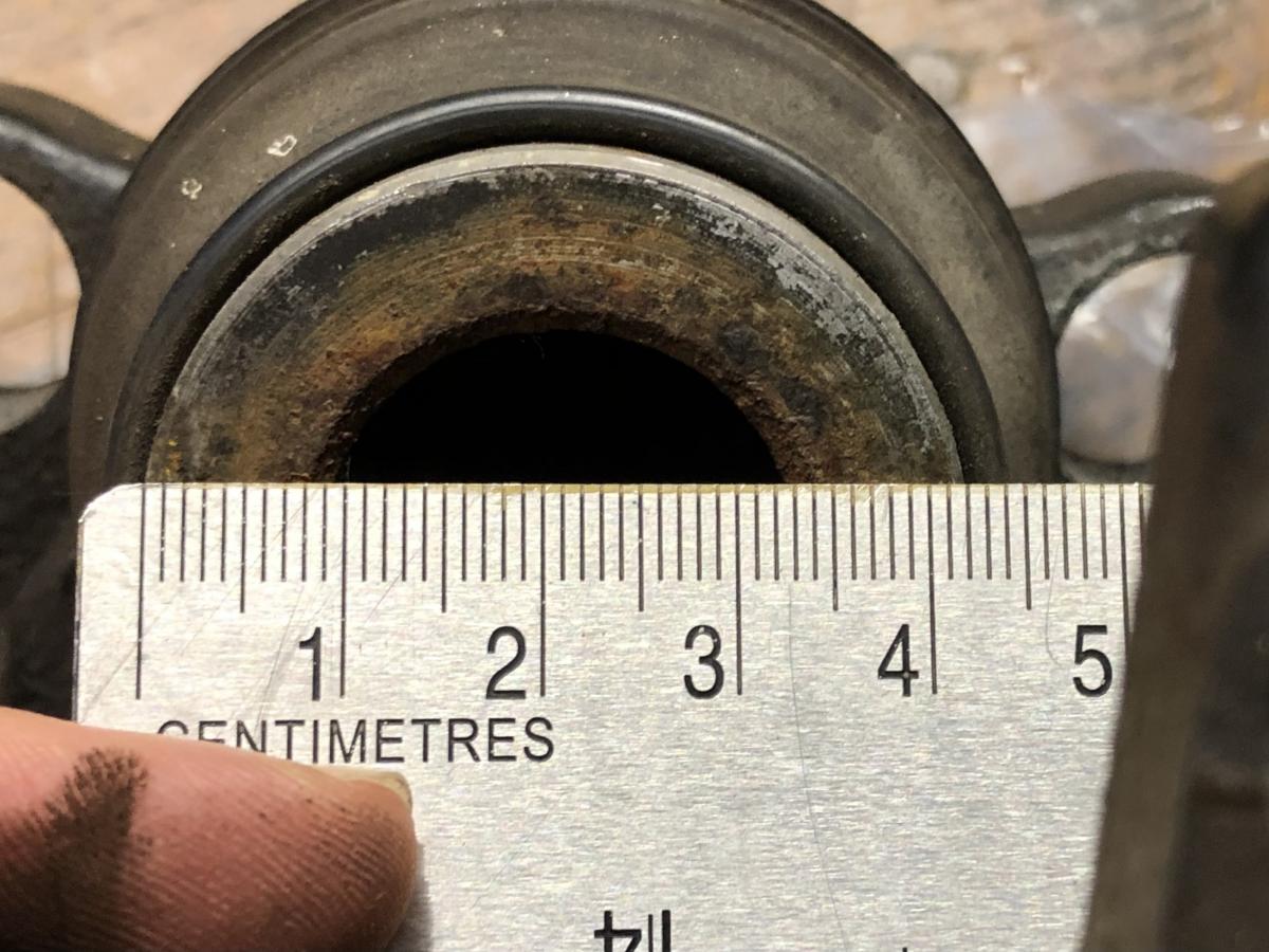

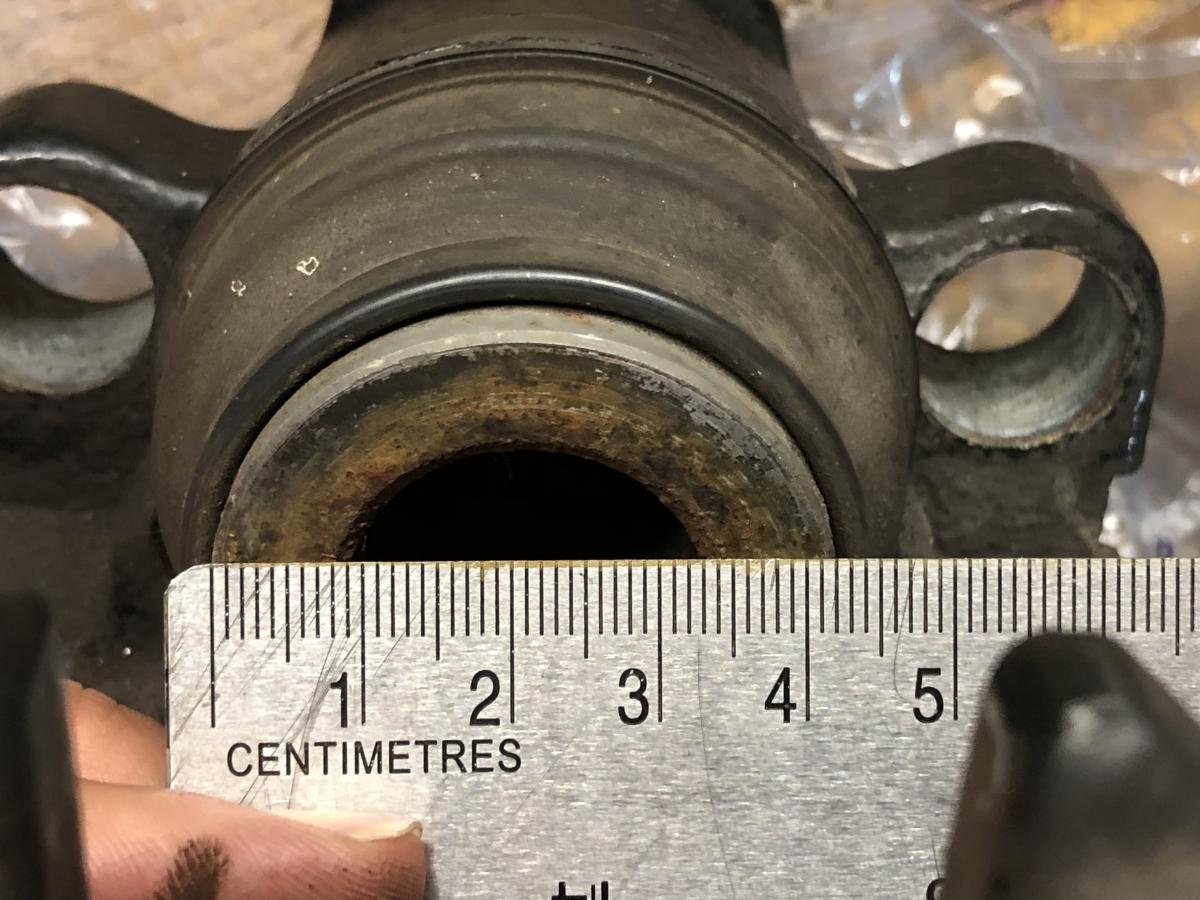

    Following up on this, as I got another pair of Z4M rear brakes after returning that first pair from eBay.. and I'm wondering if there is misinformation or am I a dummy who isn't measuring the piston size correctly? Am i wrong to measure the piston face and the 4mm increase in piston size from 42mm to 46mm is behind the dust seals?
    This new pair I bought on Zpost forum from a part out sale thread of a 2006 Z4M, so theres no doubt they're truly Z4M rear brakes, they have the bigger wrap over dust seals too along w being powdercoated black.. but the pistons again measure 42mm instead of 46mm at the face

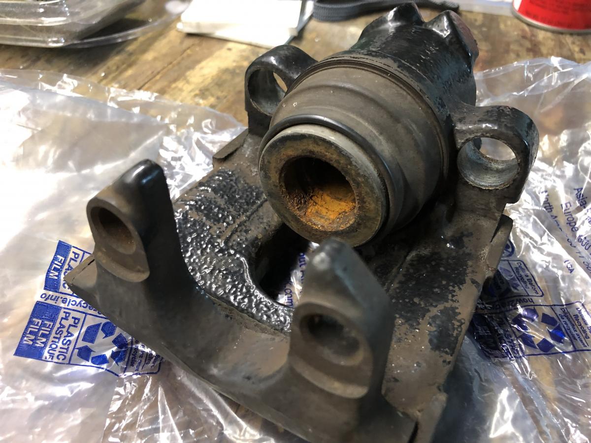

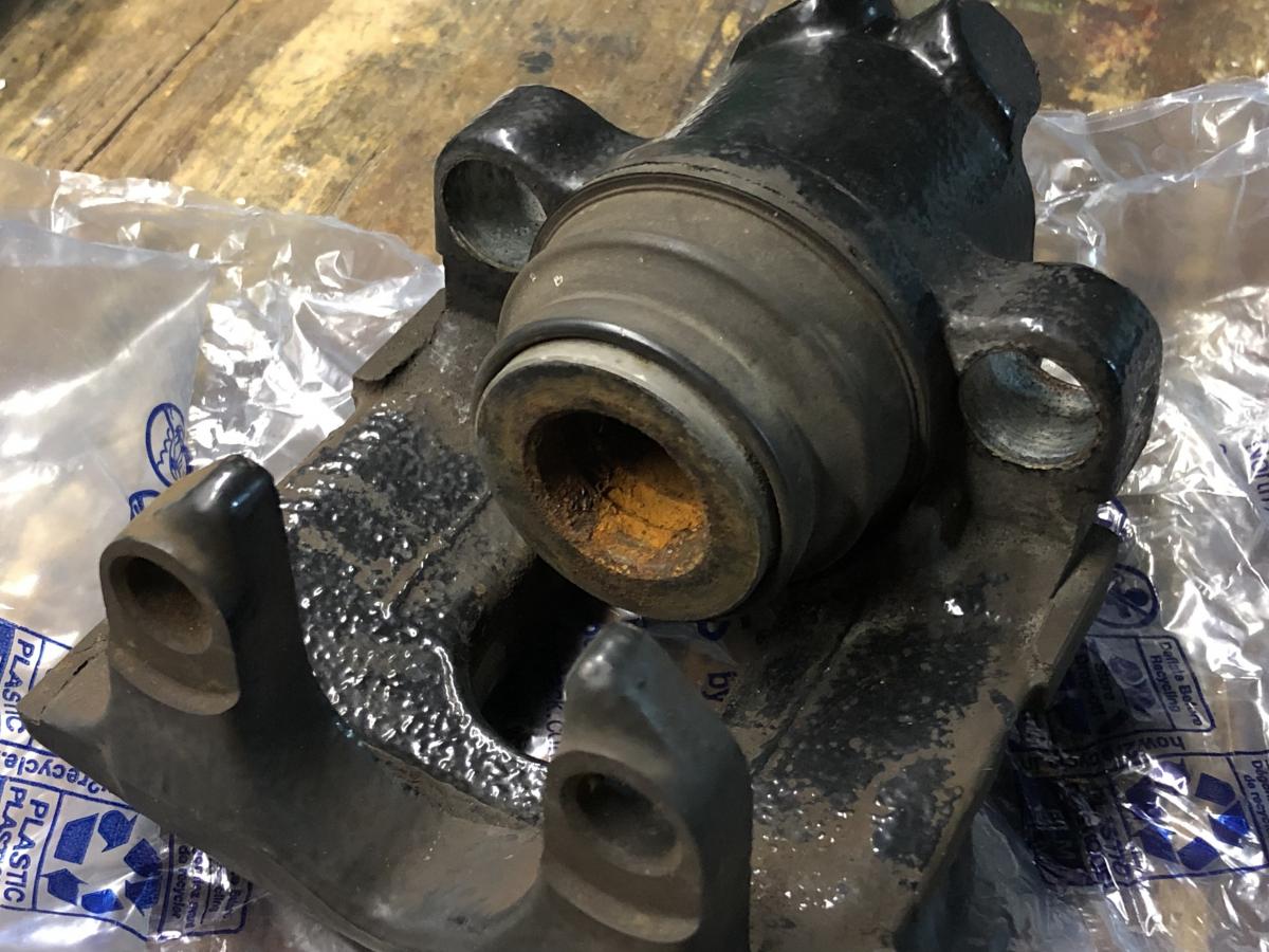

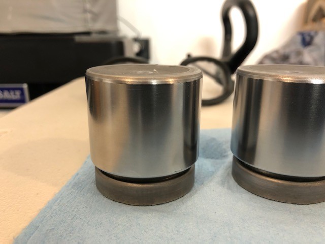

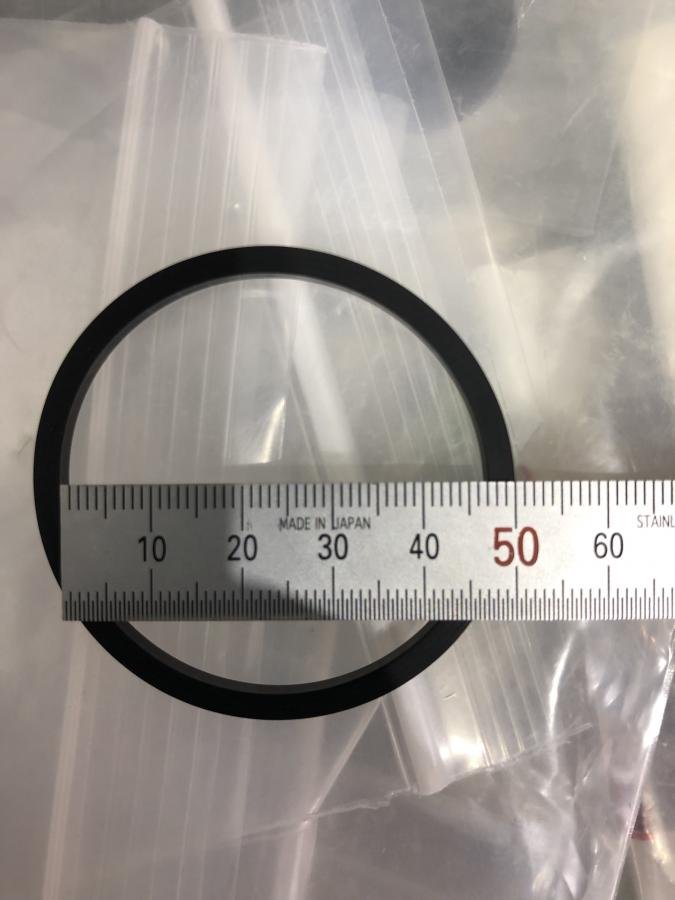

      EDIT: I pulled some photos of my pistons when I cleaned them as part of my rebuild, and the piston is larger further back than where you are measuring. Mine too measure 42mm at the face and the old seals I pulled measure on the order of 46mm (hard to get them perfectly round to measure).
          You need to use a pair of calipers and measure the diameter of the actual piston body.
            Great, thanks again for confirming and the info! Now I can go ahead and clean these up without worrying I'm wasting my time cleaning the wrong brakes again haha. I guess it makes sense they use the same piston face as the standard non-ZCP brakes since they both use the same brake pads (good on BMW to not complicate things there).

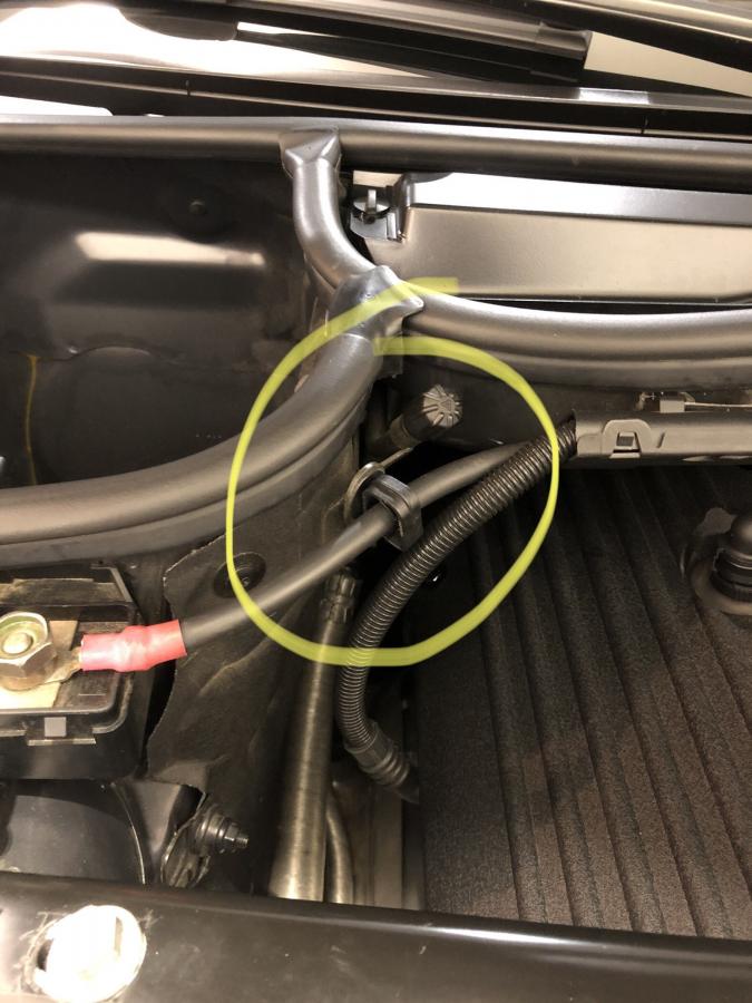

                        Need some assistance confirming P/N for the clip in the engine bay holding the battery cable in place (see photo). I *think* it's 61138350836 but can't seem to positively nail this one down using RealOEM. BTW--should we have a thread dedicated to "I can't find P/N"? Might be useful ? Thanks!
                          Yeah 61138350836: https://www.fcpeuro.com/products/bmw...ip-61138350836
