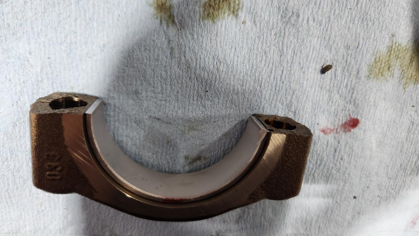

      Also, another question, I noticed that on cylinder 5 the bearing doesn't want to sit totally flush on the cap, notice the small gap on the RH side. I tried two different new bearings with the same result.
      The original bearing seems to have a very small gap as well but it's only maybe 1/3rd the size of gap as the new OEM bearings.

        The rods are fracture cracked, so the surface will not be perfectly even side to side. Get the bearing seated as close as possible and during install, the bearings will find their place and crush against each other.
