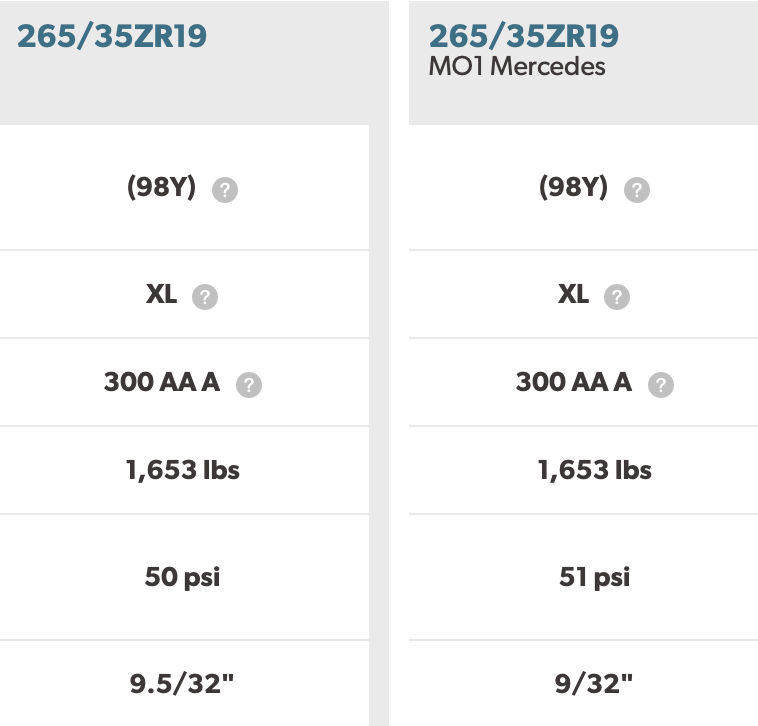

      You mean the Pilot Sport 4S, not the Pilot Sport 4, yeah?
      For the 4S, Tire Rack shows two variants in 265/35/19, and both are load rated 98Y XL. That means one tire is rated to carry ~half the weight of an E46 M3. I'm not an expert in this area but it'd blow my mind if that weren't enough. When I plug in an E46 M3 into their selector, they show tires rated at least as low as 89Y SL...

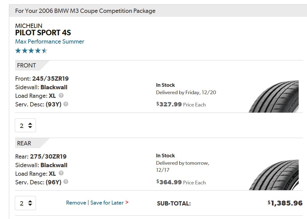

        Thank you! I just entered the car information, but I'm not seeing 265 as an option—only 275. I selected varient tire size options and got 245/275 combo from the workflow. How are you finding the 265 specs? I selected the 06 comp since I'm installing ZCP Comp wheels. Would you mind sending me a screenshot of the tire specs you're seeing for the 235/265 combo that many people recommend?
        Also, while we're on the topic, what are the pros and cons of running 245/275 vs. 235/265? I know the 235/265 is the OE spec, but I'd prefer to run a wider tire and a smaller spacer to fine-tune my fitment.
          I was just going by the 265/35/19 size you posted. I searched by brand and looked for that size. Can't really speak to what's recommended for this vehicle, unfortunately.
          What are the full tire sizes for each option?

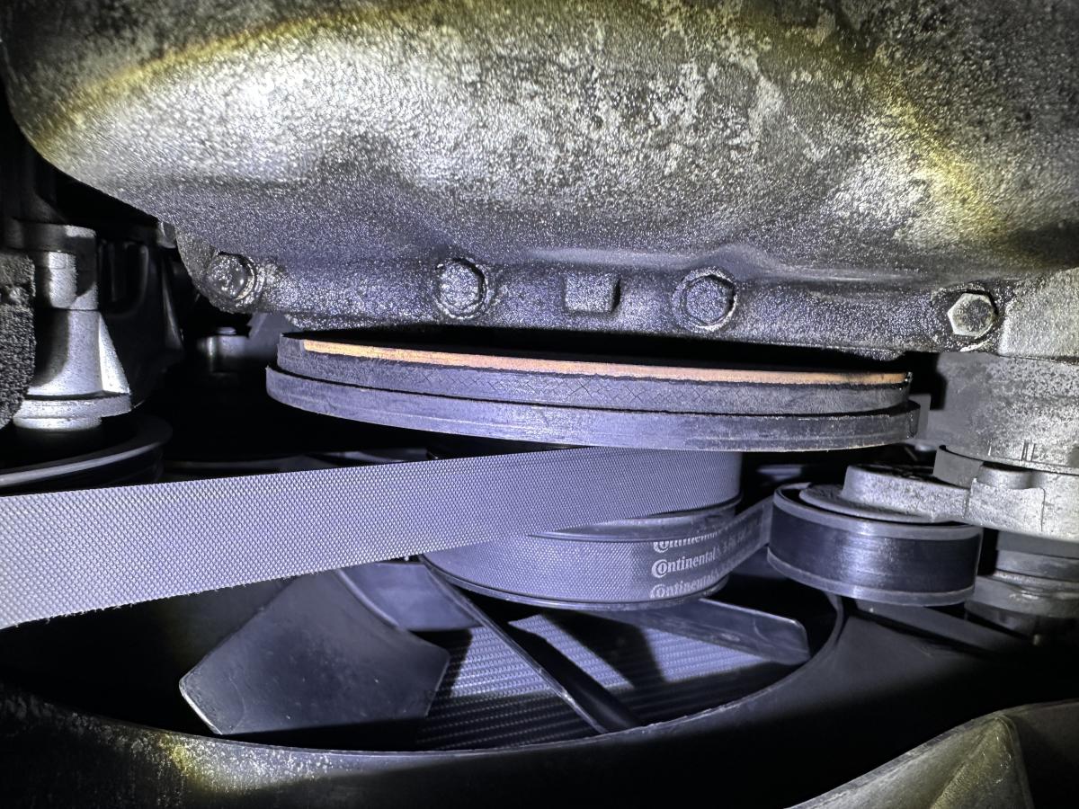

                              Yall think this is an issue… missing bits on the crank hub.
                              the orange is where the rubberized coating has come off.
